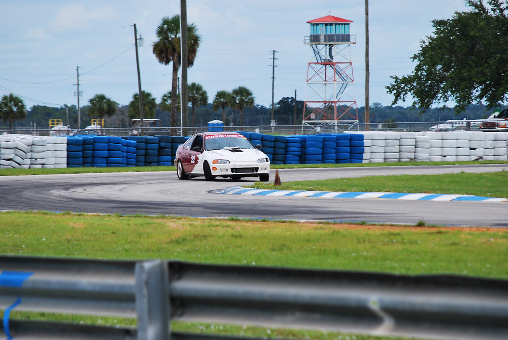

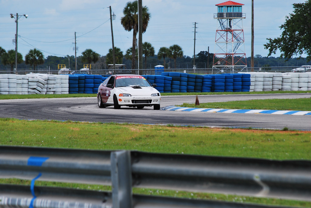

If you do decide to get a sway bar(s) I would just get a rear bar. In all of my experience tracking and racing Cvics you don't need a larger front sway bar - a smaller one or none would be better. The beauty of FWD is if you have oversteer from the rear you point the wheel where you want to go and stomp on the gas and it corrects itself unless you are going insanely fast.
I disconnected the front sway bar on my 95 for this track day and it was a blast to drive but after 2 sessions like that I connected it back because the track had no grip and it was getting scary going into the carousel at Sebring. But shows you what a large rear bar does to counteract the natural understeer of Civics.
