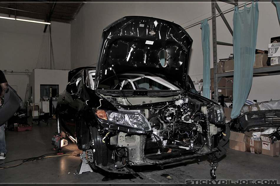

This is the state in which the 2012 Honda Civic was in at around 1am on October 20th, 2011…The only visually complete items on the car were the Stop-Tech big brakes, cut-out hood, and full roll cage…

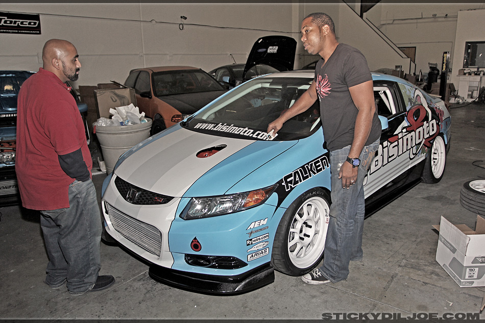

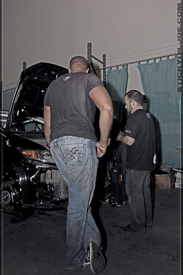

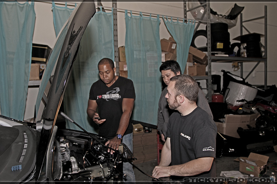

Bisi Ezerioha, Supertwinz John from AEM, and Ryan Basseri going over some ideas for the engine bay…

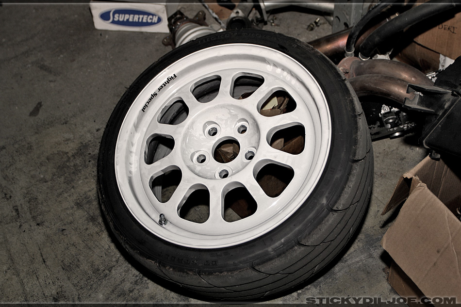

I was thinking that Bisi would go with his signature Bisimoto Fighter Special wheel since a couple of them were either mounted on the car or around it, but that wasn’t the case because he had a new wheel to debut on the Civic…
At this point, the exterior was still basically stock, other than the cut-out on the hood…

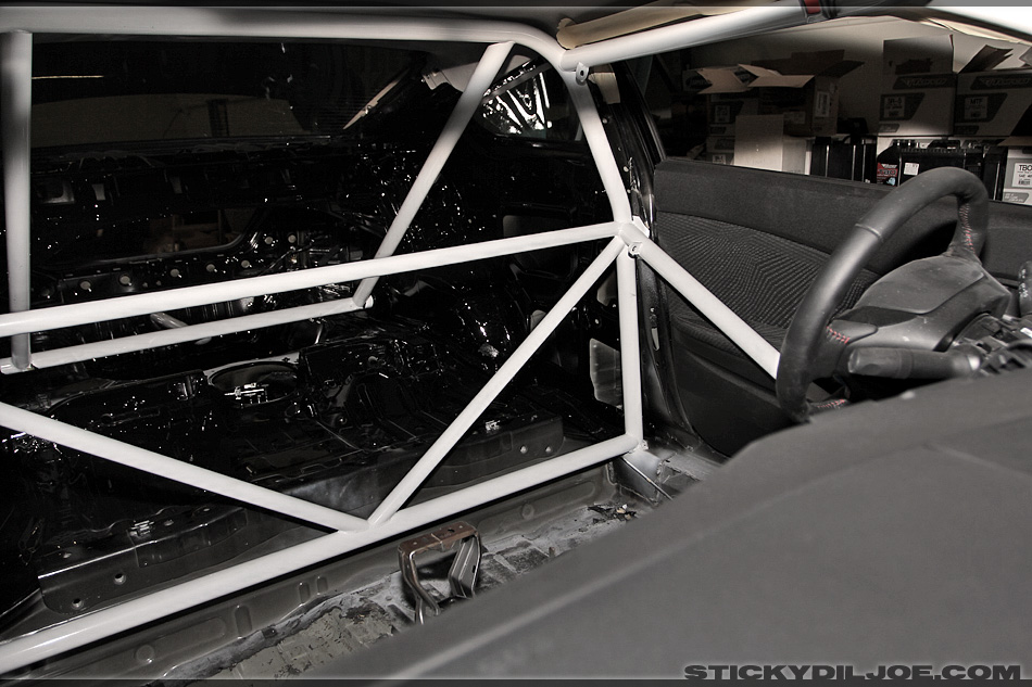

A look at the cage that was built by Steen Chassis…

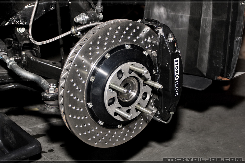

Stop-Tech big brake kit…a small wheel spacer was needed to clear the caliper…

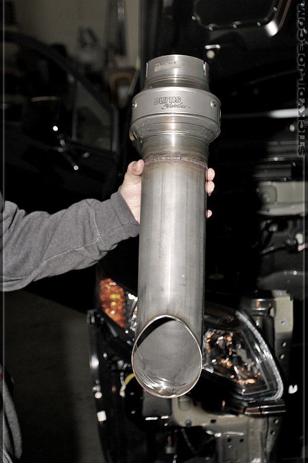

Supertwinz John holding up the Burns Stainless short muffler that will eventually go on the Civic…

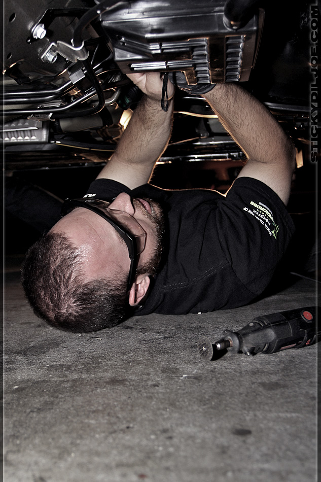

Ryan under the car working on the custom lines for the rear brakes…

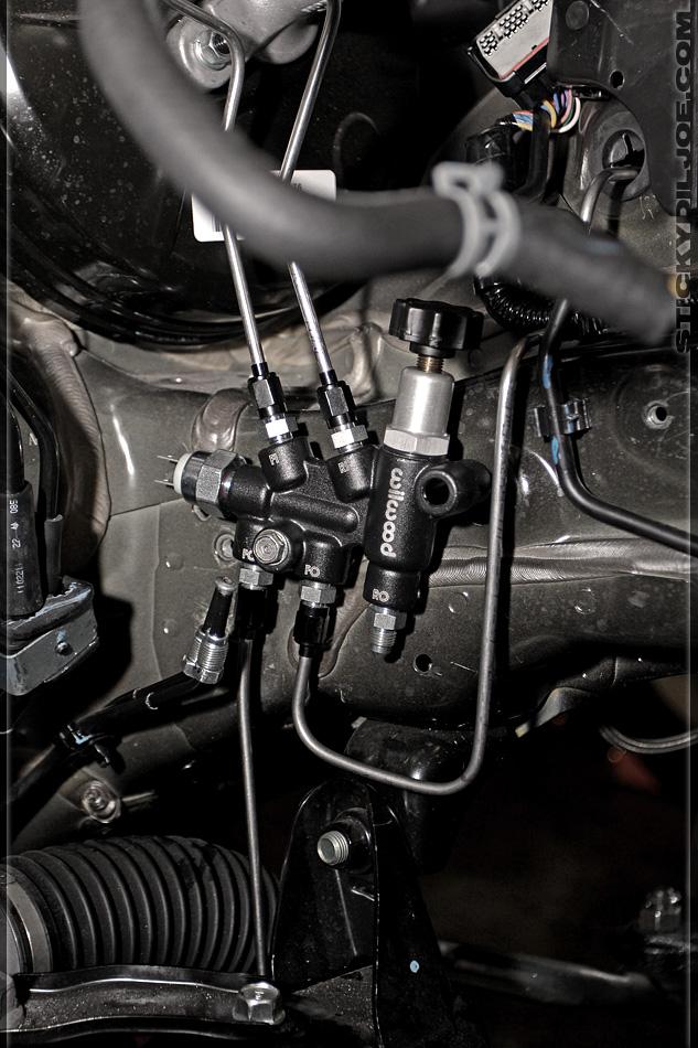

The lines running to a Wilwood proportioning valve…

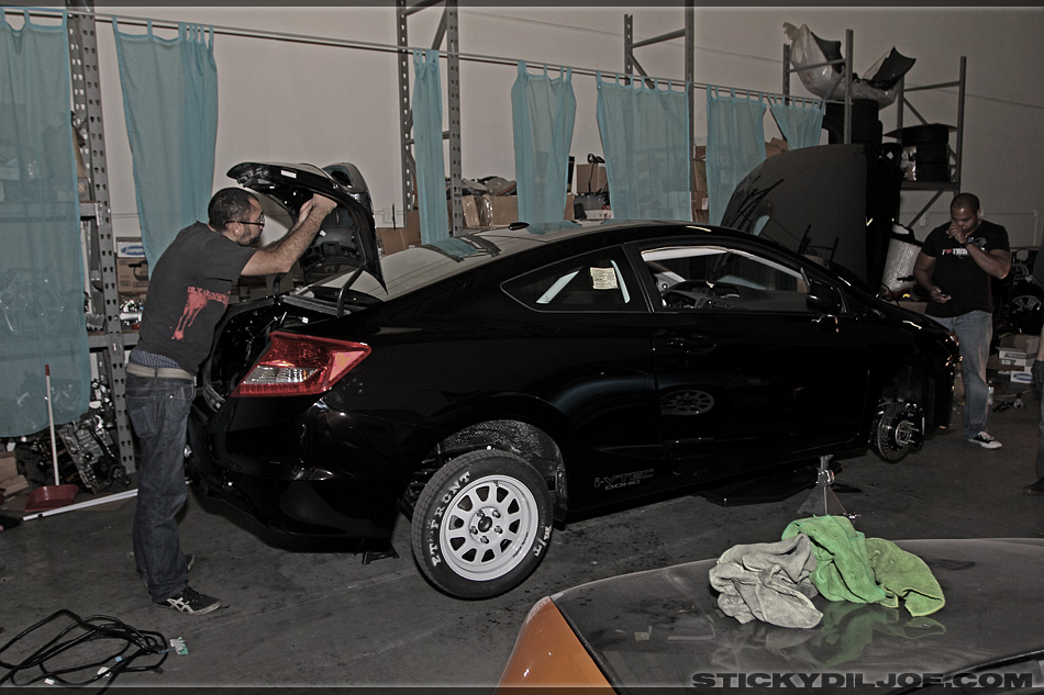

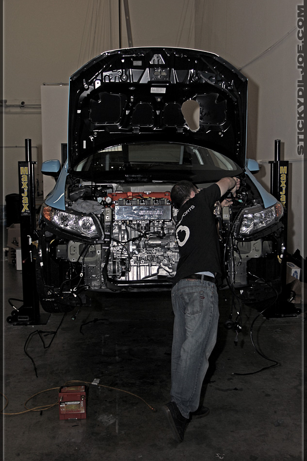

This next batch of photos were captured 3 days later. By this point, the motor had gone back into the car, the vehicle wrap was complete, and re-assembly had begun…

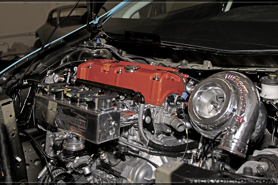

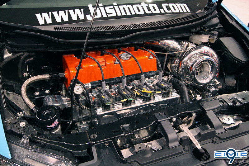

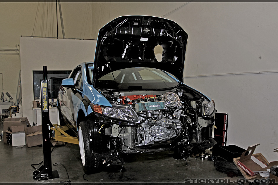

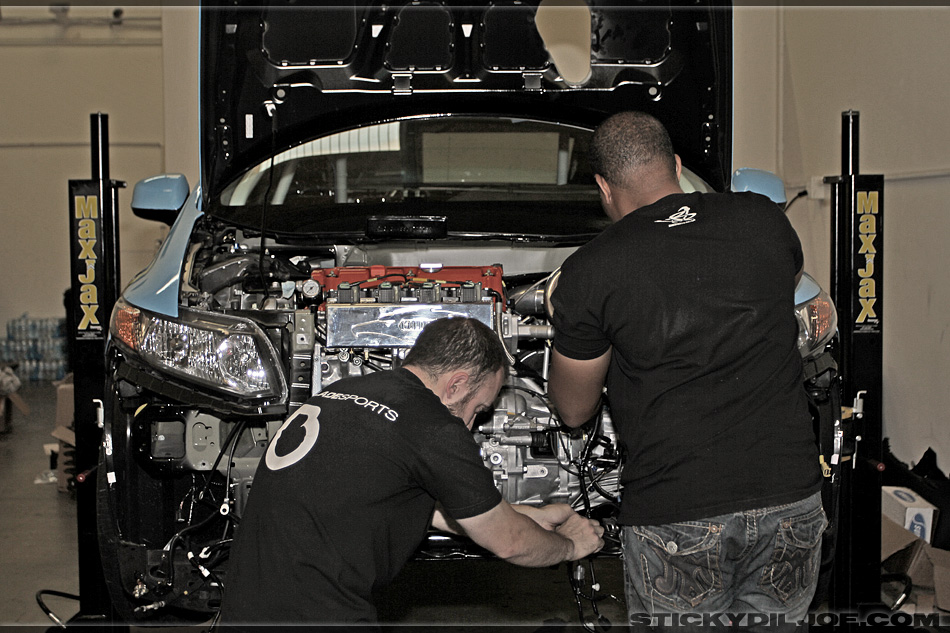

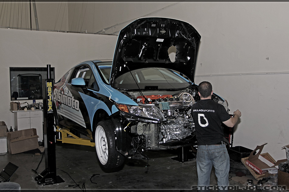

First look at the K24A7 since going back into the coupe…

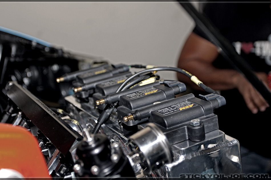

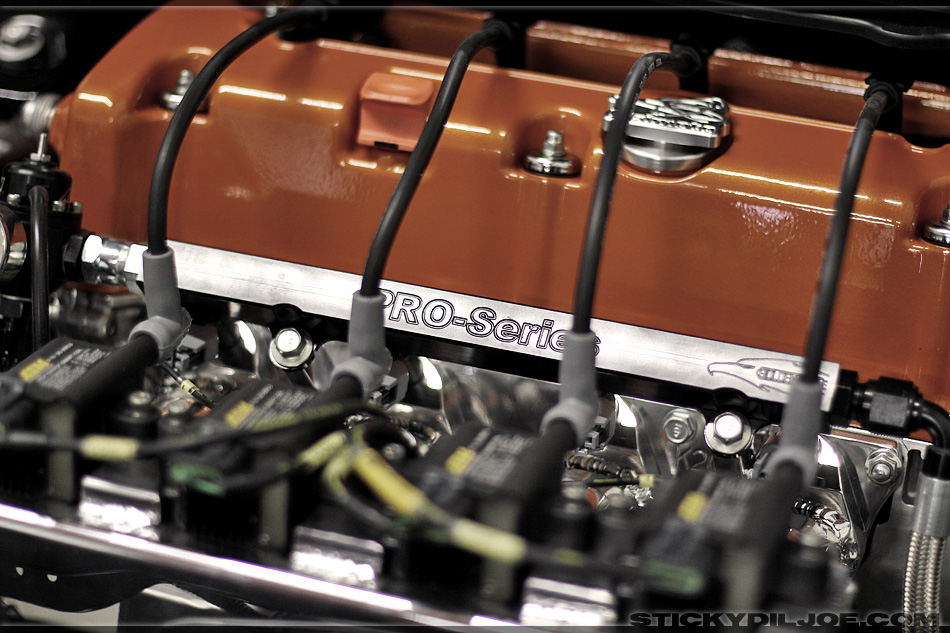

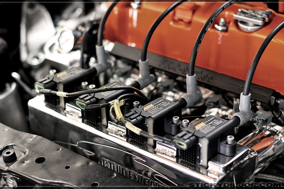

One of the most noticeable additions that I spotted right away were the AEM High Output Ignition Coils….Definitely didn’t expect Bisi to go back to using a more conventional, external coil over the O.E. coil-over-plug set-up…

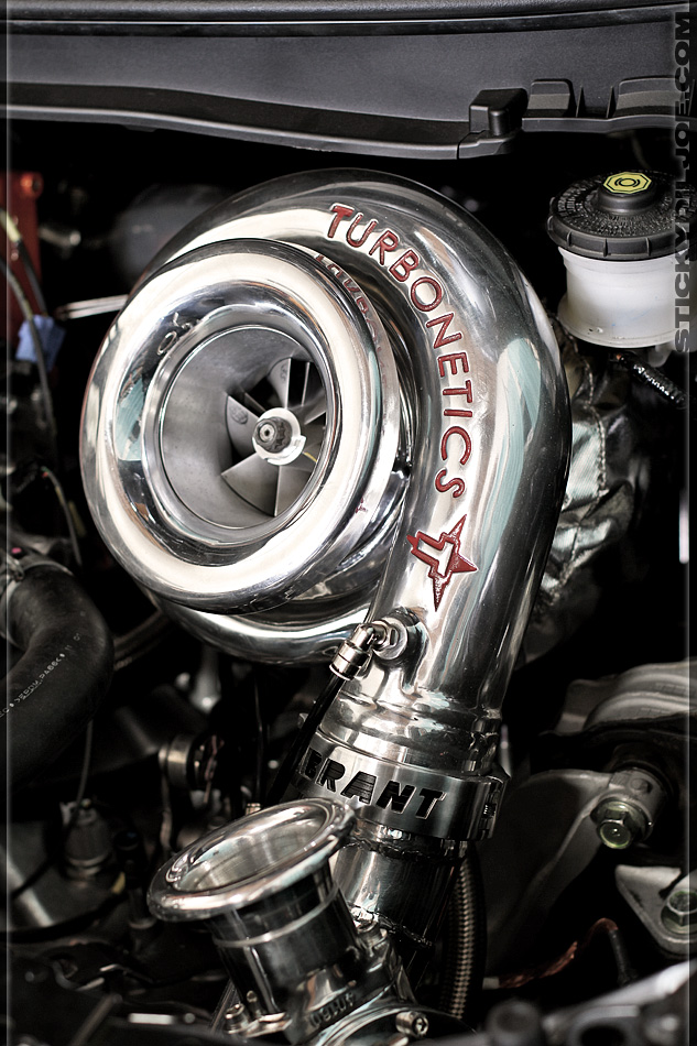

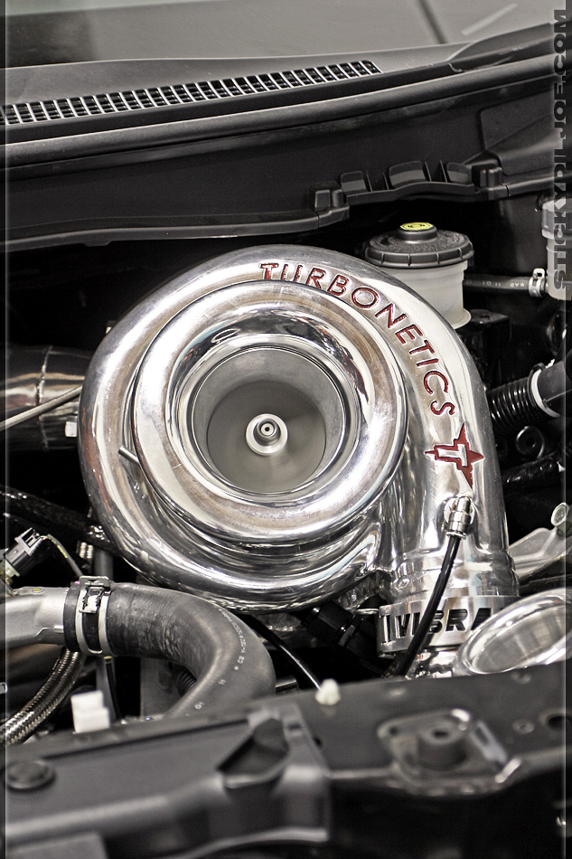

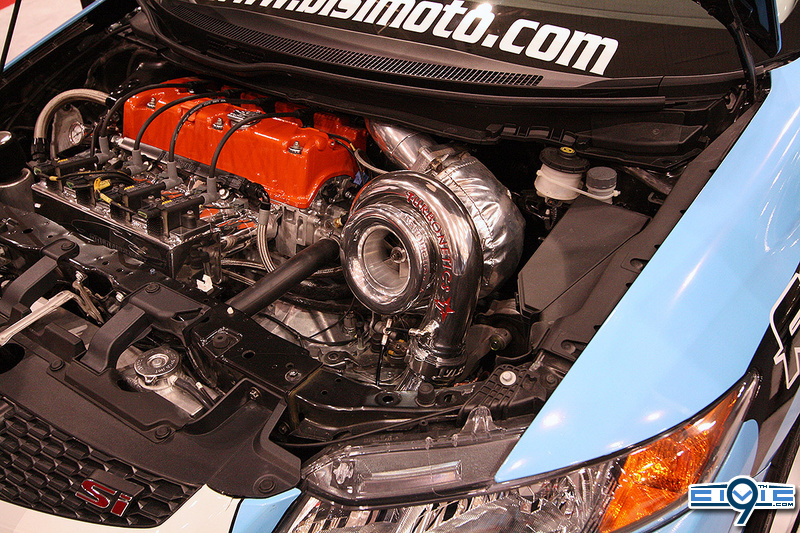

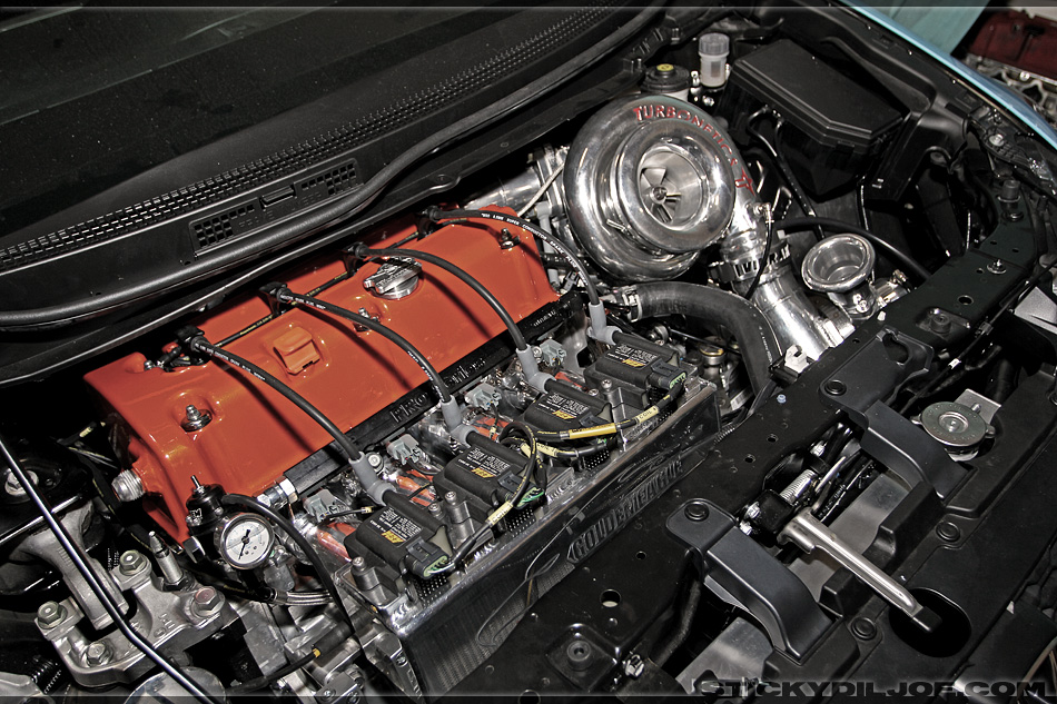

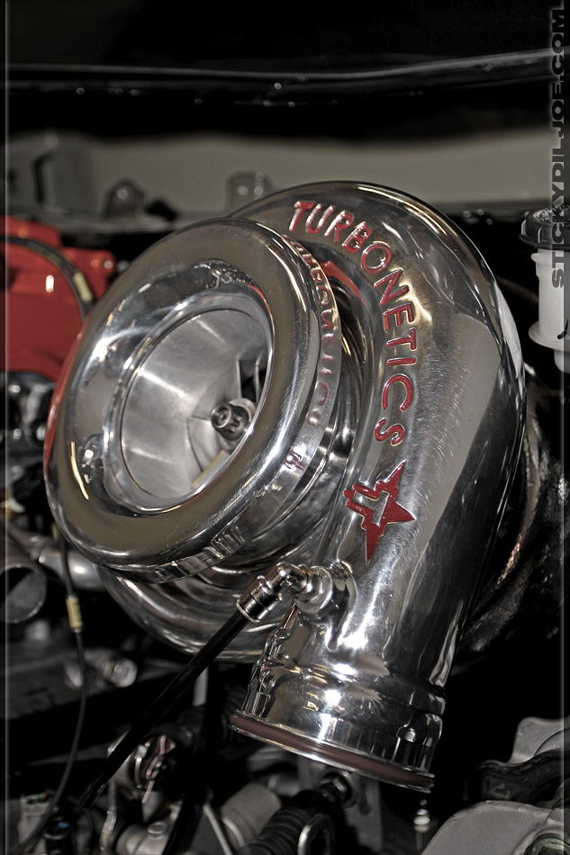

I did however, expect to see this massive Turbonetics turbo…

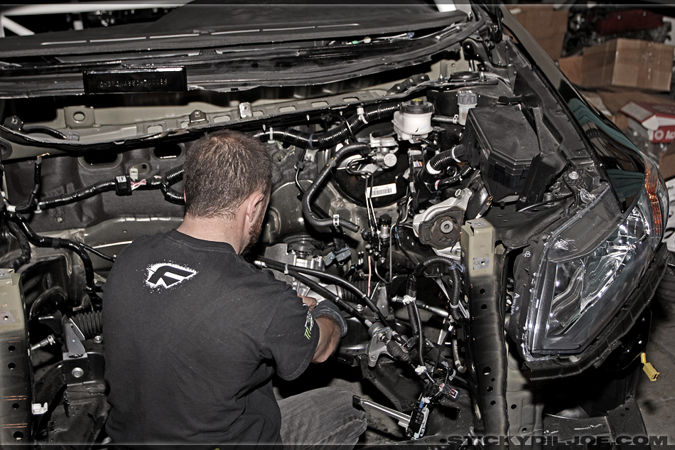

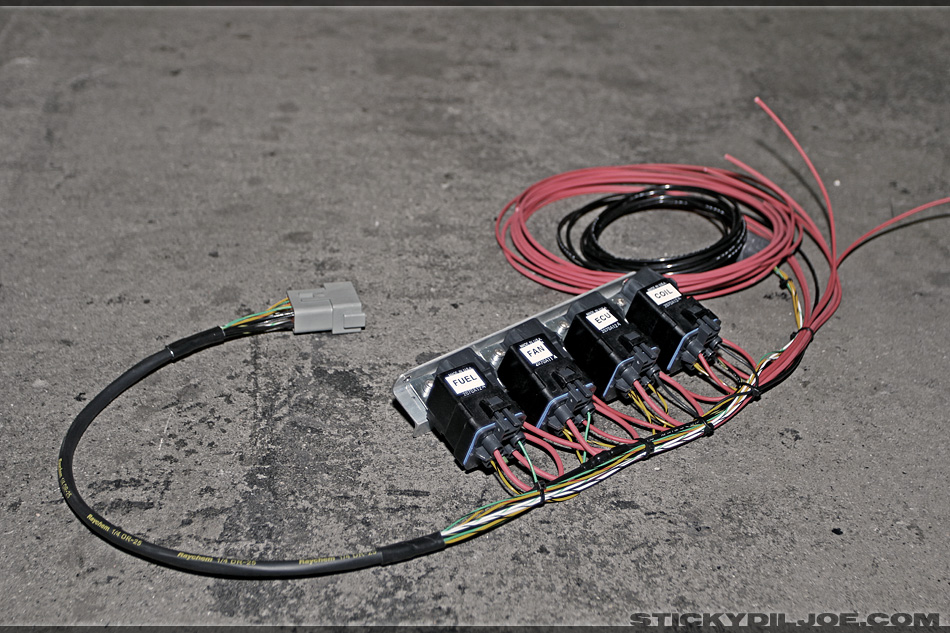

Custom relay and harness set-up built from scratch by Rywire…
Cool little addition that Bisi had found off of an airplane…I forget what it’s used for now but Ryan actually rewired this thing and made it functional…
Ryan working on the fuse box….

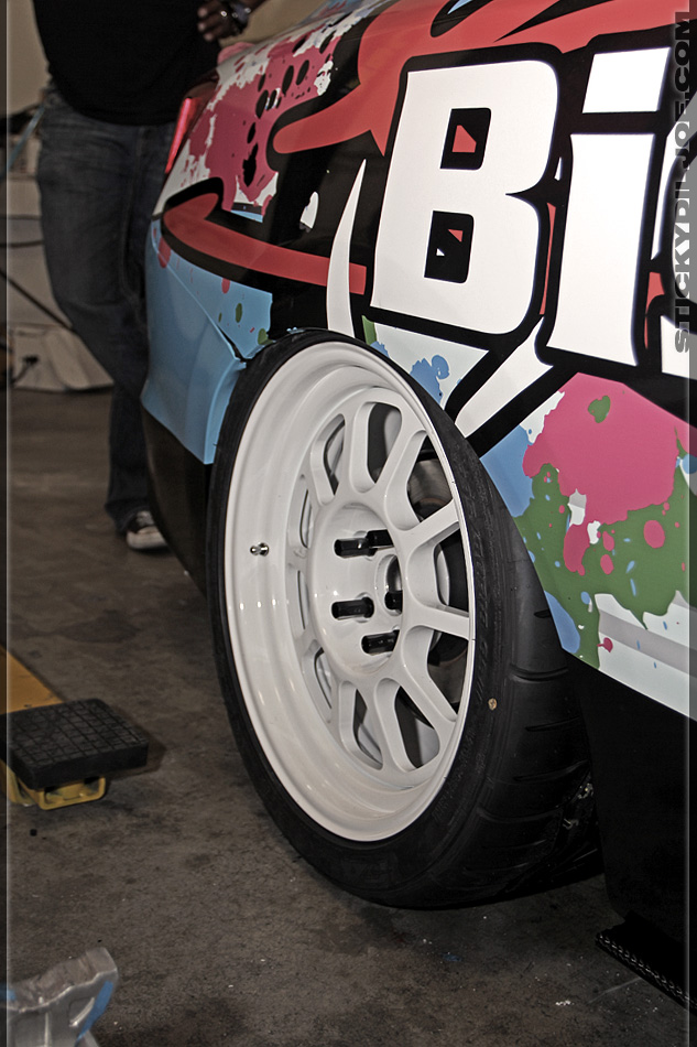

Your first look at the graphical livery and vinyl wrap layout. You can see here that the chute has been installed and the new wheels mounted…
How the engine bay looked before the radiator support and everything was reinstalled…

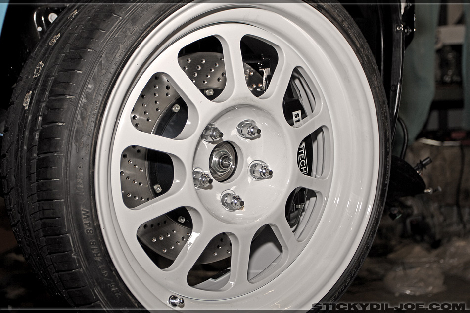

Your first look at the Bisimoto “Eins Gramm” wheel…

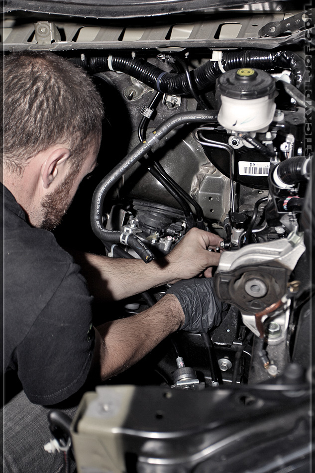

Ryan and Bisi working on the engine harness…

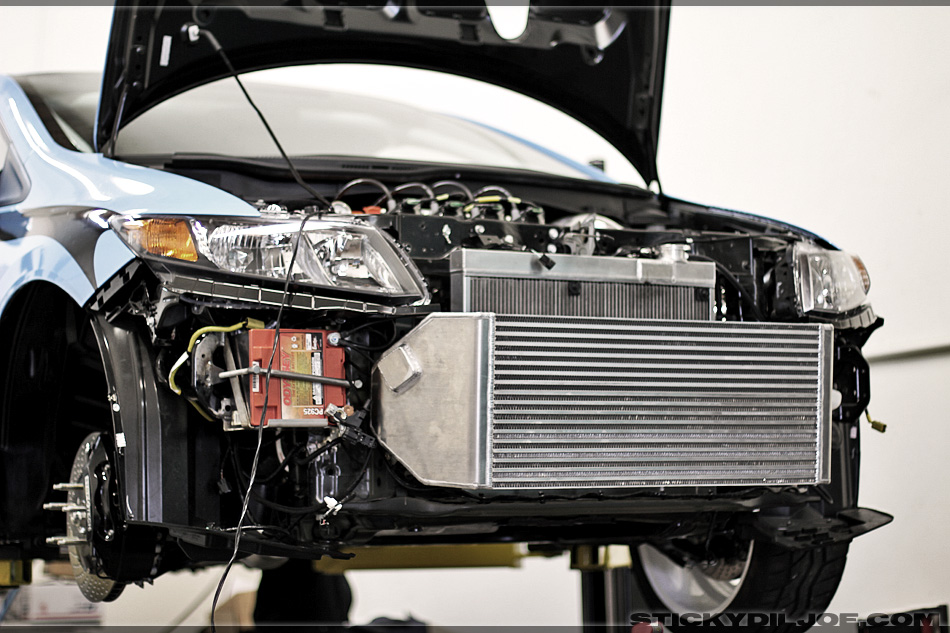

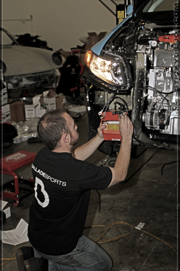

Ryan installing the Odyssey battery beneath the headlight…
The K24A7 engine coming together…

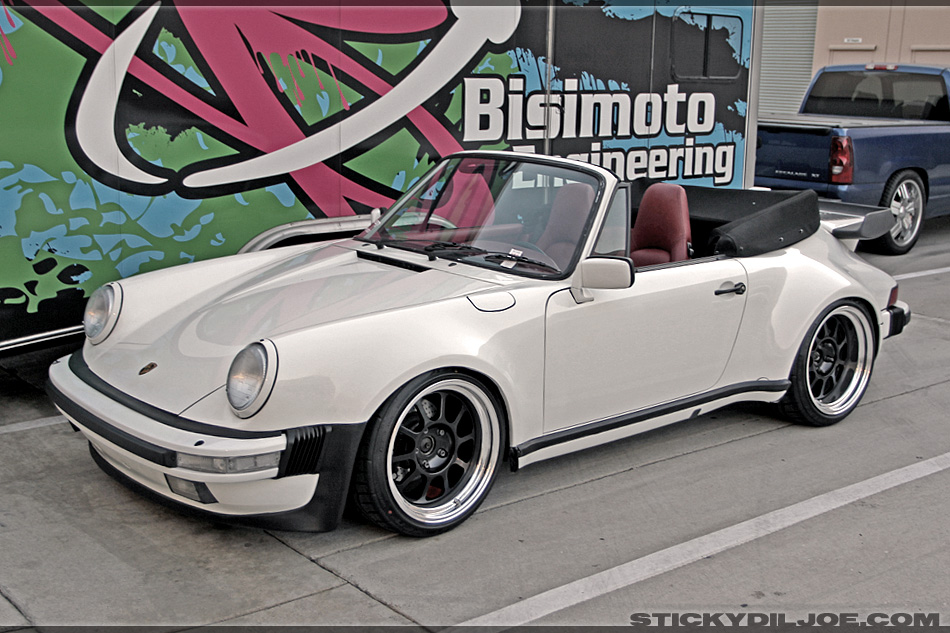

Random shot of one of Bisi’s Porsche projects sitting outside next to his trailer…

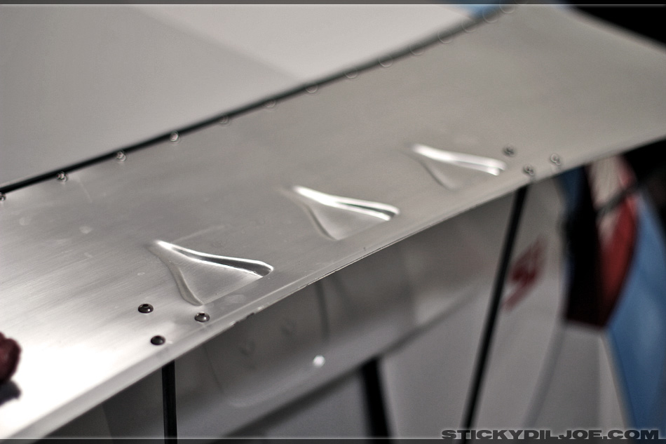

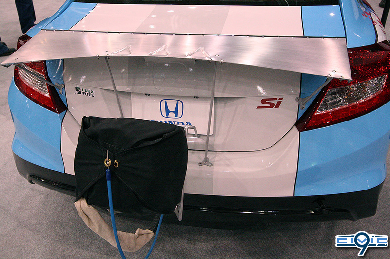

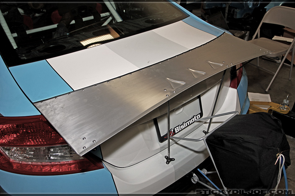

In the days that I was away, the car was actually sent out to Bisi’s fabricators for more stuff, including this custom rear wing…

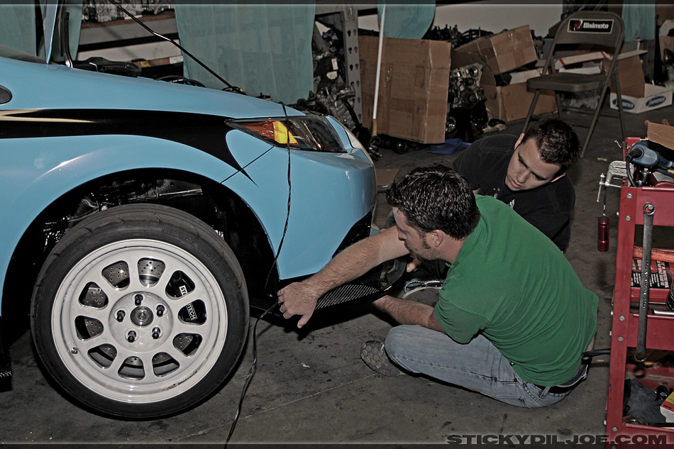

Guys from Extreme Dimensions installing the carbon fiber half-splitter pieces/canards or whatever you call those things…

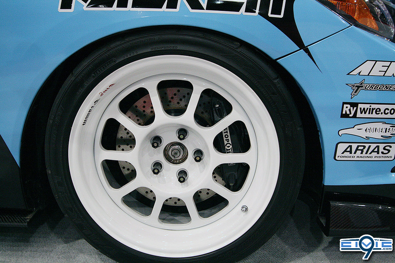

I forget the exact specs on the wheels right now, but I’m sure wheel fitment and “stance” guys will appreciate it. I think this had to be the first time where Bisi ever had to worry about wheel fitment. There are only so many suspension components out for the 2012 Civics at this point so messing with the camber adjustments and what not was definitely interesting…We eventually where able to get the wheels to fit without that little area of the rear bumper being pushed out slightly…

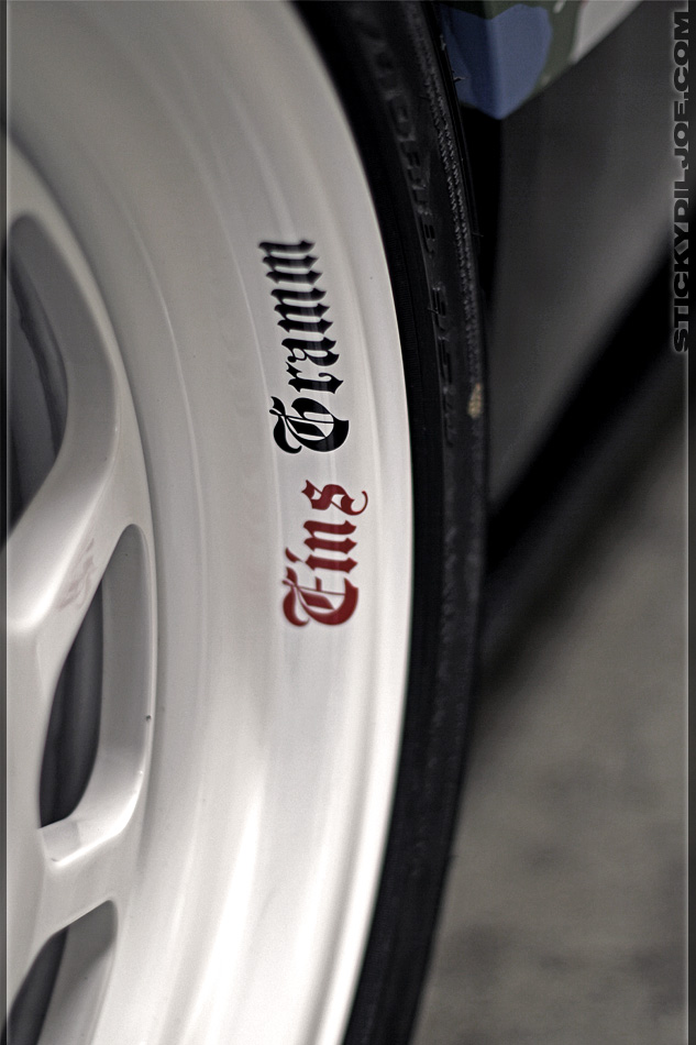

The “Eins Gramm” logo on the wheel which means, easily enough, “One Gram”…

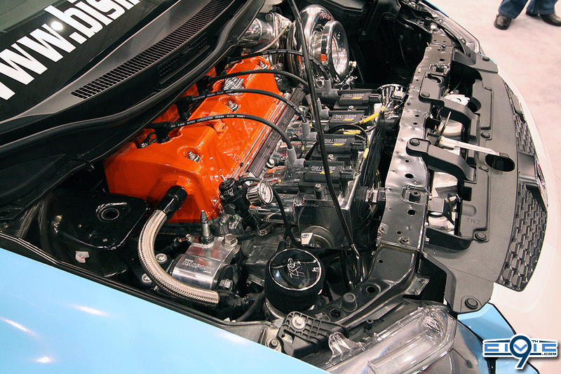

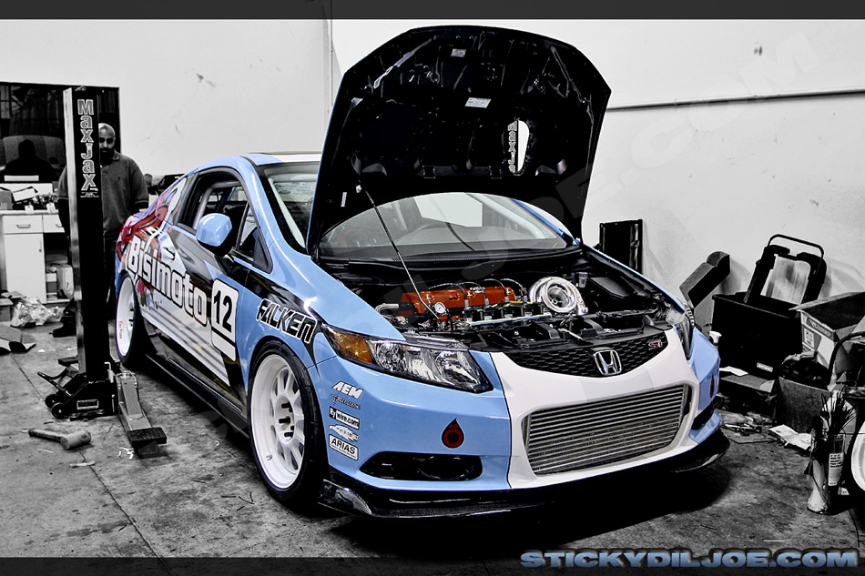

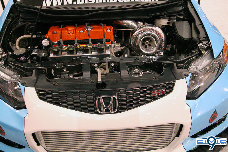

The engine bay with the radiator, core support, and front mount intercooler re-installed…

A closer look at the custom vents on his drag wing…

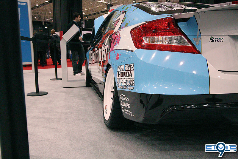

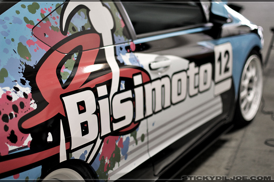

Bisimoto-themed custom graphical livery…

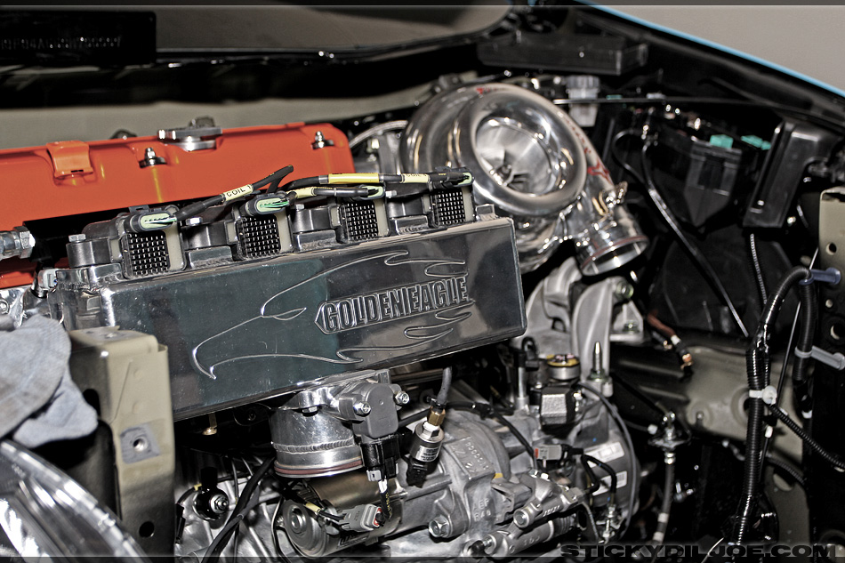

Better look at the AEM High Voltage “Smart” ignition coils mounted to a plate on the Golden Eagle intake manifold…
The massive Turbonetics turbocharger…

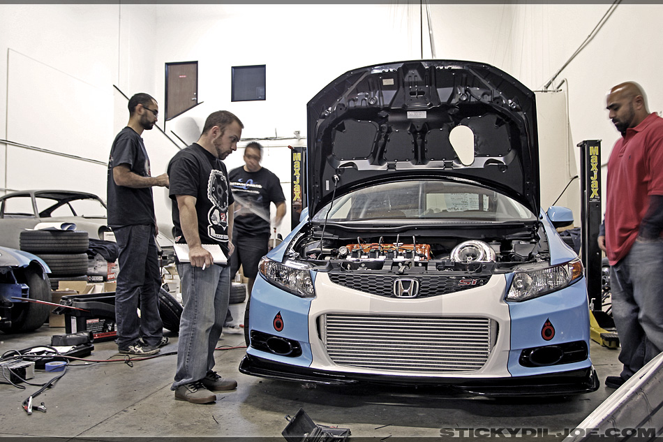

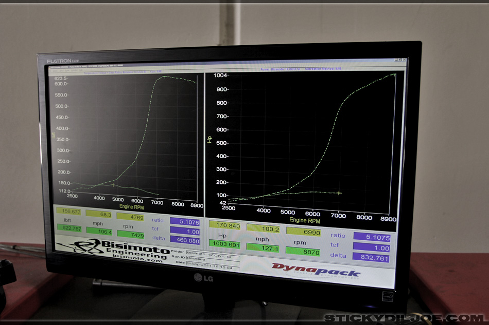

Okay, so speaking of the giant turbo, Bisi had tuned the K24A7 motor earlier on in the day and revealed to us the final numbers from his tune…
There were still some very minor issues that will need to be resolved once SEMA comes to a conclusion but your eyes aren’t deceiving you…the Bisimoto Engineering 2012 Honda Civic produced 1004 horsepower and 623LB-Ft of torque… One-thousand and four horsepower K24!…

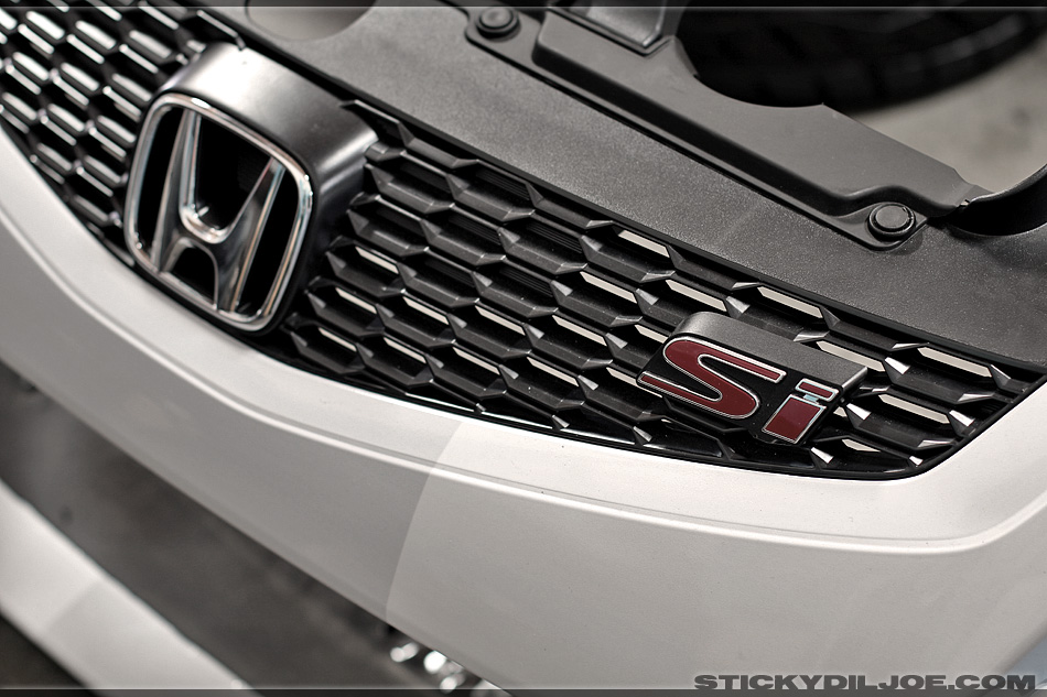

A shot of the front bumper…

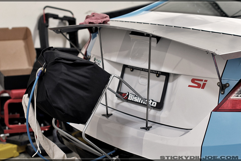

A shot of the rear of the Civic….

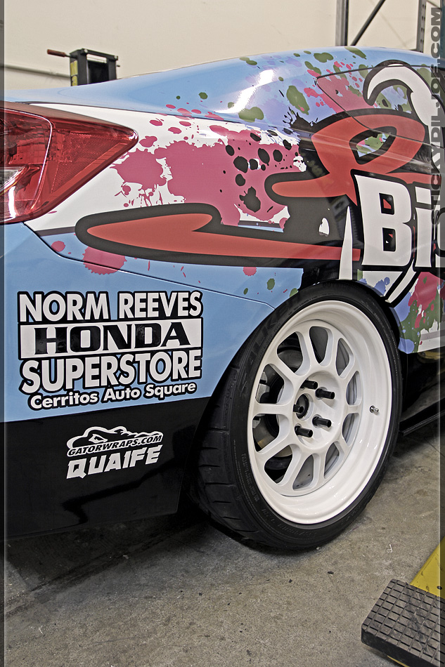

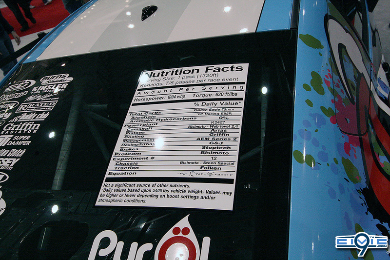

Bisi Ezerioha putting some of his vinyl decals on to support his many sponsors…

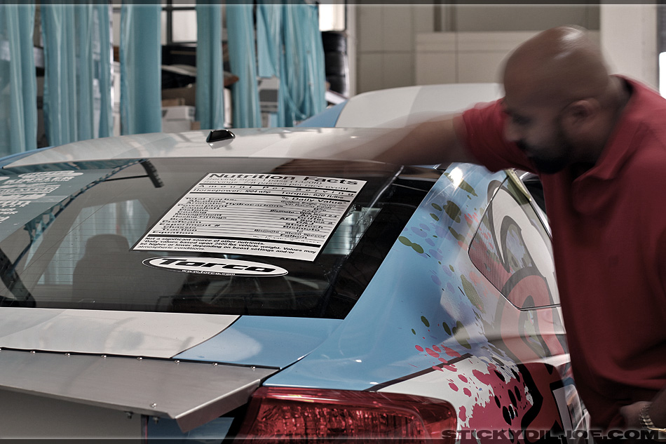

Big Mike helped with the rear window decals…

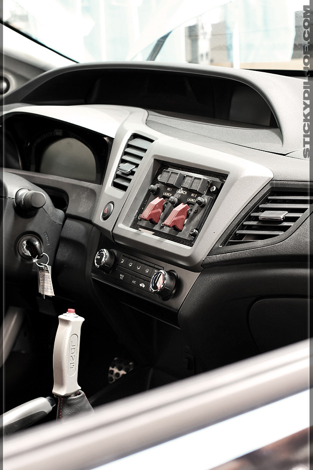

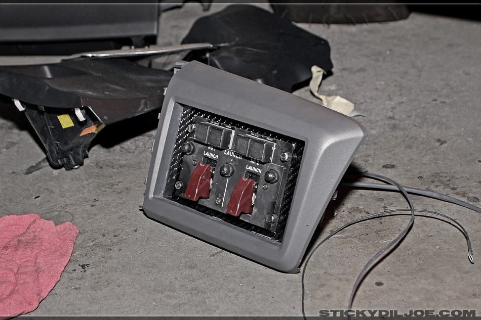

A shot of the cockpit with the custom airplane “launch” switches…

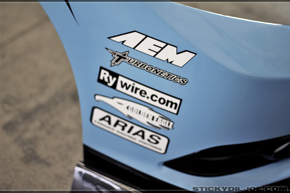

Corner of the front bumper featuring another batch of sponsors….

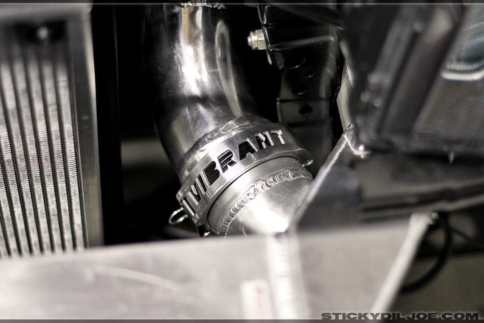

Vibrant Vanjen clamps…

The Turbonetics unit in motion…

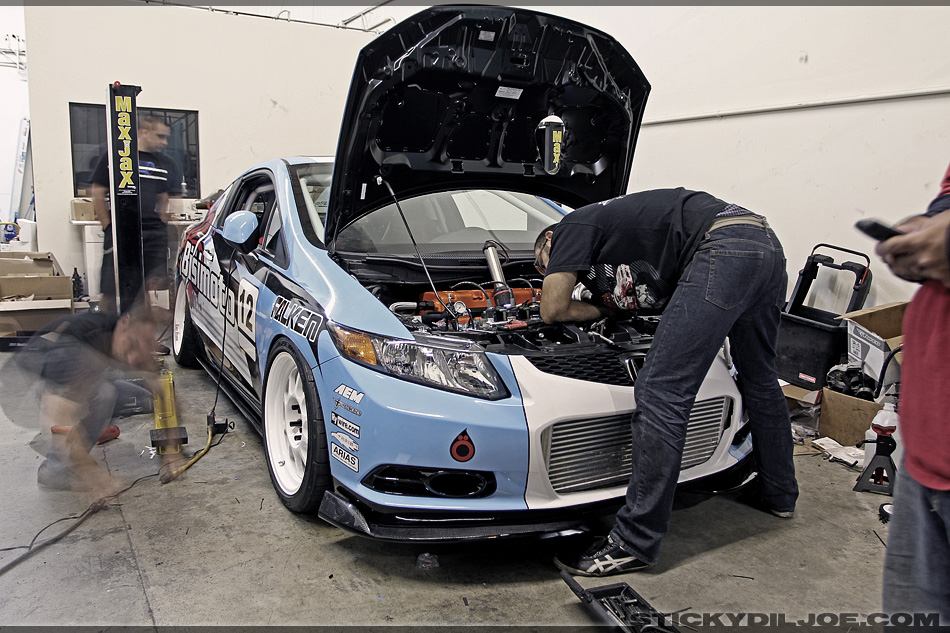

Ryan going over some last minute details in the bay…

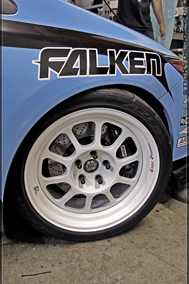

A final look at the Bisimoto Eins Gramm wheel on Falken Azenis…

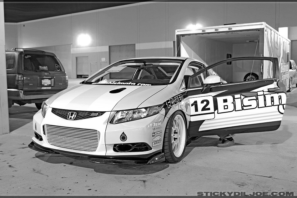

That’s a wrap…if you guys are going to be attending the SEMA 2011 show, make sure to stop by the Honda section and check out the 1000+ horsepower Bisimoto Engineering 2012 Honda Civic. Remember where you guys saw it first…. stickydiljoe.com!!!
I apologize for not being able to get better shots of the Civic outside of the facility, there just wasn’t any time. Below is a link to a larger sized photo so you can have a better view of what the car looks like…
