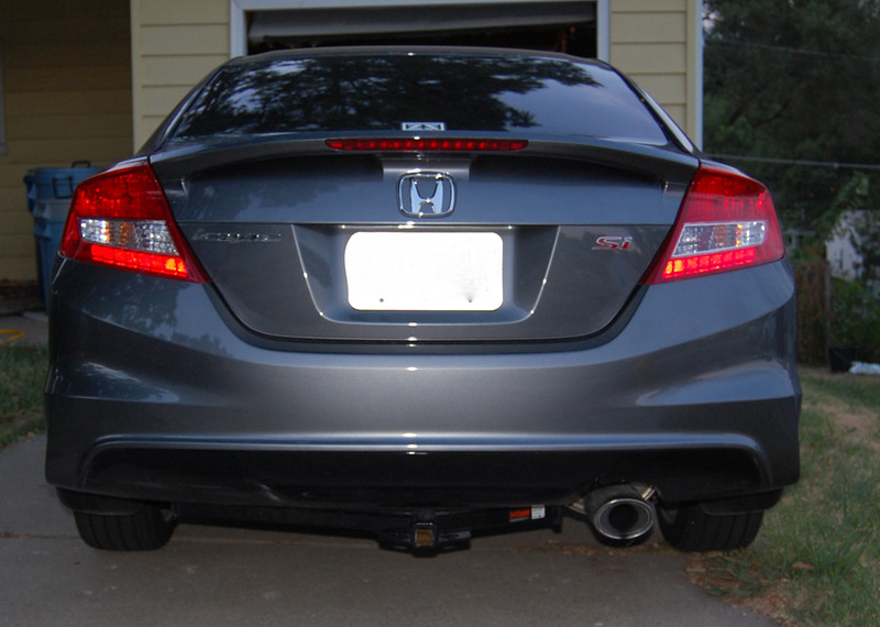

Last night I swapped out the stock sway bar and installed the trailer hitch. The sway bar install was super easy. The hitch install was more of a pain. I'm glad my brother came by to help, it was way easier with two people. Having to trim both the exhaust heat shield and the rear plastic air dam (or whatever it's called) on a brand new car was a bit concerting. But, everything went on and it fits well. I'll actually hook the jet ski up to it this weekend, I'll let you know how that goes.
