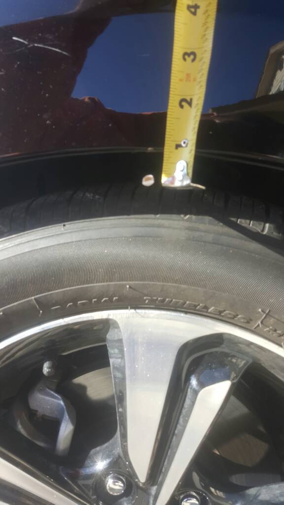

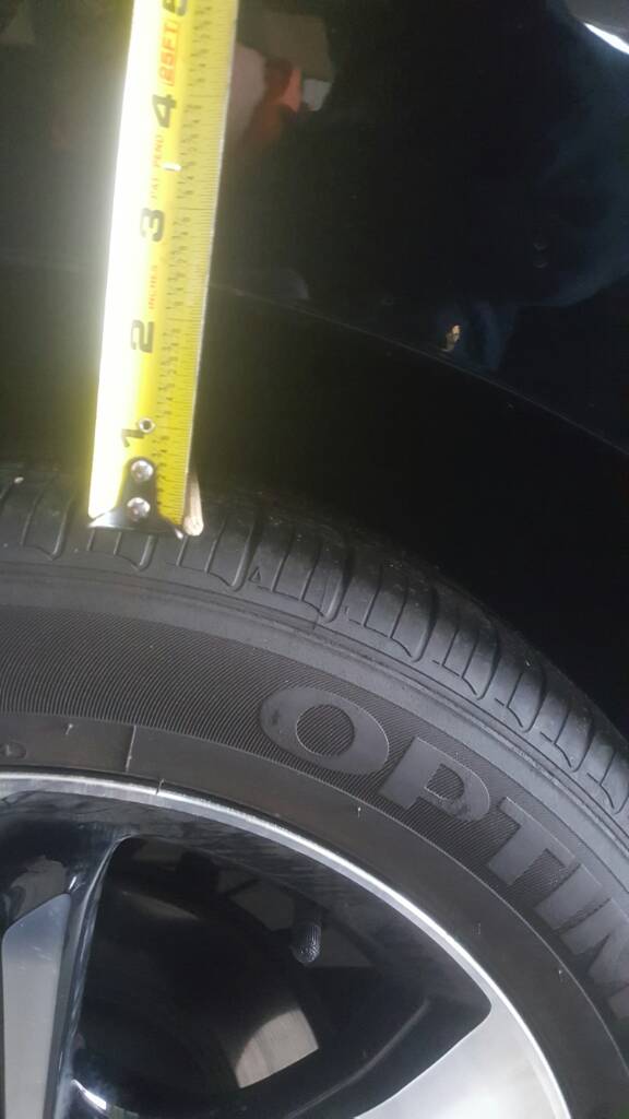

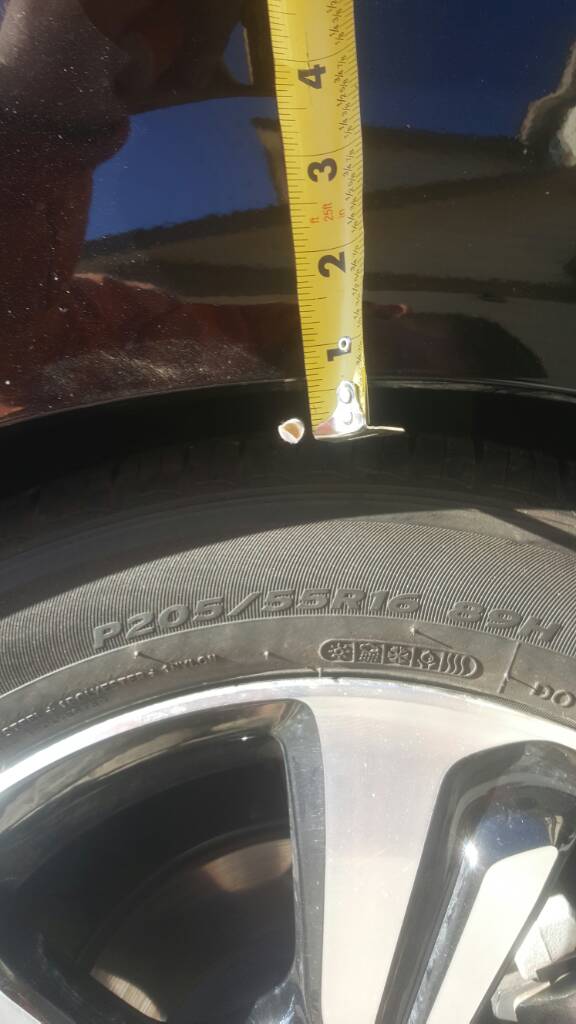

Stock ride height
Front wheel gap
Rear wheel gap

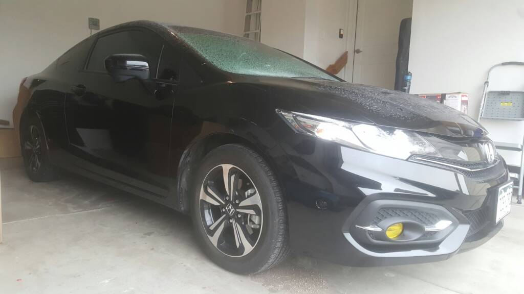

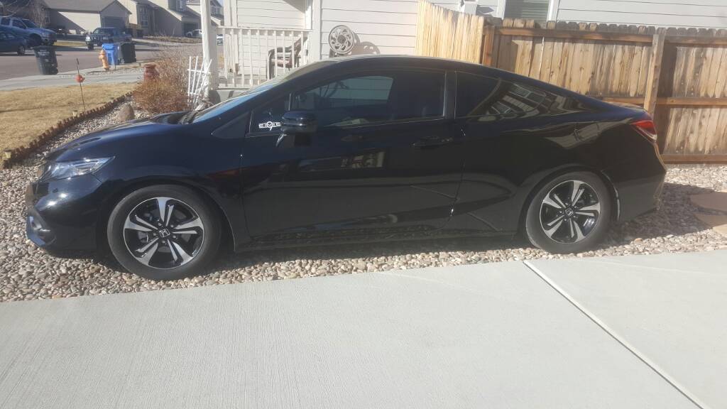

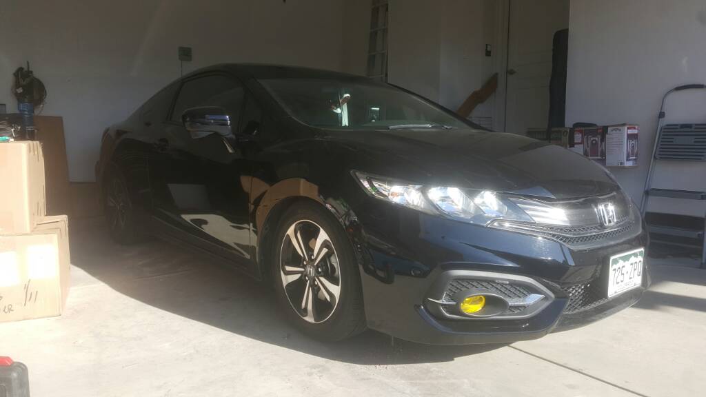

Lowered
Side profile

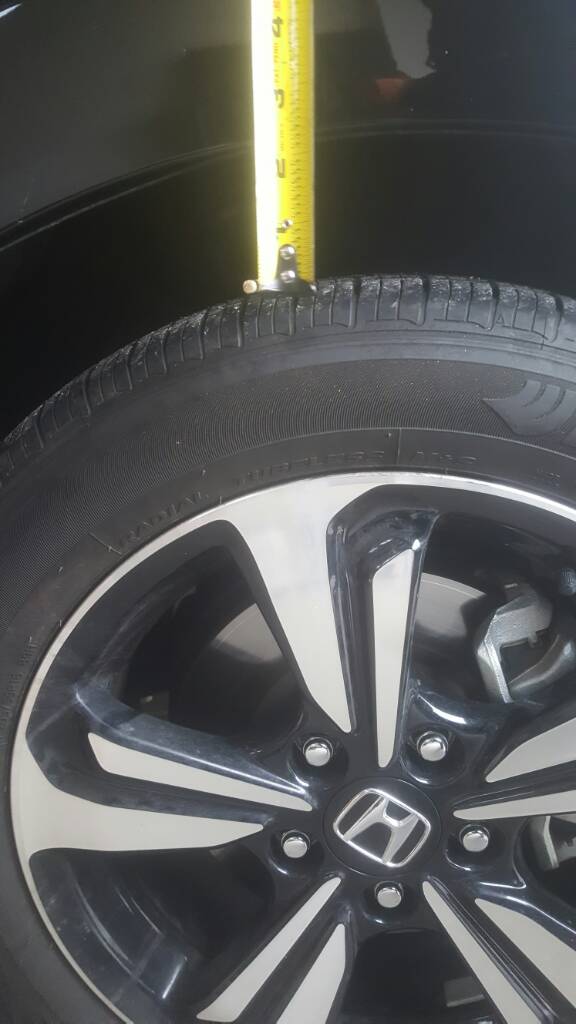

Front wheel gap
Rear wheel gap
So I started about 9 this morning and finished at about 130. Not too bad considering it was all hand tools
