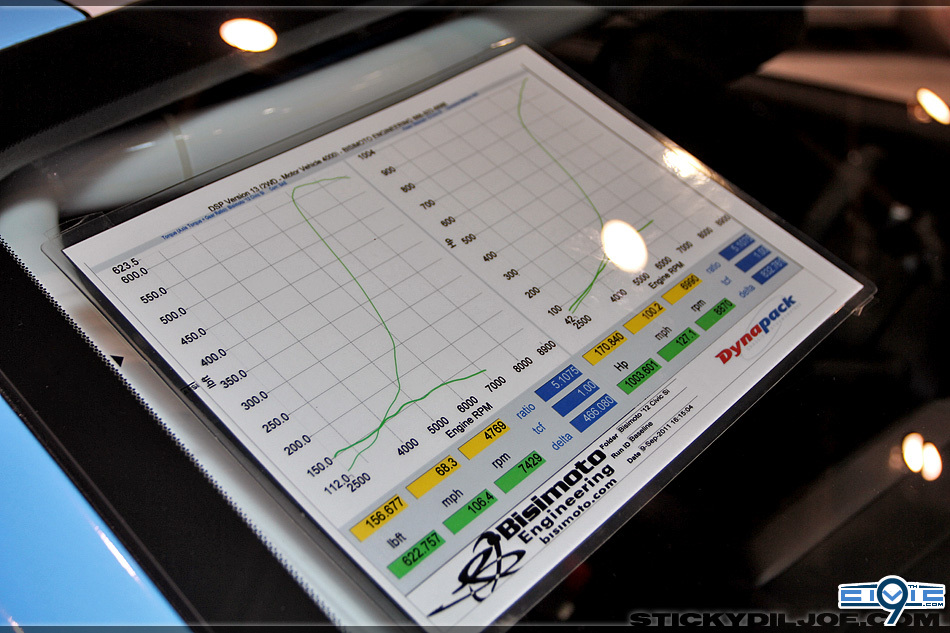

turbo - lag on power, but once the turbo spools - more HP, skys the limit on power (based on budget). Look at bisimoto - he hit 1000hp on a turbo setup

bisimotos dyno plot showed almost all that power over the top 1000 rpm.
