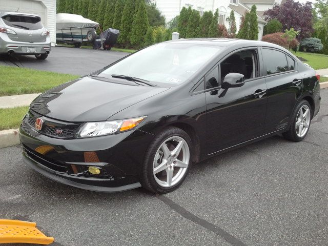

Hey, I was hoping to get some information on wheels spacers. I want to put on some Acura rsx type s wheels (17x7) and I want them to sit pretty close to flush with the fenders. I was thinking it might need a 10 mil spacer. Am I way off here? Or does anyone have any pics of 8th or 9th gen civics with Si or type s wheels and spacers? Thanks in advance for any help :)

yeah i used to be on 8th all the time site was cool..heres my FG2
..i loved my coupe but soon realized that it was getting annoying moving the seat forward or getting out to let my friends in and it got annoying. when i got my 9th i didn't really like the coupes and i still don't as much but they have grown on me but i love my sedan, the practicality and look of it sold me on it

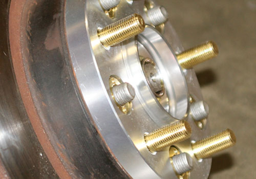

There are different versions of wheel spacers out there where you won't have to replace the stud.
Look up the ichiba wheel spacers. They have 2 versions and some good pics on their website to help explain it.
The ichiba ver1 requires longer studs be installed. (on anything over 3mm usually)
Ver 2 depending on the spacer size and the back side of the wheel being installed you may or may not have to grind down the stock stud.
Here is the ver2 spacer. As you can see the stock studs stick through slighly. If the wheel has indentations in the back you might be able to fit it over them without grinding them down or replacing them.
http://www.ichibausa.com/SearchResults.asp?Cat=37
