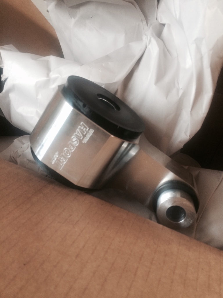

got a present in the male today too kev.. Did you install yours?
