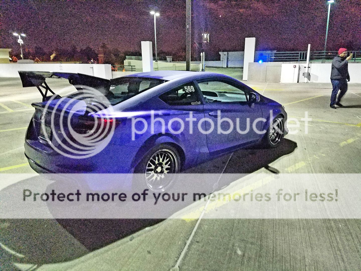

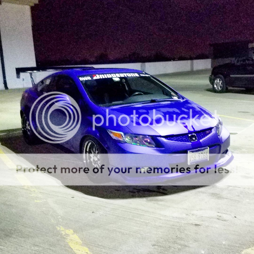

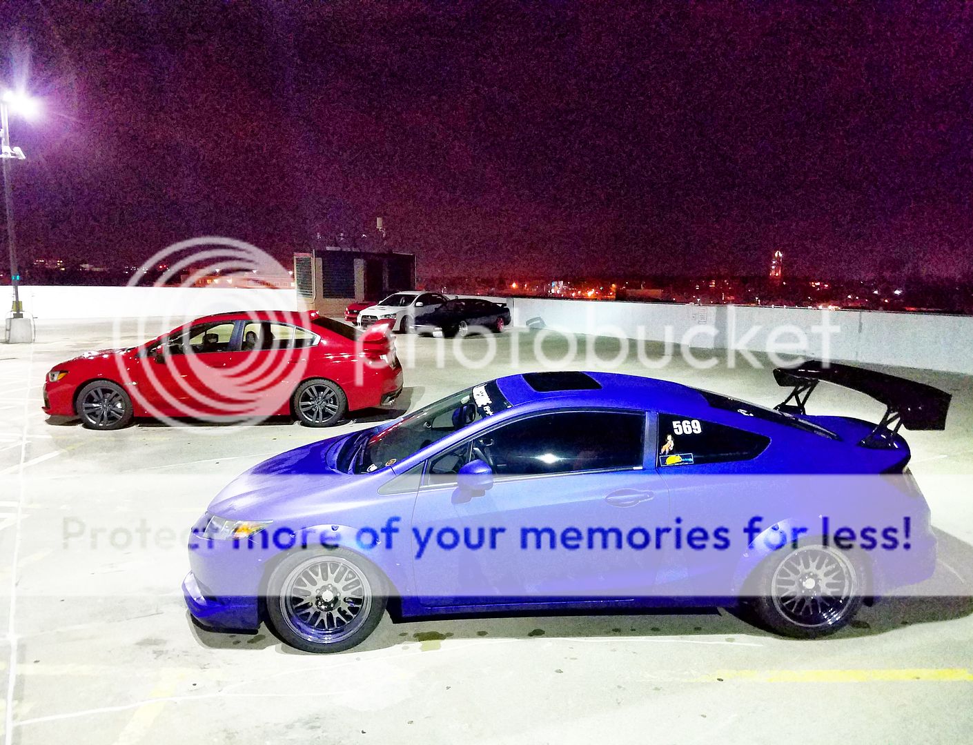

    Hello guys
    My current settup is 17x9 + 35 (plus 25mm spacers, so technically +10) offset. 255/40R17 on front, 235/45R17 on rear.
    As some of yall may know, I got some fender flares (wide zg 3.25in front, 3.75in rear) , i love the fitment on the front, but the back could "use some work".
    i already attempted getting smaller flares for the rear (2.75) but it created absolutely terrible wheel gap, and i could not move it down more because the cuts on the rear fender area would be visible.
    Some people are telling me to get wheels with a more aggressive offset to make them poke out more, or even wider wheel and tire too (or a combination of all)... however, this isnt a show car for stance shows, i actually do track days and autox, eventually i wanna do time attack street preped.
    Would running a wider track on the back create more understeer and make the car harder to rotate?
    Thanks

    Sorry for the late reply -- I'm not as active online these days cause I'm prepping my own car for Global Time Attack in April.
    I wouldn't run anything too aggressive in the rear. I run a 225. It will take 255 forever to heat up and yes, it will take away your car's ability to rotate as it sits. I would recommend maybe running a lower offset in the rear if you're looking to fill the fenders.
