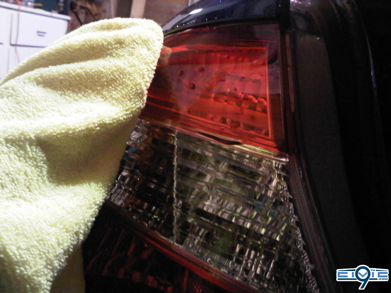

finally got around to using the can of nite-shades out.... heres my experience...

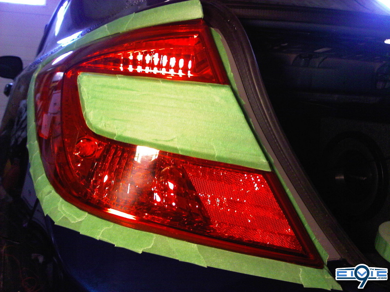

wash it well to remove grit etc....
dry well with preferably a lint free towel for car detailing...
tape it off.

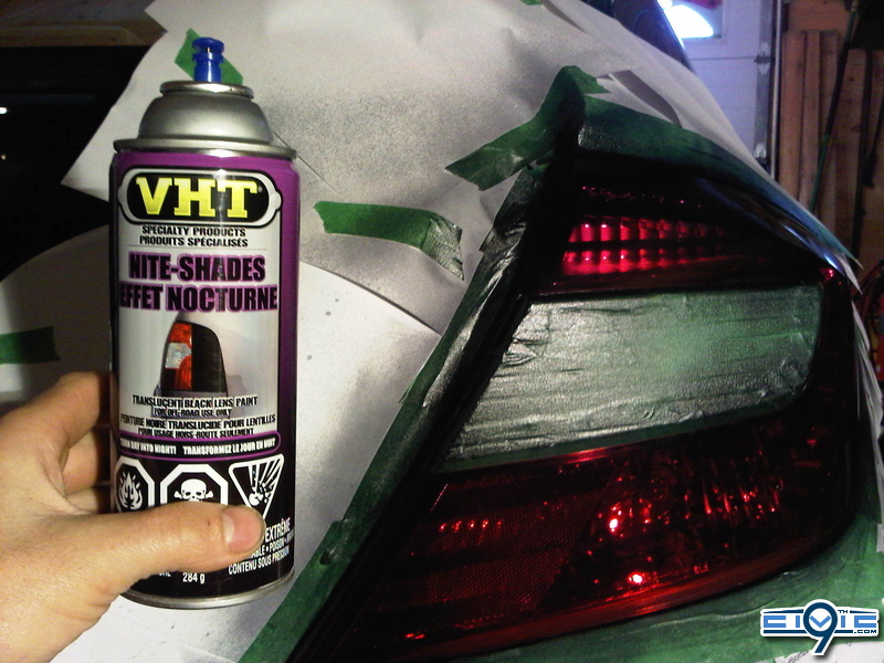

sprayed 2 coats.... a word of caution spray very lightly, even if looks unever, dont worry, the second coat will hide that... and as the directions say, back and forth 6-10 inches away.... swaying back and forth.

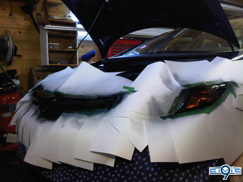

the front.... will be blacking out the chrome grill too ... took about 4 hours all said and done. i think looking back i would have just took everything out and reinstall....
sorry everyone, will post finished pic tomorrow.. will let sit in the garage overnight with heat.. :)

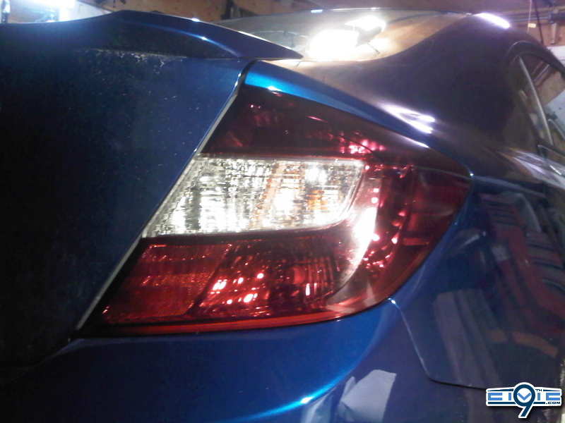

and presto.... befor i go to bed.. maybe tomorrow will be sunny and we'll wash her... :)
honestly everyone who does this swears by it.. now i know... so do I, makes a huge difference... less than $20 spent, 4 hours inside on a saturday, and still have half a can of tint left over ... :D

actually our eyes play tricks on us..... we have the tendancy to overspray the first time.. dont worry about the a super uniform darkness on the first coat, second coat u can get that... honestly i seemed lighter after it dried, so your eye doesnt catch the dis-unity of the color... but you're right, alot easier to take off.. :)

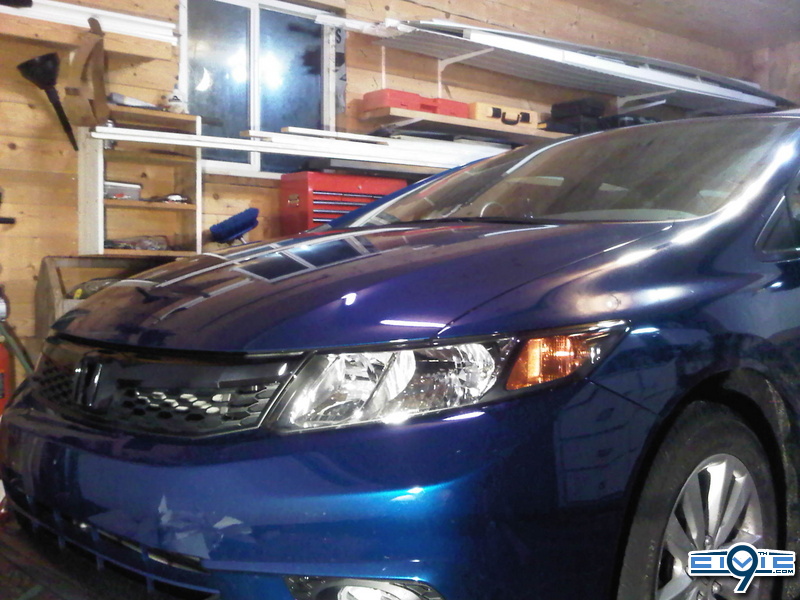

im sooooo glad i blacked out the upper grill chrome piece.... i kno after i buff and polish it, its gonna look awesome.... its still got a slight hint of chrome too, altho my fone does pic it up, its there.... and I'm sooooo glad i never bought a modulo grill too... :D and since the headlight lenses are slightly tinted, looking at it the front actually looks totally stock to me, except if you compared to what it used to look like....
