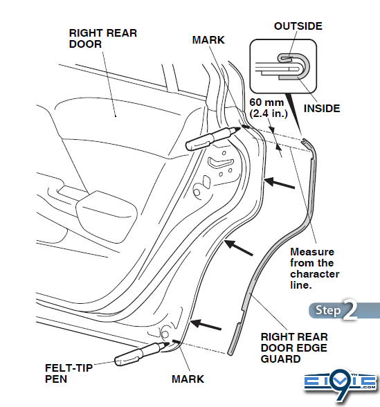

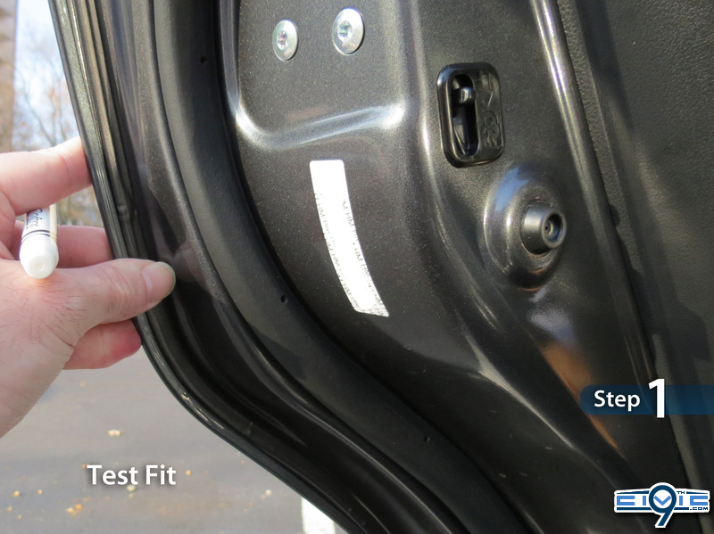

  1. Gently place the door edge guard on the door so as to line it up with the contour of the door.
  2. Using a felt tip pen, mark the sealant at the top and bottom ending point of door edge guard, then remove the guard.

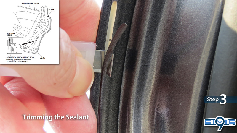

  3. Position the cutting edge of the seam sealant cutting tool against the door edge, and trim the seam sealant from mark to mark. The cutting tool only cuts in one direction. For the left-hand doors, start from the top and work your way down; for the right-hand doors, start from the bottom and work your way up.
    With the cutting tool, keep pressure against the door and stay flush. You're only trimming a sliver of the sealant. When you're done, it should look like the photo below.

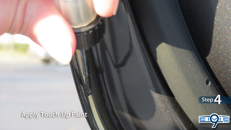

  4. Apply touch-up paint to the cut seam sealant area, and let it dry for at least 15 minutes. The reason for the touch-up paint is to hide the yellow color of the sealant that was exposed.

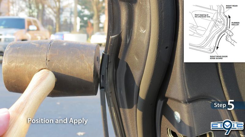

  5. Position the door edge guard on the door and align it to the marks made in step 2.
    Starting at the top character line, gently tap the door edge guard into position with a series of light
    taps using a rubber mallet, then work your way down. Make sure the position of the door edge guard is correct. The guard will slowly bend into the proper position as you apply taps. Once in place, do not remove, reposition, or reinstall the door edge guard or it will not hold securely. After the entire guard is in place, you can give it slightly harder taps to ensure a firm fit.

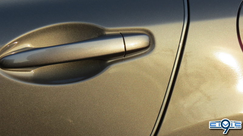

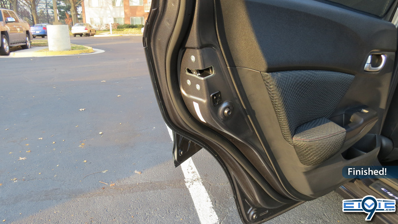

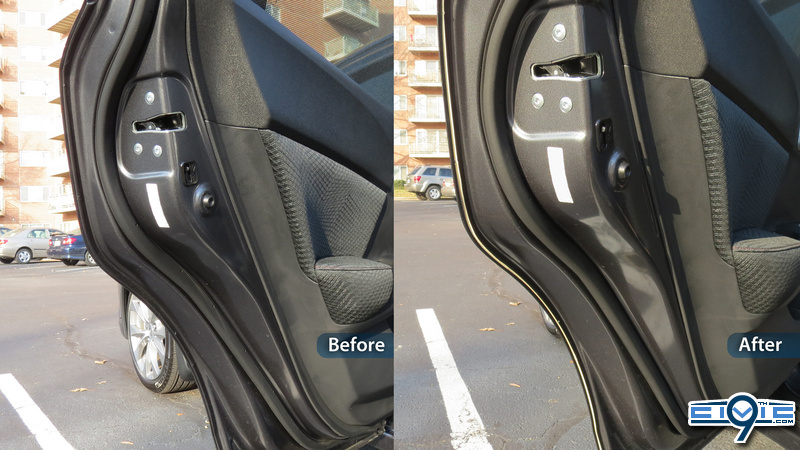

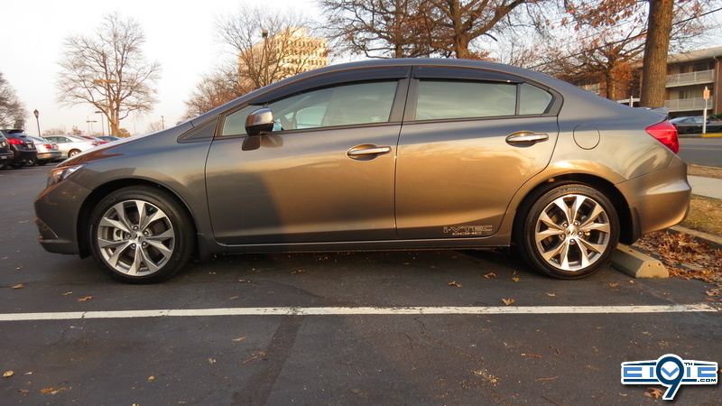

That's it, you're done! Here are some photos of them installed on my PMM Sedan.
Wow! Looks better than I would have expected. Barely noticeable from a distance. Too bad they don't go all the way up to the trim below the window, though.
look around the wheel archs as well and you will see it as well

interesting to see it around the wheel arch area.... is that intended to help with door dings, or you think it's purely cosmetic?
