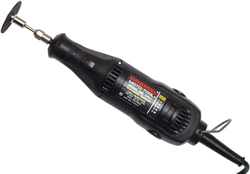

- Dremel or cutting tool

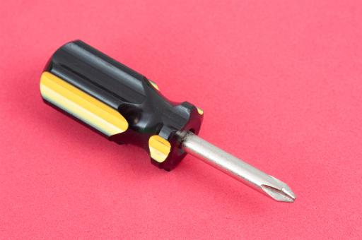

- Short Phillips Screw Driver
