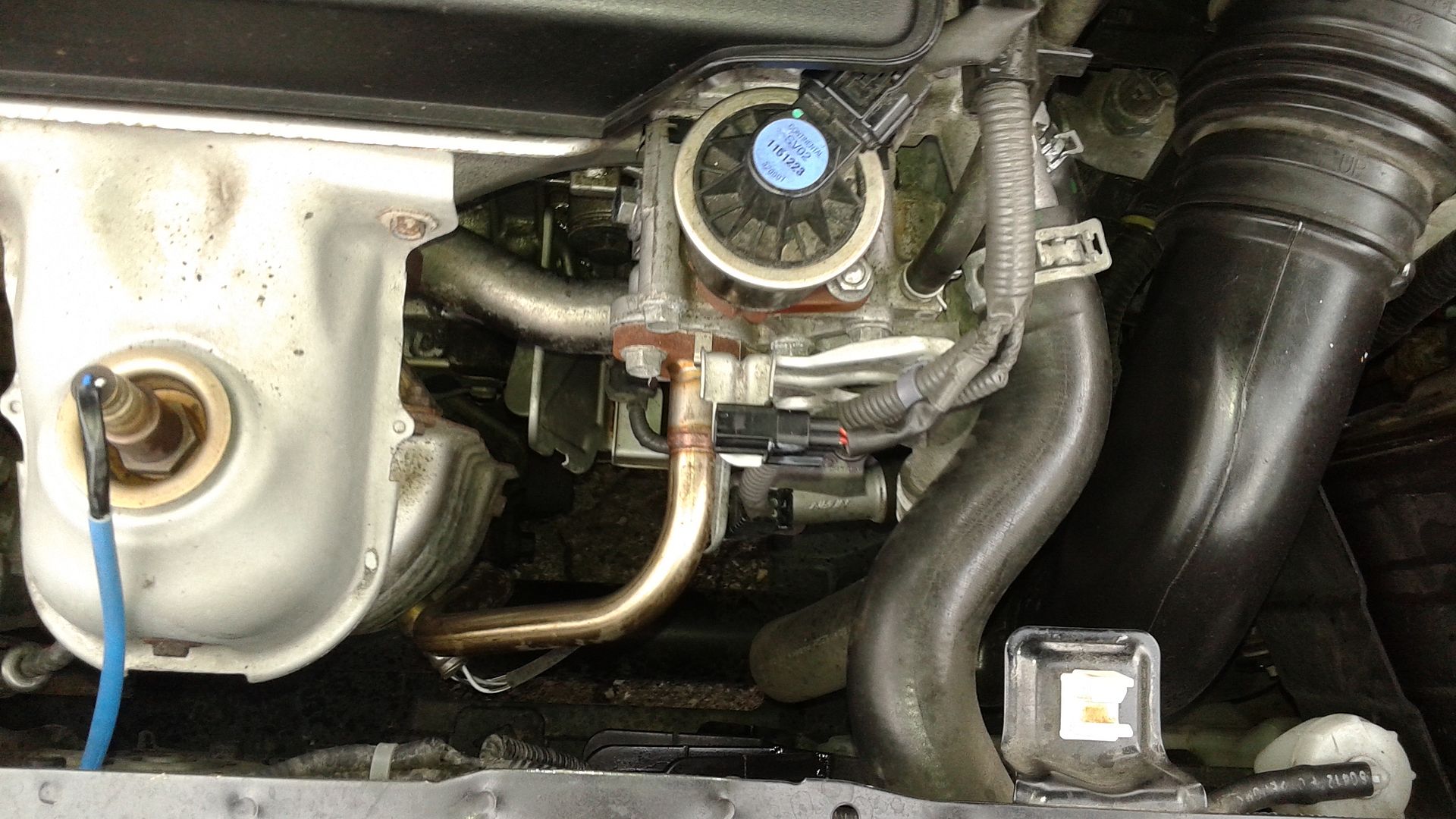

So start by locating the engine coolant drain plug. It is between your manifold and EGR valve.
So for my car, I tried with various extensions and universal joint, with a 3/8" ratchet as well as with an impact gun without success.
I finally got that bolt unstuck using a 1/2" breaker bar/ratchet, an extension pipe and a 19mm deep socket.
