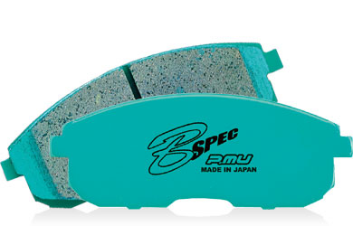

Project Mu B-Force Sport Brake pads:
Here is a quick review of some new brake pads I decided to try out. After upgrading my front brakes to the larger TSX calipers I needed pads to fit. The exact calipers I am running are compatible with the 1st gen TSX but came off of a 2012 Accord V6 EX-L coupe. Based on part numbers these should also be the same calipers on the 2012/2013 Si.
This means these pads should fit your car. The fitment is not listed on most websites but if you can find a vendor who carries these pads you need Part #: PBF304
I got mine from @THMotorsports
That is the pad size that should fit your calipers.
Project Mu website for this pad:
http://www.project-mu.co.jp/usa/products/pad_bforce.html
So far I have had them on for about 10k miles. Including one serious Dragon run weekend. These were a replacement for the AXXIS ultimate pads I had previously. While I love that pad I cannot find them. These are the closest replacement based on operating temp range and friction coefficient rating.
They have held up quite well but they are noisy when cold. Once the pad warms up a little they are quiet. I am talking the first stop of the day they make noise. After that they are silent unless you let them cool back down completely. There doesn't seem to be any loss of brake when they are cold either. The bite is not as hard as the AXXIS pads but they are not as dusty. They are dustier than the OEM pads but I feel that they are not terribly bad. They make a nice compromise on dust/aggressiveness. They are much more expensive but we shall see how they hold up long term.
Previously on my smaller brakes with the AXXIS pads I had smoking and loss of pedal. These did not give me any issues under the same conditions. I attribute that to the larger heat capacity of the system which is what I was going for with the upgrade. Overall, running nearly the same setup as the current gen SI I would recommend this pad to anyone looking for a replacement pad if you do more than daily driving but not track sessions. Maybe the auto-x guys and anyone making frequent dragon runs should look into these.
I'll try and update as I get more miles on them. I will also try and answer any questions anyone has about them. Thanks!
And yes they come in that awesome TEAL color. You can see it through the caliper.
Thanks!
In comparison I think the AXXIS ultimate is a better overall pad but their current market unavailability makes the Project Mu pad a contender.
