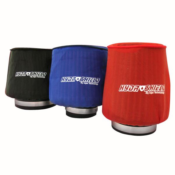

hmm i was talking to procivic through pm and he told me that the hydroshield isnt really helpful. his/her exact words were:
Also, the reason why we don't offer the HydroShield is because it restricts AirFlow and does not prevent hydrolock at all. It only prevents possible moisture droplets from getting the filter wet or damp. A wet or damp filter is not going to damage the engine on this car.
can you tell me more about the bypass, i just want to be extra extra extra safe, cause i cant afford to hydrolock especially when nothing covers that if its from the performance parts. and where i work, when it rains a lot, it floods, i was literally driving through a river last time, but of course if it ever happens again, ill drive off the road if i have to, im never going through a huge puddle again. lol >=O
I have to disagree with pro civic. I have the injen hydro shield on my cai
And before installed the hydro shield I tested it completely submerged it with my hand inside and my hand did not get wet. Also run it under the sink and my hand did not get wet until I opened it all the way up and then a small amount of water seeped through. So I would say it stops more than a few droplets. As far as restricts air flow goes I havent noticed a difference since installing it.

Also, a hydroshield is useful for keeping water from getting into the filter, as well as dirt and other debris that build up and clog the filter.
