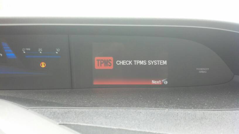

So i originally took these pics in order to make a DIY for those who didn't know what a fuse did (myself) and found out that this will only work on Canadian Civics. So if you have aftermarket rims w/o sensors this should work as suggested. With the message gone, you can then turn off traction control or just enjoy the orange lights being gone!

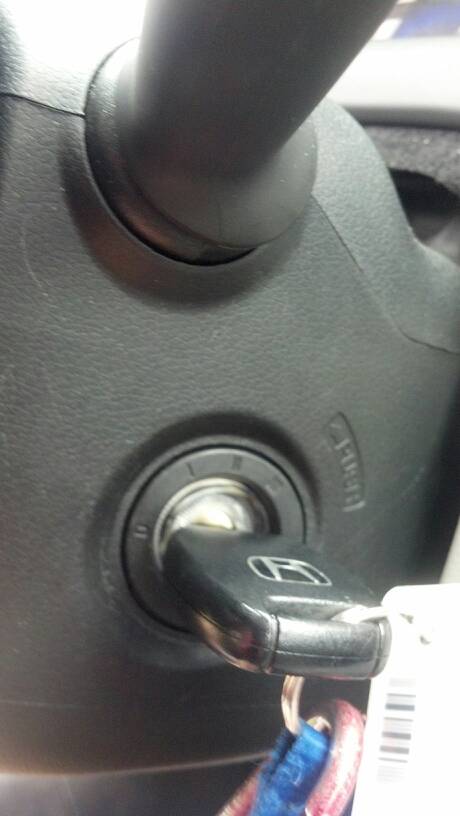

Turn keys to the 0 marking and leave them there. Pop the hood

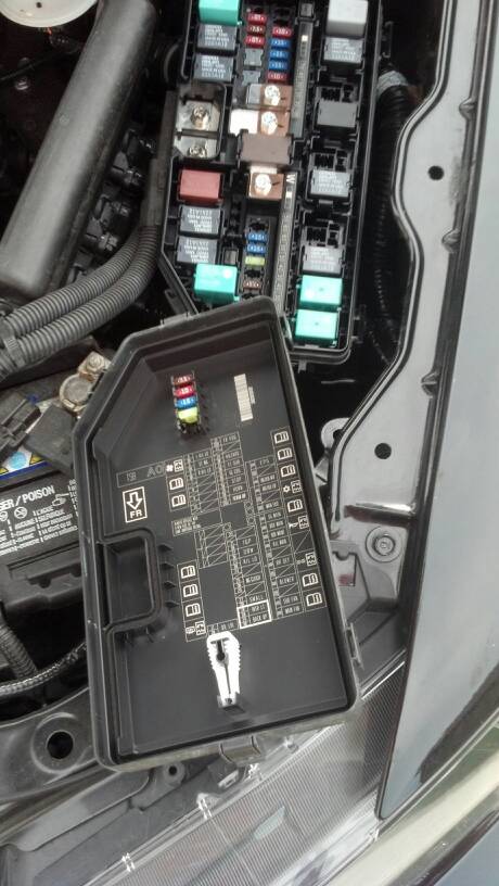

Open up the engine bay fuse box:

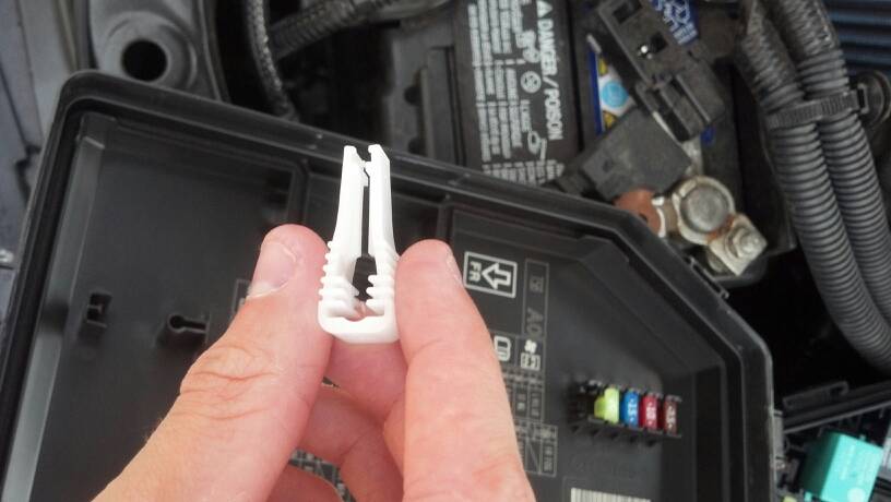

Take off the little white fuse puller from the inside of the fuse box lid

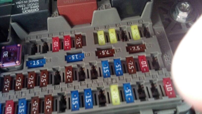

Step 4: Find fuse #40 on the interior fuse box located under the far left of the dashboard. (Its the brown one in the top row that says "7.5")
Step 5: using the fuse puller, get a firm grip on the fuse and pull straight out so you dont damage anything. Keep it around just in case
Now you're done! That should get rid of the IMID message and allow you to turn traction control off.
