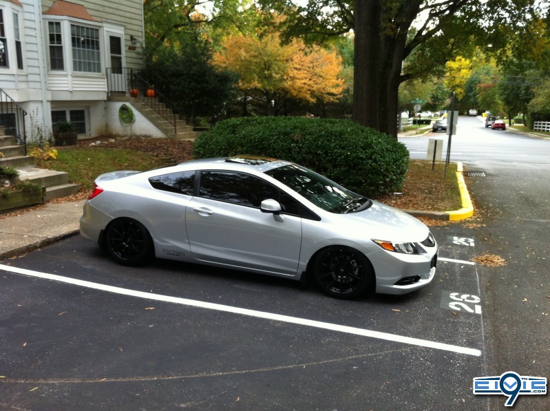

here are some pics to give you an idea of similar stuff on different rims/tire stretch... (I'll let the users comment on mods they used to get it done)
17x9.5 +15
Mikex18
BrandneW specs-18x9.5 +23
tires-215-35-18
"no roll nopull no camber" on d2 coilovers
pics - http://9thcivic.com/forum/threads/r...ivic-show-me-some-pics.3815/page-2#post-61925
17x9 +22ET running like -4 camber. @JayDieM.TraN

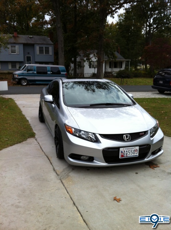

18x9 +25 Rota GForce in yamaha black
215/40/18 Federal SS595
KSport Control Pros
SPC rear camber arms
SPC front camber bolts (2)
