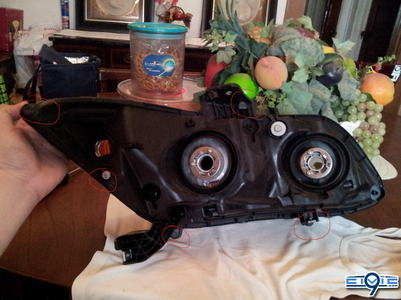

Step 3: Remove all sockets and bulbs from headlights
Step 4: Remove all 5 visible screws from the back of housings.

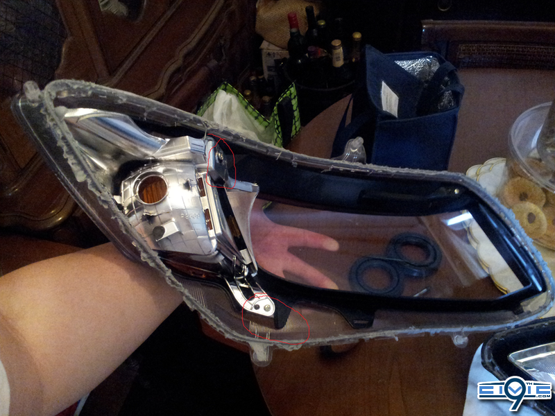

Step 8: Start from one corner use your Flathead to pry the headlight open.
Make sure to lift up all plastic tabs. *If Needed you can re bake the headlights for a couple more mins.*
Step 9: Now that the Headlights is open. Take 2 screws off the lens, where the reflector is located.
Step 10: You can use the flat head to pry the amber reflectors to get them moving.

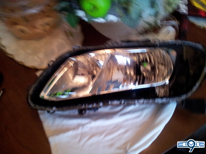

Step 11: Put everything back together.
Step 12: Place the lens to the backing. Just make sure everything is aligned right with the lens and the housing.
Step 13: Place headlights back in the oven for 10mins.
Step 14: Remove headlights from oven and put all the screws back in. The screws will pull the lens close tight to the housing. Push all tabs back in place.
Step 15: Place headlights back in the oven for 5 mins. Just to make sure the sealant will seal the headlights after putting all the screws back on.

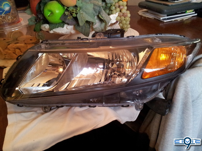

Before:

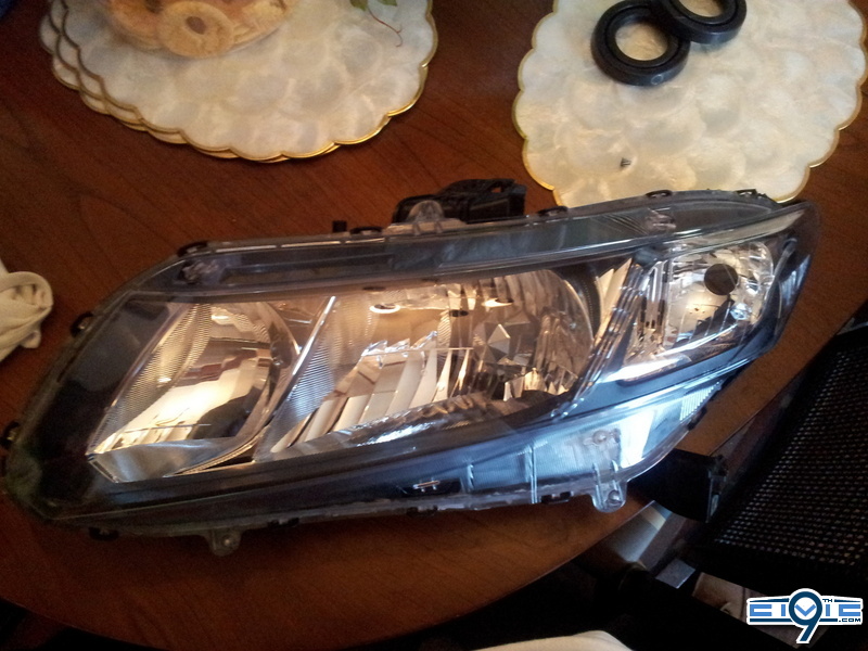

After:

Nice! The headlights look so much better without the abmer corners IMO; one of the may reasons why I like my Honda projectors :D
