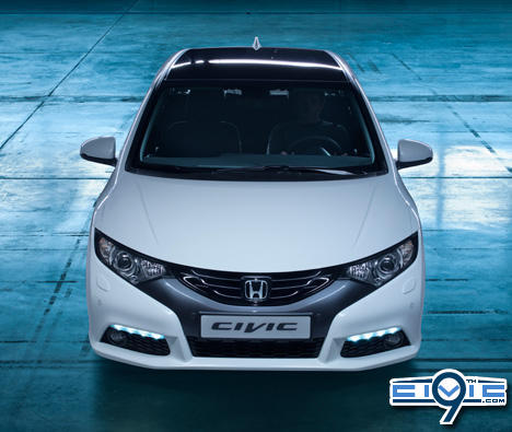

The new Honda Civic was unveiled at the Frankfurt Show just a month ago, with Honda claiming it is vastly improved from the outgoing eighth-generation Civic FN2. The wheelbase is shorter, but Honda also claim the new Civic is the most aerodynamic car in its class, with a drag coefficient of just 0.27.
"It does help to have a good clean shape to start off with but obviously we're going to add a lot of components which will have an affect on that" joked Plowman. "If you start off with a lower drag figure and add all of the aero parts required as part of the regulations, the drag figure with the same amount of downforce as we get on the current car should be less."
The new ninth-generation Honda Civic on which the team's NGTC challenger will be based.

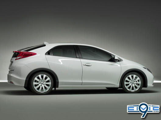

Side angle of the new Honda Civic 2012 road car.
