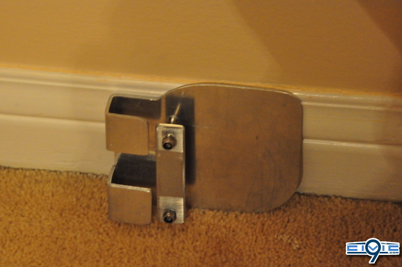

I had a look at the pedals and they seem very difficult to move - so after a while I decided to cut and bend an 1/8" aluminum plate to clip over the pedal. Best part is that there was no modification to the standard pedal and it removes easily with 2 screws.

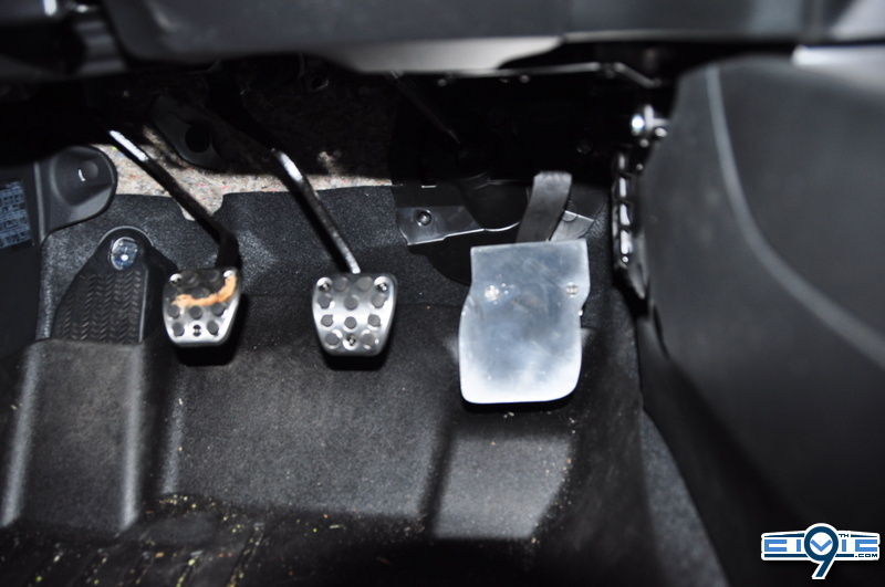

O.K. so it may not look so good - (kind of stupid looking actually) - but it's left edge is a good 1 inch closer to the brake pedal and at least 2/3 inch lower and this makes all the difference in the world.
It was quite easy to make (and I am no handyman's backside - as you can tell by the finish) - if you look at the "Pedal rear" photo (with the pedal on its side) you can see the top 2 bent tabs that hook over the top of the standard pedal and the small metal strap that secures it firmly in place behind the rear of the standard pedal. I cut up an old biciyle tube for a rubber liner to ensure that I do not scratch the original pedal. (The 2 screws straddle either side of the standard pedal - which explains why this clip-on is so wide.)

Cool. This version might be a little troublesome if your shoes are wet. I hope to see a final version soon! :thumb:
I have not yet tried it with wet shoes - but so far slippage on the pedal has definitely NOT been an issue, the Aluminum plate actually feels quite grippy - the original Honda accelerator pedal is also only an aluminum plate covering a plastic pedal - have a close look and you will see that its only the clutch and brake pedals that have little rubber pads - the gas pedal is just made to look as if it has rubber pads!

I am curios Adam how did you go about making it? Most curious about bending the aluminum? I have zero experience in working with metal myself.

I may just be a moron, but are the pedals on the 9th wider apart than on the 8th? It seems that way when I look at your pic, but I'm old and can't trust what my brain tells me is true most of the time. :spazface:
I haven't been on the driver seat of an 8th. But I can tell you that without this add on the pedals on the 9th do seem very far from each other. The new attached pedal helps a lot :) No drilling required.
