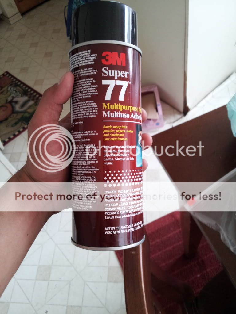

-3m spray adhesive

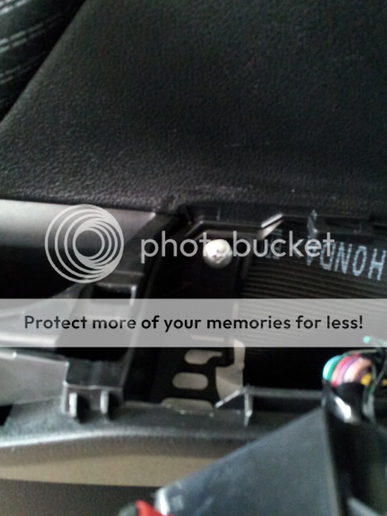

First you need to remove the cover that is in the door handle by pulling on it and pushing down the clip.
Unscrew screw.

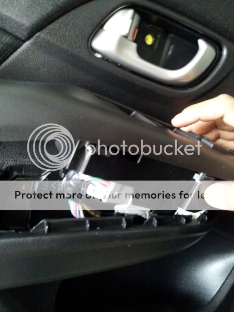

Next you can pop up and remove the door controls and also remove the relays that are attached
Unscrew screw

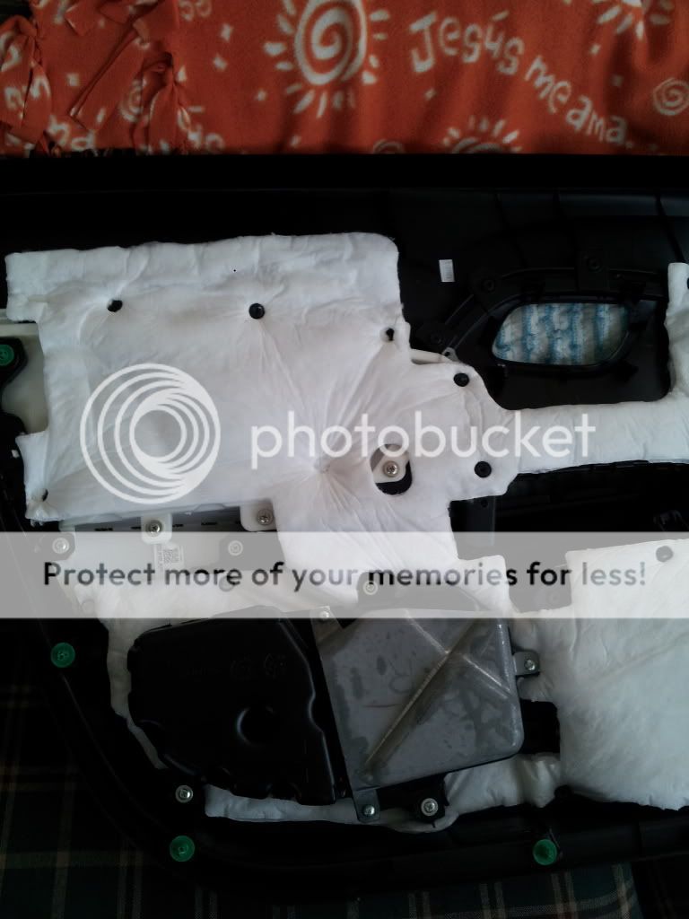

Then from here you can remove the door by pulling on and popping it from one side and working your way around

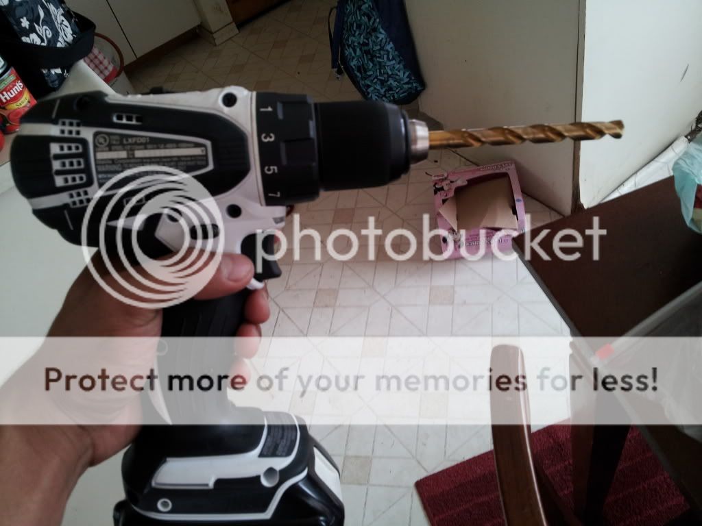

As you can see there's screws to unscrew also plastic tabs that you'll need to break. I used the drill gun and bit and found was the easiest way.
Their should be 5 screws and 4-5 plastic tabs to drill

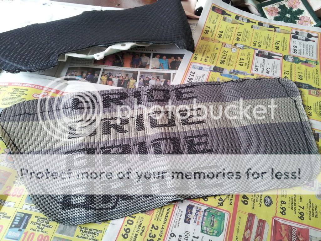

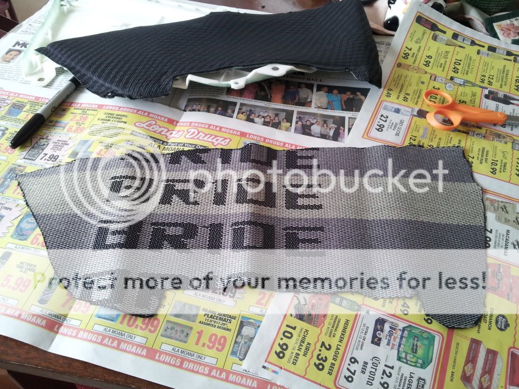

Pull out your door insert and remove the old fabric.
Then get your new fabric and if its not pre cut already then just trace your old fabric on your new one and cut out.
Make sure to test fit

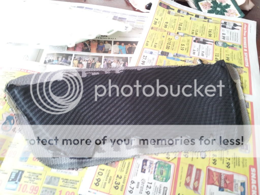

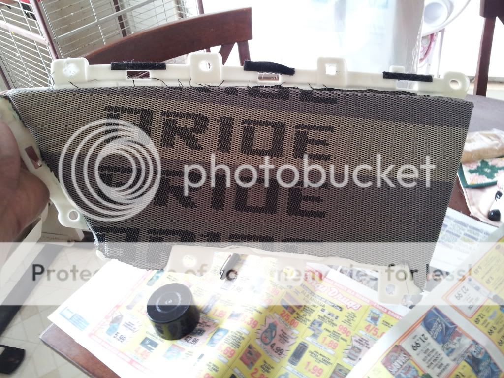

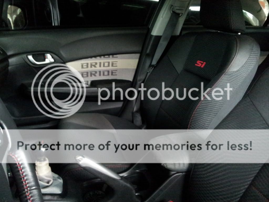

Next spray the 3m adhesive on both the panel and new fabric and put it on while aligning it.
Then let dry for about 30 secs with using the 3m spray other applications may take longer.
The tabs I've heard you could use some epoxy to fill the tabs and to hold it.
Then put everything back together the same way you took,everything off and that's it!
Repeat process for the other doors.

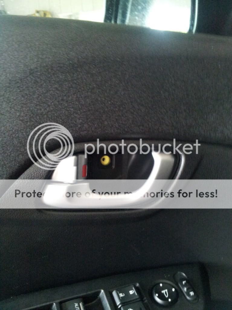

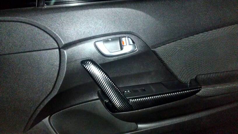

Bro came out great! I have a question, I want to wrap the silver/grey door handle things on the doors, do I have to take the whole door apart to take them out or can I pray those off?
edit: only the coupes have the door handles I'm talking about ugh!
Do u have a pic of the handle? I can check to see if it can be removed without taking the whole door apart. But also I have a sedan.
Lol post a pic if u do wrap it!
Thanks brotha! I'm probably just leaving it on as long as I have my CF mugen knob the day I change shift knobs I'll probably take it off.
Looks good! I never noticed that we didn't have that handle in the sedan lol. I actually thought we did but I'm thinking of my 8thgen coupe.
