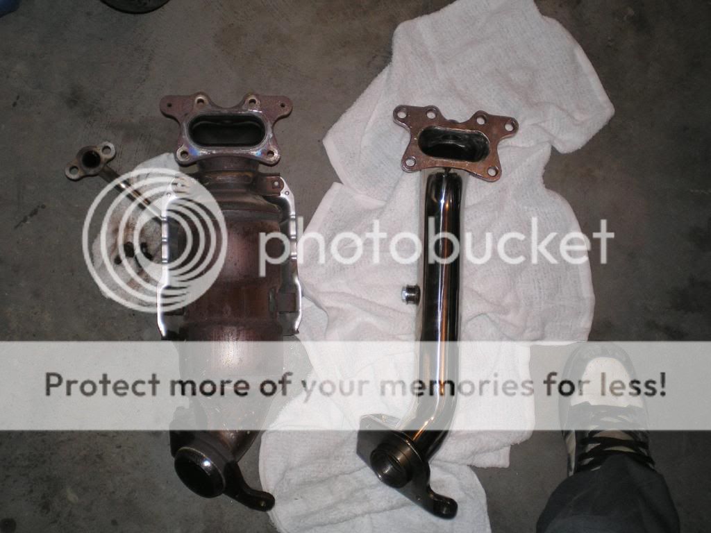

stock on the left -
note the cat that is almost right up at the flange which connects to the head of the engine. Aftermarket downpipe on the right ^

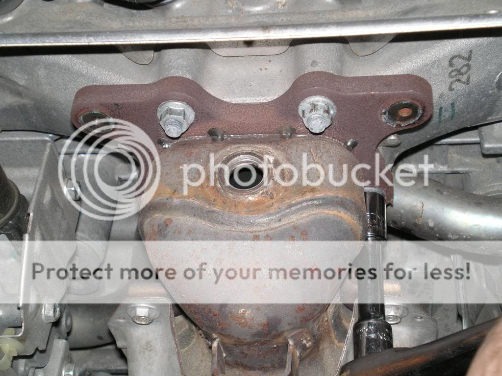

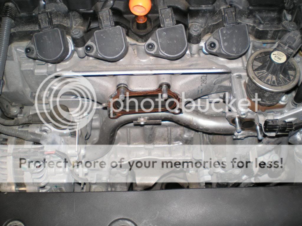

here is the downpipe removed from the head below
On the R18 when you open the hood you will be looking at a large semi round silver/gray heat shield. That is your catalytic convertor. Its bolted right to the "exhaust manifold" port on the block. The exhaust manifold is cast into the block and just has one large (relatively) opening. From the catalytic convertor there is a small "down pipe" if you can call it that. That short section connects the cat to the mid pipe of the exhaust. The mid pipe runs basically the full length of the car back to the muffler.
On these cars there really isn't a header. People call it that for ease of terminology. Replacing the cat is where you would put a "header" but most of them are just a "test pipe" as they call it. That will bolt in place of the cat and connect to the "down pipe." I know there are companies that offer that short section and call it a down pipe buts its really not a DP in the sense of the ones you see for the Si.
