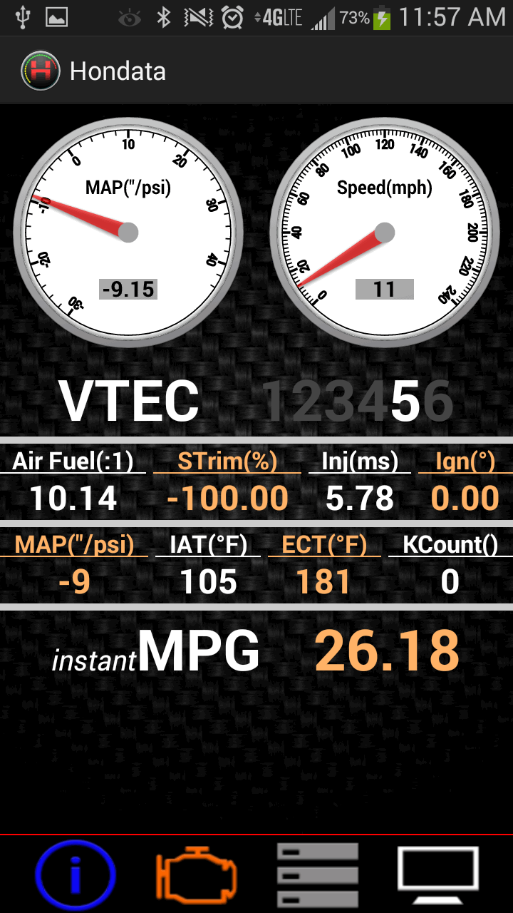

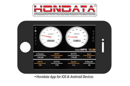

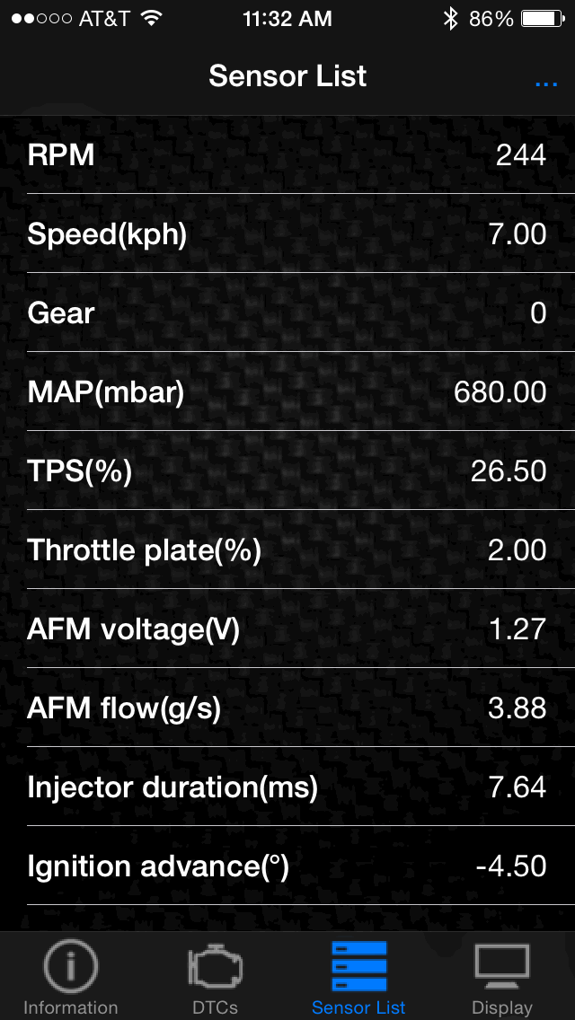

I realized yesterday when talking with a customer on the phone that many of you might not know about the FlashPro Bluetooth feature. All FlashPros we ship now have this cool feature at no extra cost! The FlashPro Bluetooth feature let's you use your iOS or Android device to download the free Hondata Mobile app that can communicate with your Bluetooth enabled FlashPro. You can see engine operation from your mobile device, check and clear engine codes, monitor engine sensors, setup custom gauges, set your shift light, and more!
