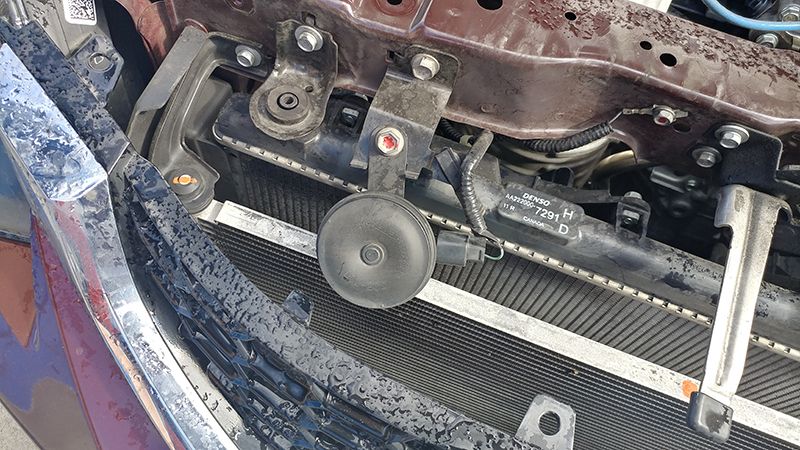

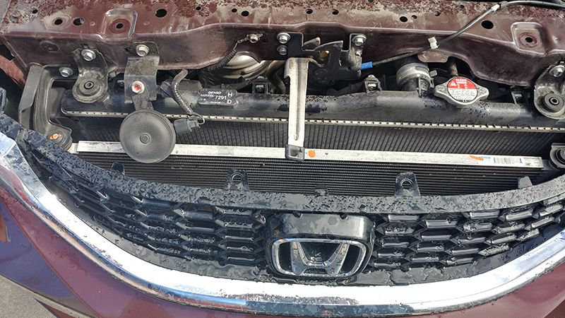

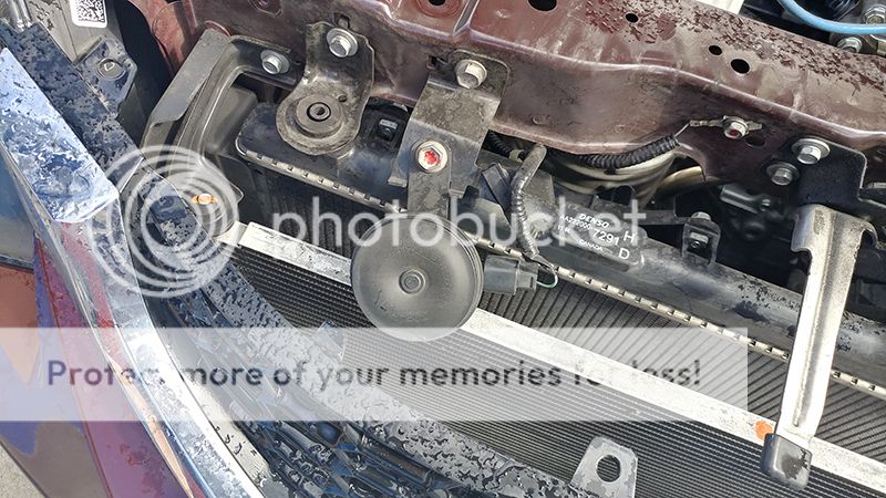

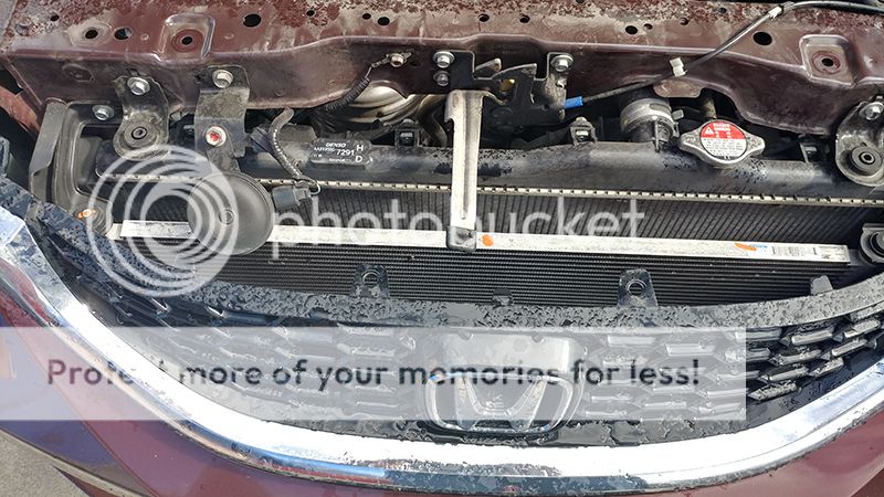

It turned out to be a very simple process. Pop the hood and then remove the 8 plastic rivets from the black plastic panel covering the radiator. There are then two Allen bolts holding it on, and the grille has tabs that slot into it as well. It's very straight forward how to remove the panel from those, and the panel pulls off by pulling it towards you.
This reveals the stock horn, nice and easy to get to on the left. Unhook the connector (there's a small tab you must hold down then pull) and use a 12mm socket to remove the bolt.

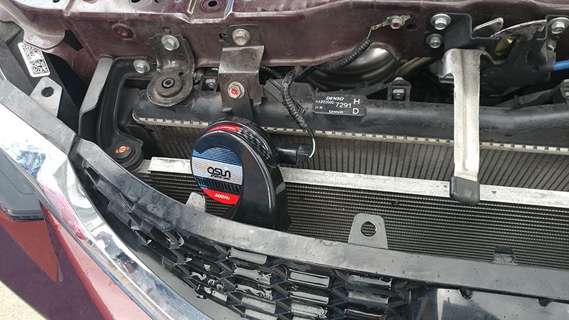

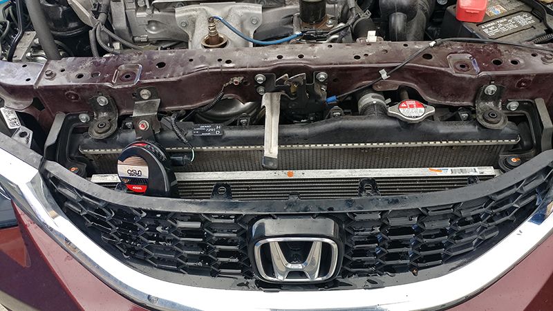

It's a simple process of bolting the new horn on and plugging it in. I did have to apply some pressure to the mounting bracket to angle the new horn down a bit since it is a lot larger than stock.
Keep in mind that you do need to bolt everything back in place for the horn to work, as I believe this is how it is grounded. I tried testing it by simply plugging it in and it didn't work. So don't think your horn doesn't work because it didn't work before finishing the install.
Once it's nice and tight, pop your plastic cover back on the reverse way you removed it, going from the grille tabs, then the Allen bolts and finally the plastic rivets.
