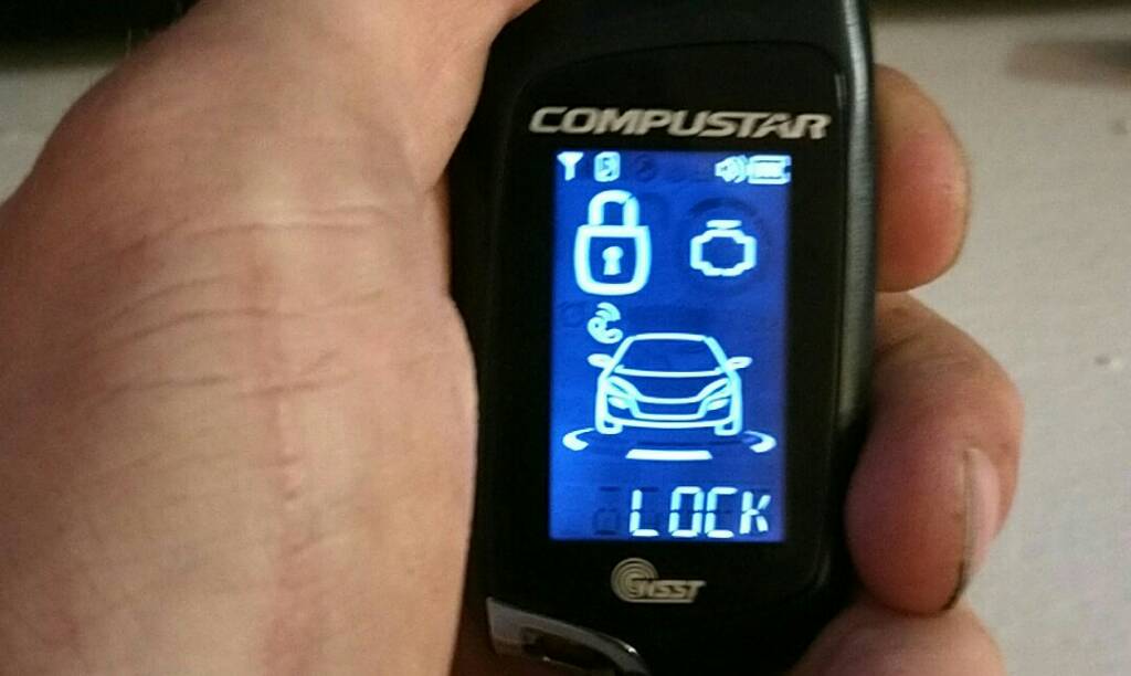

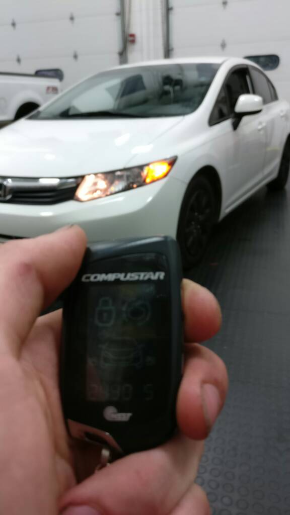

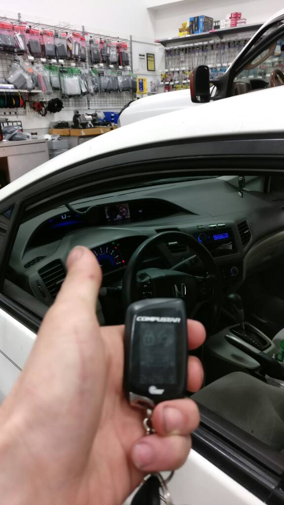

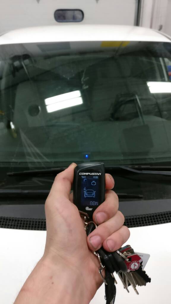

The system I have is the Compustar 7200 brain with the Prime T10 remote upgrade kit and the AlarmIt upgrade to make it a full blown security system. I install these for a living so I installed it on my own car. Let me know what you think :)

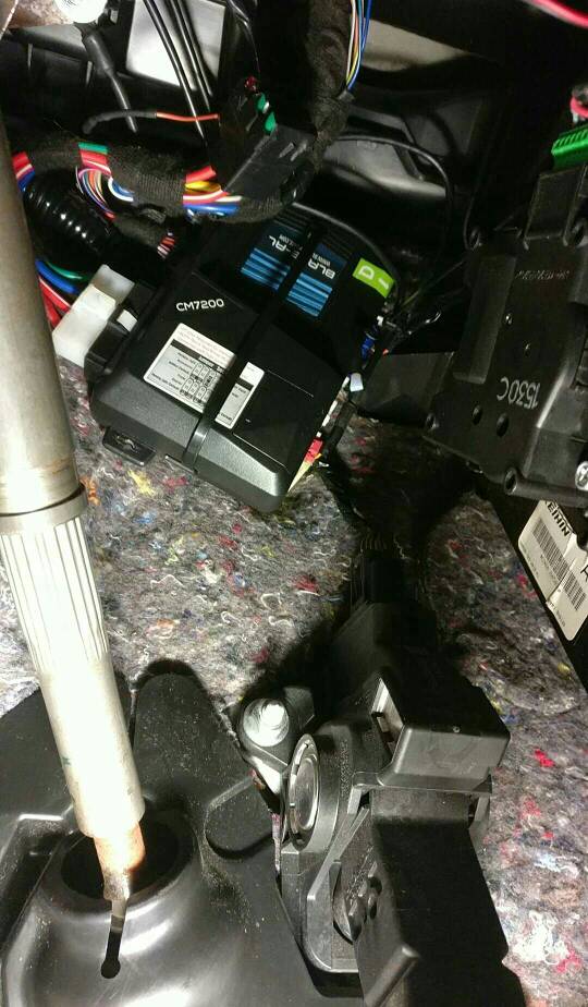

Not at all. Thank you for your help! The back of the remote says 700r. It's a Compustar. Like I mentioned it was in the car when in bought it. I know there's an idatalink box under the dash. I'll snap a few pics when I get to work. Do these help?
Sorry I've been busy with work and never saw you responded. It should handle trunk pop over data.. Did you try holding the trunk button down? I have pretty much the same bypass with the exact same firmware and it just worked
