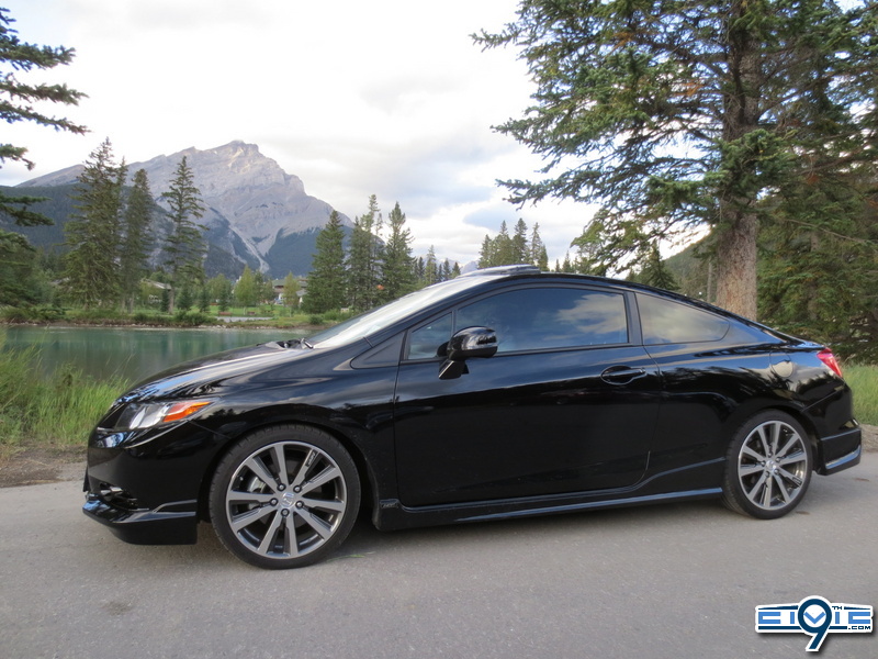

Side profile of car with roof visor:

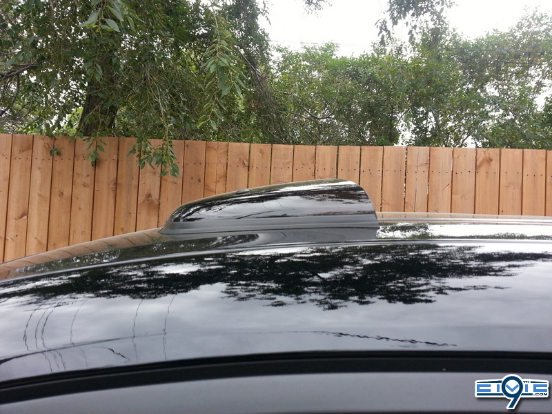

Side Profile of Roof VIsor:

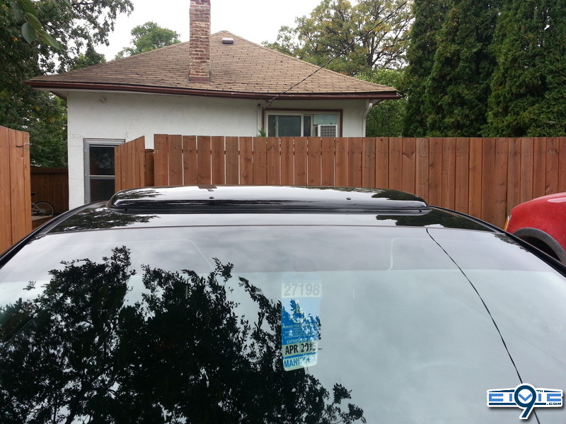

Front Profile of Visor:

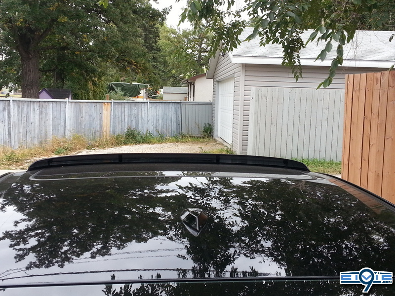

Rear View of the roof visor:

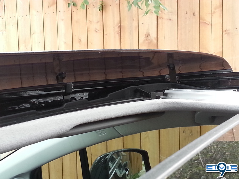

Side Profile of the clips that hold the visor to the roof:
