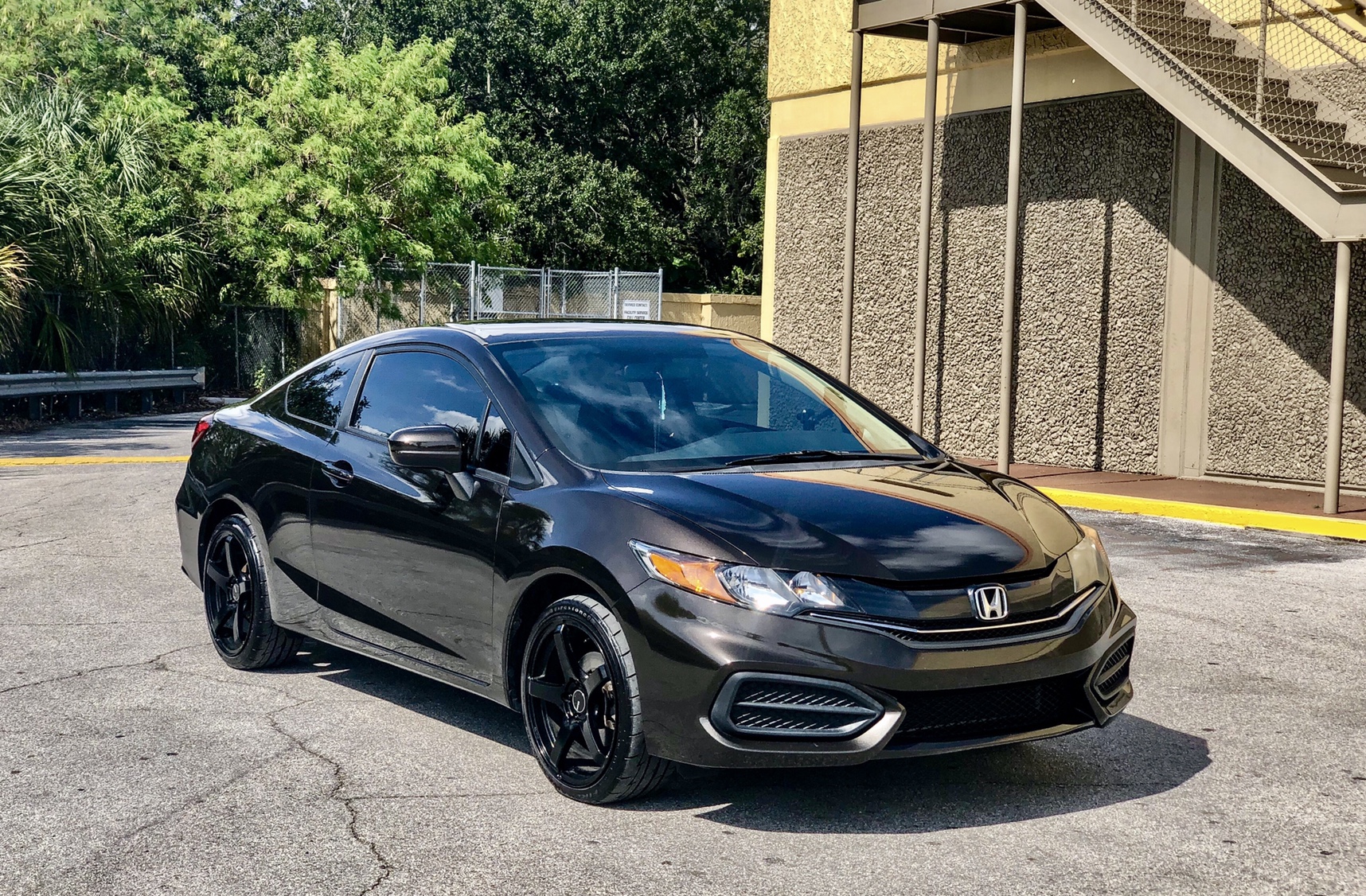

I have some 18x9 and 18 x 10 30 offset both.
I saw them on my friends care and he says he has no camber it seemed like they stayed tucked in the fender well.
I'm just trying to reassure if they will rub or not.
