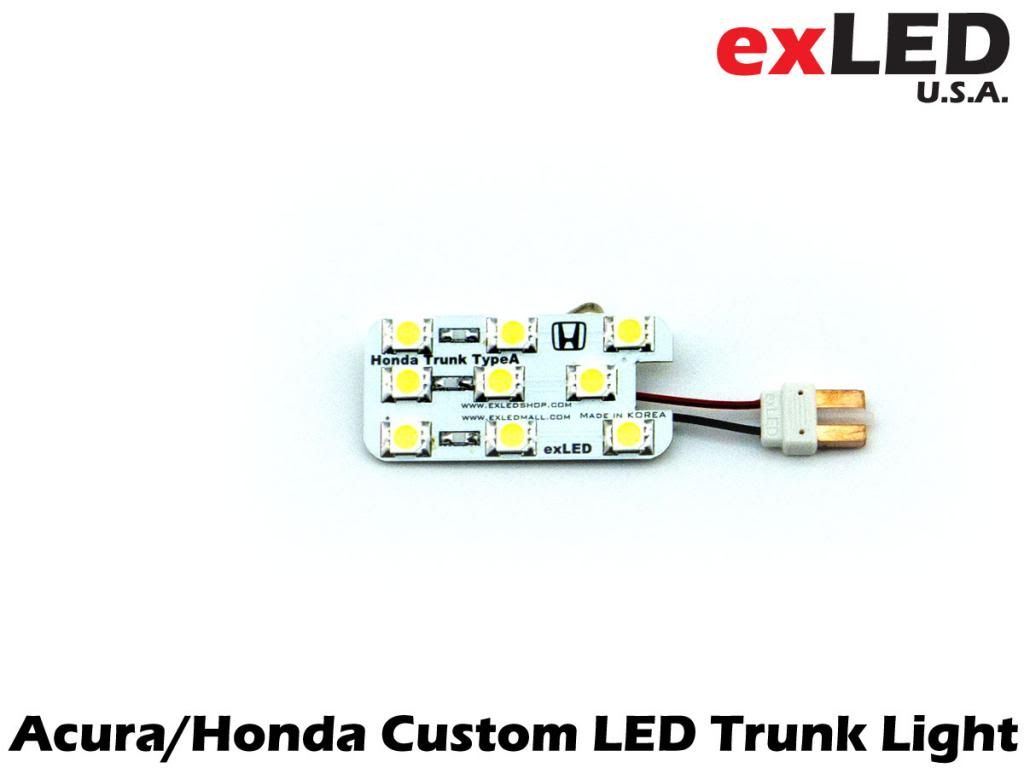

    Changed Map, Dome and Trunk/Cargo Lights to led.
    [​IMG]
    Map and dome lights from ijdmtoy: http://store.ijdmtoy.com/Honda-Civic-Direct-Fit-LED-Interior-Lights-Package-p/civic-df30.htm
    Trunk/Cargo Light from exLED: http://www.exledusa.com/exled-acura-honda-custom-trunk-light.html
    [​IMG]

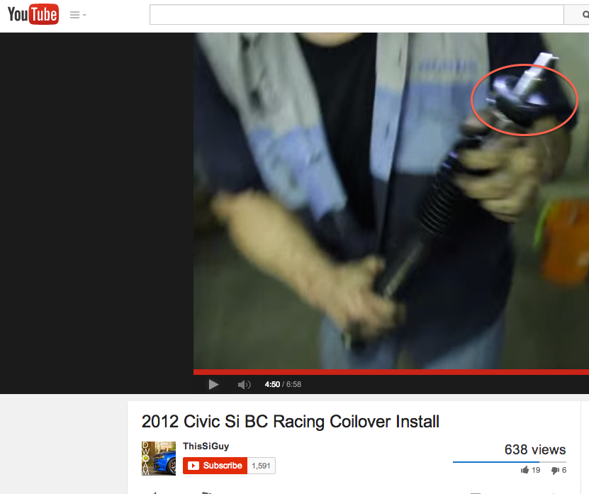

    Here's the info, maxed out the rear spring perch. So both blue rings are spun all the way up. The shock is also maxed out. The result is what you see in the picture above. I'm running SPC camber arms. (thanks @Dar-Dar). I also want to note that I transferred the rubber bowl thingy thing from my stock rear struts to the megan rear struts... except i installed both of them backward, so instead of them facing upward like a bowl (in the picture below)... they are facing backward like an umbrella.
    This is all the info i can provide. if the rubber thingy things are NOT the problem, should i still correct it, will i run into future problems?
    [​IMG]
    I've read and searched near and far on google what the clunking/knocking noise may be (specifically for our 9th gen and specifically on megan ez streets, though it seems to be common with a lot of coilovers)
    There are multiple threads but I come to a dead end because the other people who've had my problem never updated to tell what it was or even how to fix it.

    I suspect the clunk is coil bind. The coils are compressed so hard/far that each turn of the spring is contacting the next one. I would correct the direction of the rubber isolators just so you know that is not the problem. Eliminate the easiest possibility first.
    The other thing you could try, which I know you won't like, but just as a test, is to raise the car a bit and see if the clunk and knock sounds are reduced. If they are less often and less noticeable then it's probably coil bind.
    Two options to try if its coil bind:
    1) Raise it a bit. (if that helps)
    2) Get a set of spring coil silencers (rubber bits that help quiet them down.)
    http://www.tein.com/products/silencer_rubber.html
    [​IMG]

    Also I used the plastic rings they came with, not the rubber ones.
    Being that low, I would raise the back of the car and check to see if the lower control arms are clanking against the exhaust or sway bar. Mine were.
