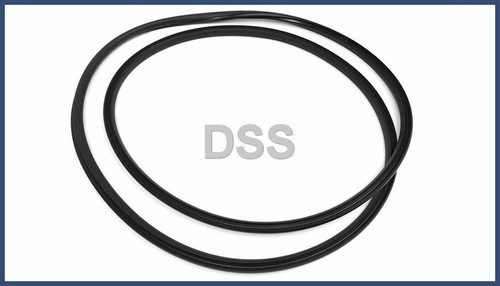

that appears to be just the rubber strip. You can see it in this pic here -
The glass part looks to be over $300. I'm not sure why he would say you cannot buy the gasket seeing as how the gasket is for sale. If you buy it from college hills, just ask the parts people. They can easily confirm the gasket you have linked.

I gave College Hills a call today and confirmed this is the part. Placed my order which should be here in a couple days!

So, the part arrived today. In order to replace, I had to remove the moonroof from the car. This was an easy process and involved removal of 4 torx screws. The video I shared in my initial post shows this process. Once the moonroof was out of the car, extracting the damaged weather-strip was pretty easy. It has a solid rubber lip that inserts in a grove around the outside of the glass and is held in place by friction only. Installation of the new weather-strip was also easy and straight forward. I just had to push the solid rubber lip in to the groove pressing firmly to make sure it seated fully. Also, the part is a single piece so there is no concern about a seam.
The only difficulty I experienced was reinstalling the moonroof which the aforementioned video also addressed. You might be able to do this yourself, but it would be pretty difficult. I had my wife help. The total time involved in replacement was about 30 minutes but I took my time.
