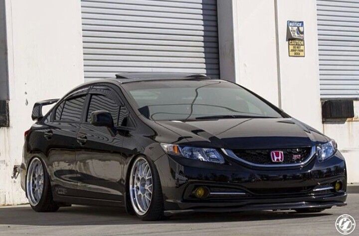

Hi guys. Been lurking the forum and the web for a while learning about cars (just got into them). I have a question about suspension. I want a flushed look like this, although the height may seem just a little too low as I go to the mountains a lot with this car. (Pulled the image off google)
I have a stock 2015 Civic SE sedan. I forgot where I read it and/or if it's car specific, but at what point of a lowered (height) car affect other suspension parts, like end links, to where they need to be changed to accommodate for a more lowered height? Will spacers affect end links too?
Also, I was reading that the bolt on the strut tower and the knuckles are different from SI and non SI. When buying coilovers online, I can't seem to find the size of the bolt used by the coiilovers and my car. Where do I find this info so I don't make a mistake buying the wrong suspension?
When buying on ebay, do i have to worry about coilovers being fake/replicas? Any tips or things I need to look out for when buying coilovers on ebay?
If you have any links for me to read up on, please do give them. I want to accurately learn as much as I can as I don't know any specifics about cars and the terms used. Thanks!
So far, I still need to read up on camber, caster, offset, end links and not sure what else is there...
