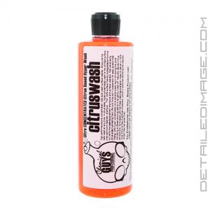

Citrus Wash: Really strong soap for when the car is very dirty
http://www.detailedimage.com/Chemical-Guys-M31/Citrus-Wash-P410/16-oz-S1/

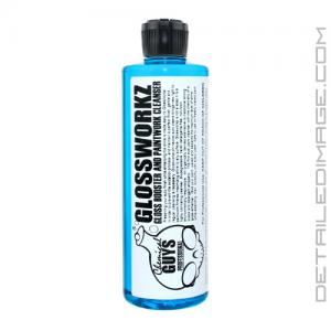

Glossworks Soap: For when you have already detailed and waxed the car. This stuff does not strip wax. The Citrus wash mixed very strong will. This is a great maintenance soap.
http://www.detailedimage.com/Chemical-Guys-M31/GlossWorkz-Paintwork-Cleanser-P446/16-oz-S1/

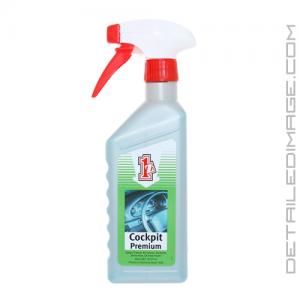

For the interior you can always get the Honda stuff but I like this stuff from Einszett lately. It definitely has an industrial serious cleaning has gone on sort of smell.
http://www.detailedimage.com/Einszett-1Z-M46/Cockpit-Premium-P471/500-ml-S1/

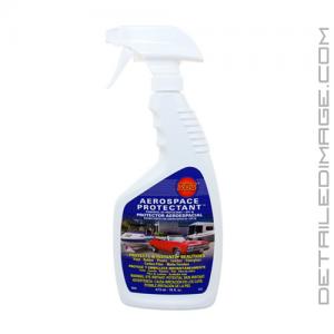

If the interior is not too dirty and you just want to get the dust off this stuff is the best though. Its almost all I use for interiors. It also has UV inhibitors to protect everything from the sun. If you only want to buy one thing get this stuff. 303 Aerospace Protectant.
http://www.detailedimage.com/303-M2/Aerospace-Protectant-P12/16-oz-S1/

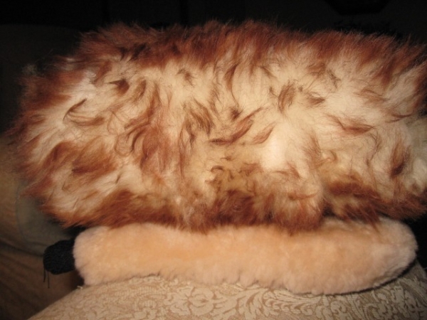

2 buckets, grit guards, 2 wash mitts. One mitt for upper panels, one for below the rocker line. I like sheepskin wash mitts myself. I use a sheepskin/wool on the upper panels and microfiber chenille "finger" mitt on the lowers.
I really have 3 though. My old worn out MF mitt becomes my wheel mitt. I get a new one every spring and rotate the oldest one out. Sheepskins get replaced when they tear.
I use 2 buckets and just 2 grit guards in the rinse bucket. I don't put any in the wash bucket. Shouldn't be any contamination in that one anyway. Start with the wheels and then rinse out the bucket, refill, and wash the rest of the car. Wheels are usually the dirtiest so do them first. If you do them last you will probably end up spraying dirt from the wheel onto your clean paint.
Wash mitts: Ya, I have the big wookie one too. Sheepskin on the bottom.
Sheepskin mitt:
