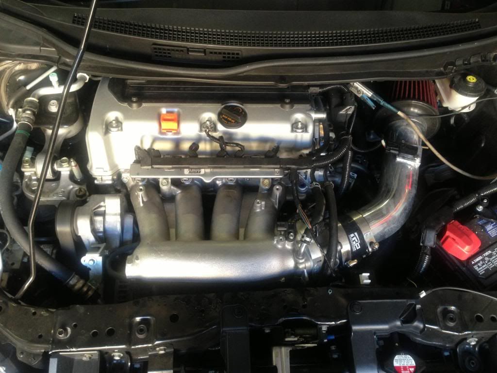

I recently installed a PRL cold air intake, RBC intake manifold, 1000 cc ID injectors, Skunk2 megapower RR exhaust, and skunk2 alpha series headers on my 2012 Civic Si sedan. Shortly after install I had my car tuned. While being tuned the tech told me I had some restriction of air flow but he didn't know where it was coming from. I put down 212.43 whp but I figured I should be around the 230 whp range. Let me know if you guys have had this problem or know a solution. Thanks.

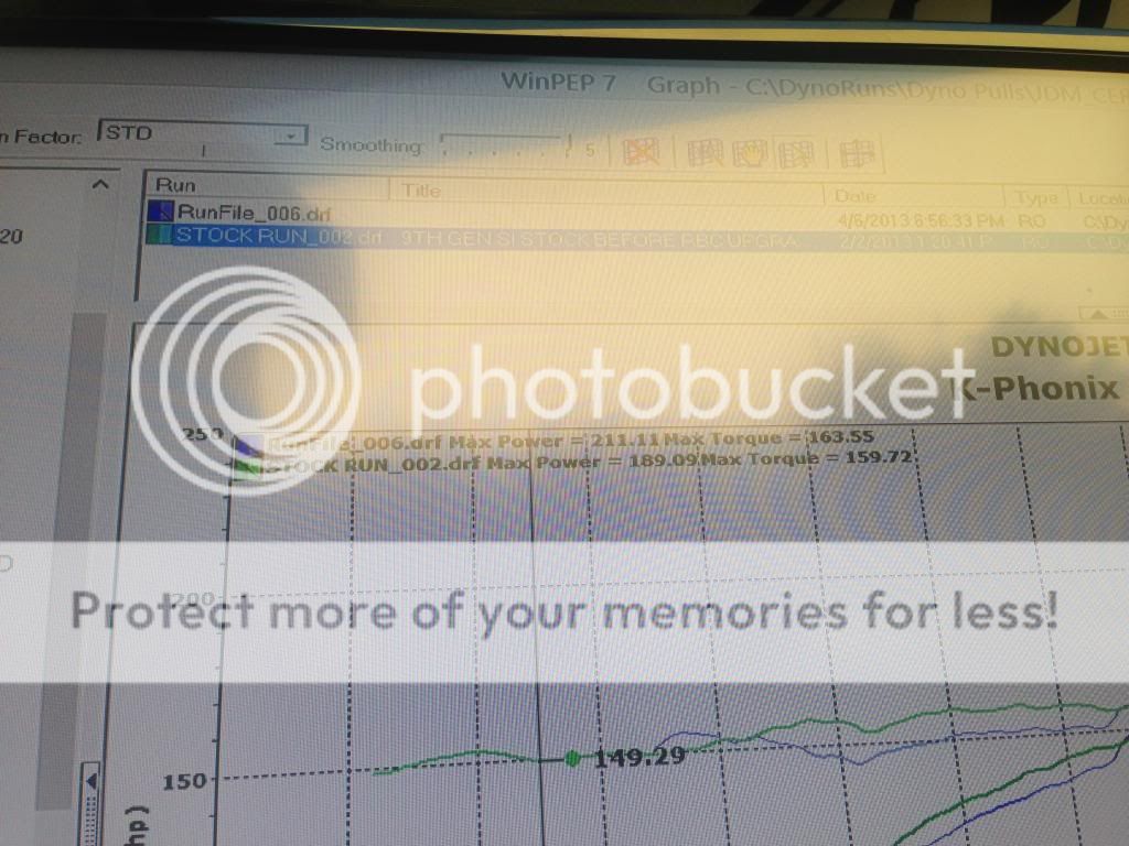

team K-phonix 9th gen civic RBC dyno update.
so a couple months ago we installed an RBC on a customers car known here as @jdm_certified,we used stock 8th gen injectors and the j30 throttle body with a port match to flow more efficiently with a custom short ram we made.customer was able to get his hands on a flashpro and get the most out of this install.we have more plans for this car such as running a velocity stack to the front of the car,skunk2 downpipe and full exhaust,possible e85 and nitrous.from what we seen these motors have potential even still with alot of restrictions held back.we were surprised what we saw after the dyno tuning,we were able to get to that power with only 4 pulls limited.we want to experiment with these new platforms and see what the z7 can do.

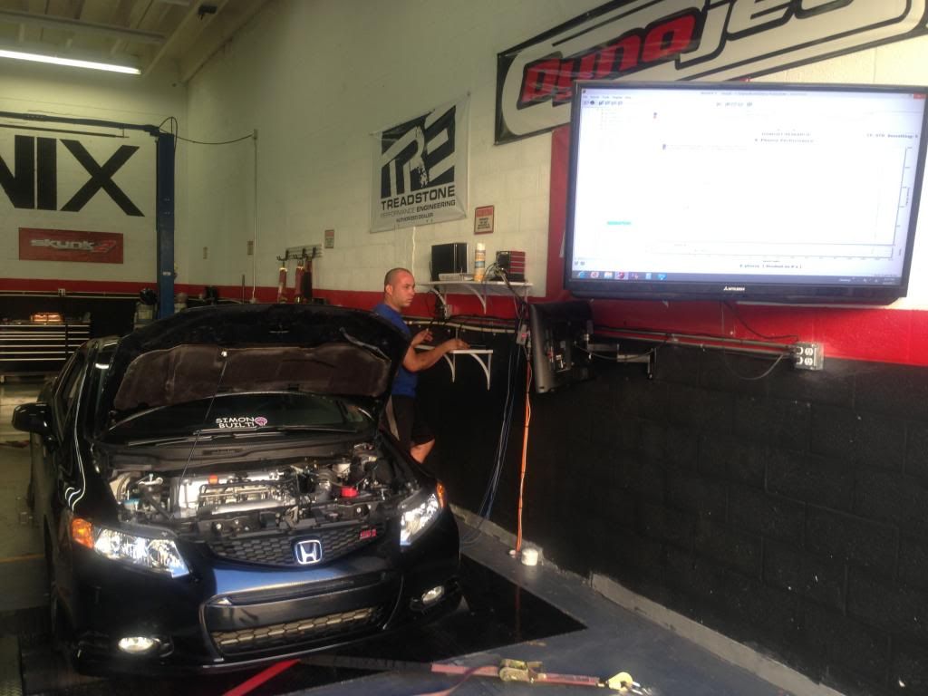

strapped down and ready to tune.
not much here,just an RBC.

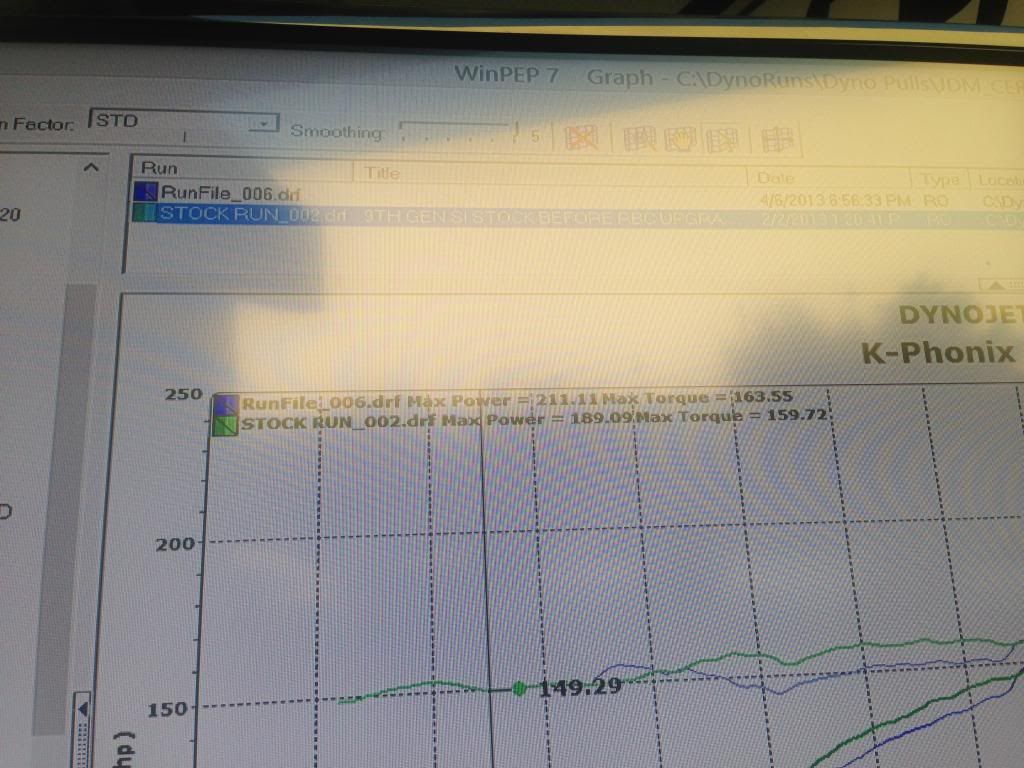

stock baseline made 189whp 159tq from 211whp 163tq on STD setting a 22whp gain!....not bad for having full stock exhaust.

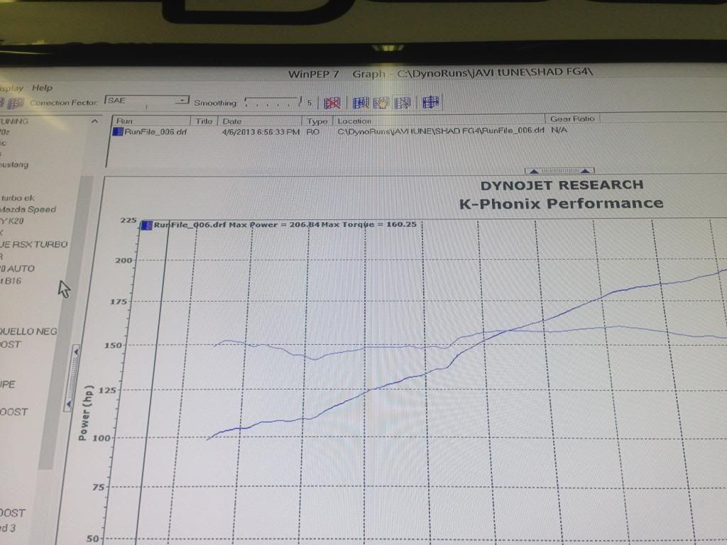

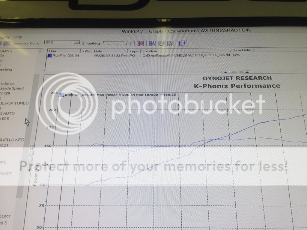

and this is on SAE setting
