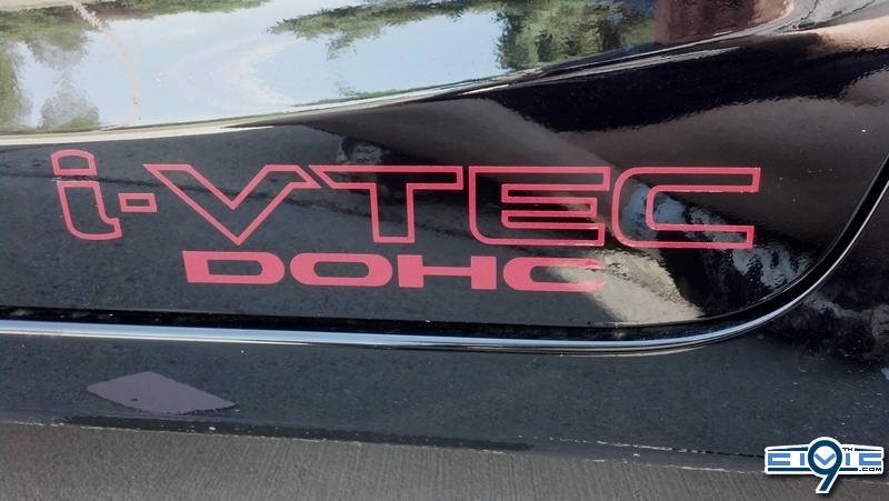

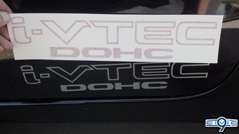

this is my first DIY...
1. make sure that the sticker is what you want

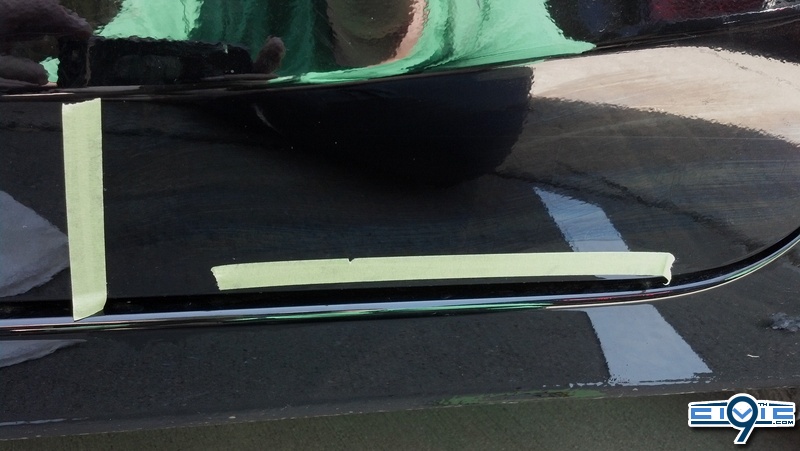

2. mark the old sticker with tape so you know where to put it, then peel off old sticker (it works better if you have nails, my wife helped)
3. use goo-gone or something to get rid of the old sticker.
4. put lots and lots of soapy water in the area to move the sticker around
5. peel off back of sticker
6. apply more soapy water
7. place sticker and get in spot you want
8. roll excess water out
9. peel off tape on front of sticker very carefully
10. Enjoy!
thanks for looking!

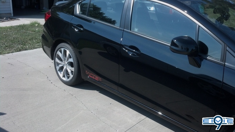

I did the same on my TW coupe. I think the red looks good with the red Si emblems, and eventually I plan to get red H emblem replacements.
