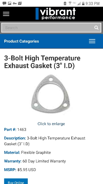

Anyone ran the skunk2 catless DP with stock catback? If so what size gasket did you get for the DP-Catback flanges? Heard stock catback flange is 2.3” but the only gasket I found in that size is a 2-bolt.
Anyone got specs on their gasket? I bought my DP 2nd hand for a pretty good price. Submitted a question to S2 waiting for a answer back in the meantimeIt’ll bolt up the stock exhaust, but they also provide a gasket. You can see it on the skunk2 site
Sorry I forgot to post about this, contacted skunk2 to get the gasket they send when you order the DP. It’s a 70mm but the holes for bolts are oblong to allow for some wiggle room. It’s a phone order part only and the part number is 913-99-0003 for anyone who is ever searching.Should just be a 3" 3 bolt gasket
