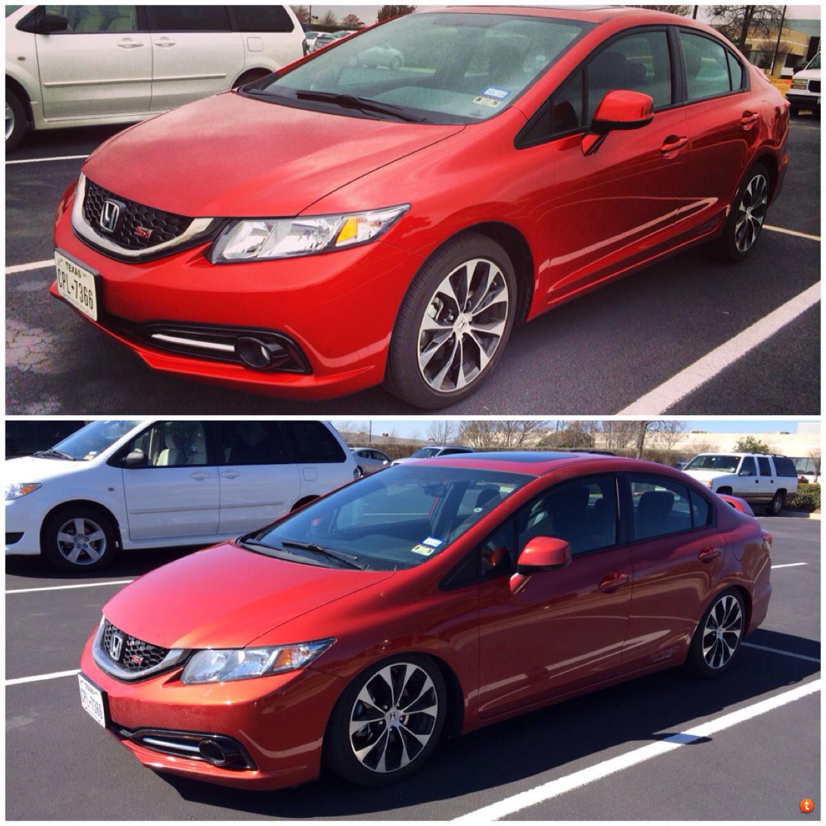

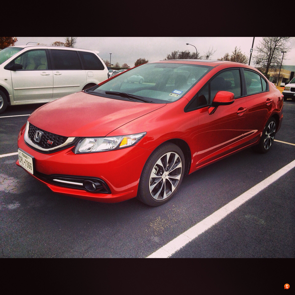

This picture is how the car looks stock as of now
And here is what I'm going for, I realize the ride will be much worse but oh well, and I'm not worried about having to drive much slower. This is what I'm going for and just wondering what all will be needed. Coilovers and Camber Kit but not positive about anything else, would I need both a front and rear Camber Kit?

Based on that 2nd pic you posted, you're going to be busting oil pans. Papy has gone through 3 on his ride.

You'll only bust your oil pan if you drive like a tard...there are plenty of 9ths that are low/slammed/dumbped (whatever you want to call it) and haven't had any problems. The ones that bust their pan were either driving dumb and/or not paying attention to the road, so don't let that scare you :)
There is a slammed 9th Si in my town that hasn't had any issues, and our roads here are like driving on ground zero. Spring rates do affect the ride some, but most companies and manufacturers will put the correct spring rates on their products to keep a comfortable drive. I'm on D2s and when I drop the car, I go really low and the ride is actually better slammed than it is now raised for the winter. Also, take in account your dampening system also; you have up to 36 dampening adjustments that offer aid in your ride comfort from soft to stiff.

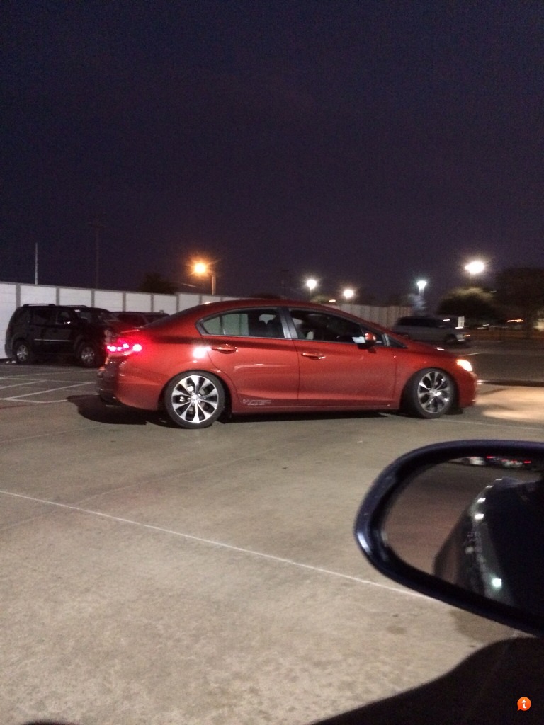

yeah, you've gone low, but you never went this low right?
This is what papy was at & it's not far off from the pic he's showing in the 1st post. That's what... maybe an inch of clearance?
I've honestly never measured, but I did have to take my front sway bar out to drive because it was scraping everywhere lol But I've only gone "low" once and that was for the limbo contest, which my car was scraping its guts, but it was worth it
But on that note...he might have been that low, but you should have seen the man hole cover he hit...Helen Keller could have seen that...it was avoidable

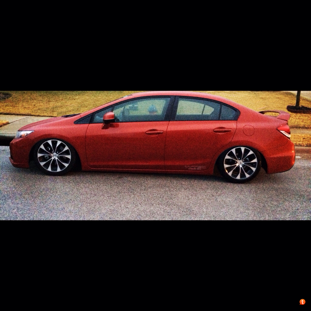

So just to update, I went with D2 Racing coilovers (installed 2 days ago) and love the look so far. I plan on going lower eventually but I think I will have to remove the plastic fender liner as it seems to rub the tire right now on sharp turns and possible get some smaller tires as I'm on the stock tires currently (215/45/17).
Yeah I still have my fender loner intact and I never rub at all....I'm also running 205/40 tires. You can run camber up front if you set your plates up top just right and you won't have to worry about rubbing. I've slammed mine on it's nuts for a limbo contest and still never rubbed, just the subframe scrapes everywhere.
You should be fine on the D2 with no rubbing if you dial everything correctly..I rock the d2 coils also
