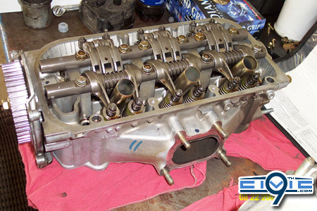

exhaust manifold = downpipe on the si. The exhaust is cast into the head. It's a single port coming off the head on the Si. This isn't the Si head, but it looks essentially the same with the single exhaust port like this below versus a standard 4 port header.
