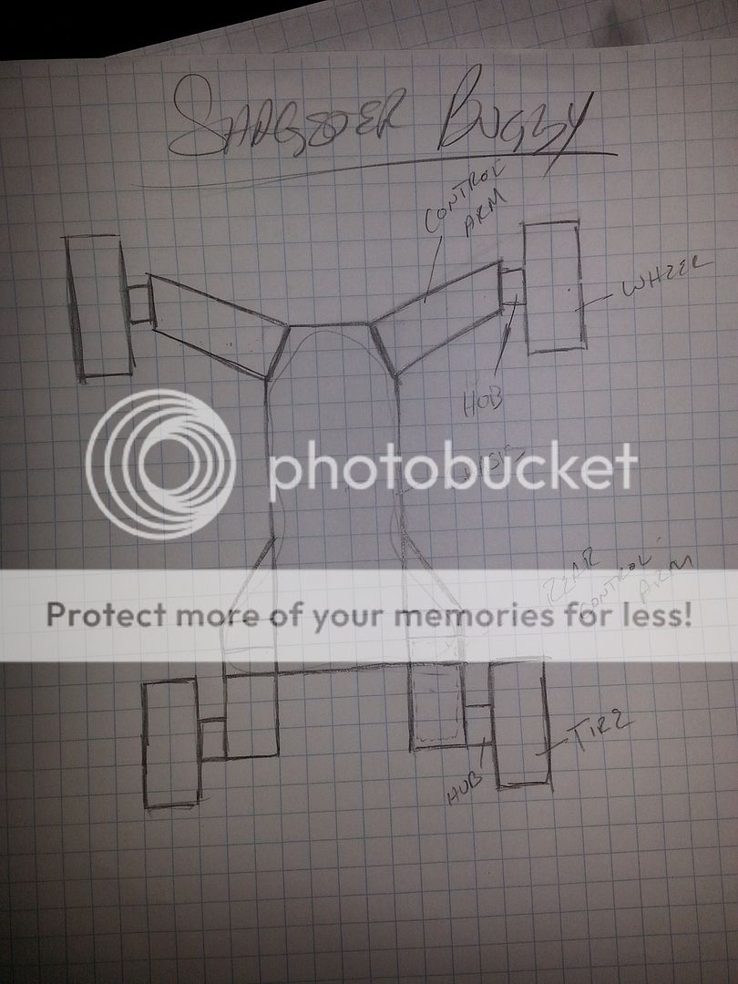

Alright! So I've had this idea for several years now and I feel now is the time to start. I don't post on my "main" car build thread as I've been debating to mod it but I believe I have decided to just do more cosmetic mods on the SI till warranty is over and try to focus on this project I've had for awhile. It's nothing new but would enjoy others to join me as I figure out, design, fail and succeed in making....a street bike powered sandrail/dunebuggy...!!!!
I live 2 miles from 2 woods play areas, owned a jeep grand cherokee and loved every minute of beating it up. Turned a $10k vehicle into a 1k$ vehicle in 2 years but had ball. I've wanted a toy and an aspiring engineer so this feels like a good stepping stone to prove myself.
This will start off slow as I am budget building but trying to do right. First step is finding what engine and trans I want to use (open to suggestions) that are cheap but modifiable. Then going to build the "rectangle" frame / unibody, long arms / suspension, etc.
Trying to do this all self / custom so this could be interesting. I will try to video the progress to help keep anyone interested in being entertained lol

I'm in to see how this goes. Shouldn't be hard for you to find and engine off a wrecked bike for cheap.
Yea there's actually an ebay distributor out of daytona that has 1k's of motors and parts. I live about an hour south so I could easily waive and shipping charges. Trying to find something under $500, think that's a fair number to get something decent motor/trans wise.
Debating on a square stance vs "reverse" staggered design (what's showed) but this is the bare bones skeleton blueprint of what I'm thinking about.
