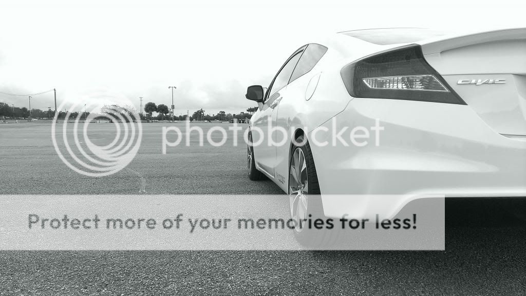

I got 20mm all around for $59 a pair shipped. here's how they look:
camber specs there were roughly -.6 front, -1.2 rear and its quite flush.
I have since added a touch more camber all around, and I'm lovin it.
Is this with out a camber kit!? Im looking to do h&r spring and 20mm on rear...but i dont think ill need a camber kit!?
I installed camber correction on all 4 corners to be able to adjust it how I wanted. natural camber in the rear was -2.3 and almost none in the front. in that picture I adjusted camber to around -0.6 front -1.6 rear
