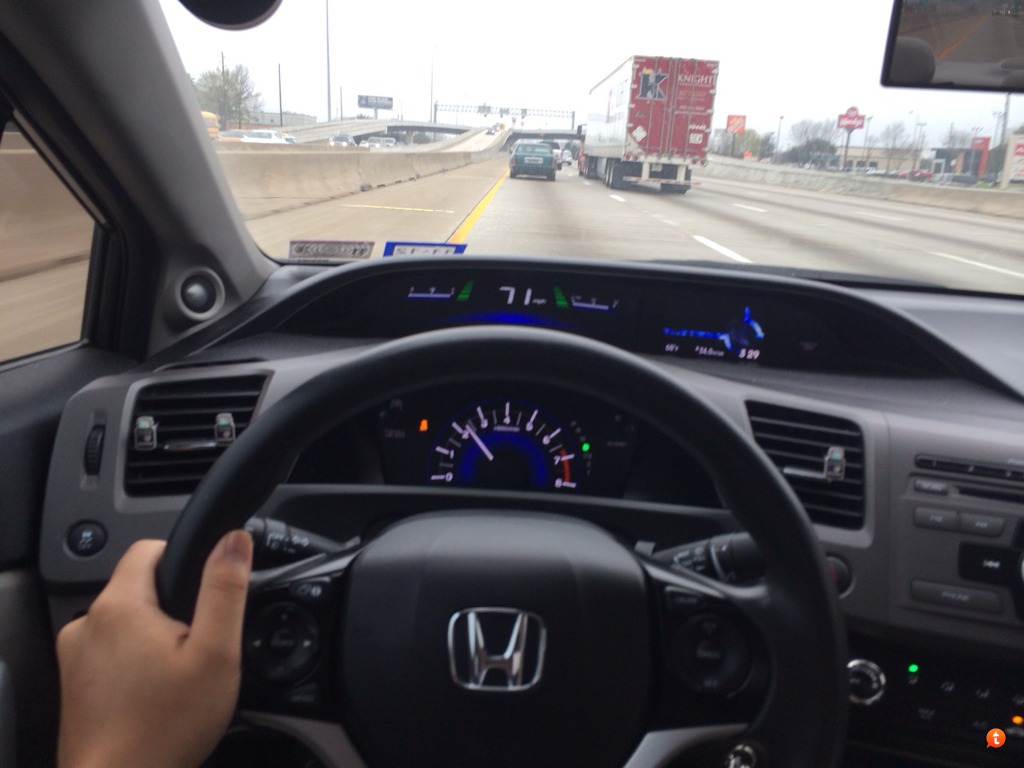

Yeah, I have a couple of weird spots in my mileage/rpm/speed as well. It seems like from 63-67 it doesn't move and then from 71-76 the same again. Right in between just kills it. On all highway trips, from KY back to NY, I get just under 40mpg doing 75/76 with the cruise control. Running at 55 in the boring parts seems to drop it right down to near 30 but 57/58 is around 35/37. The 65-67mph don't get a ticket range seems to hover in the 36-ish mpgs.
2500 seems to be a sweet spot as does 1750 rpms.
