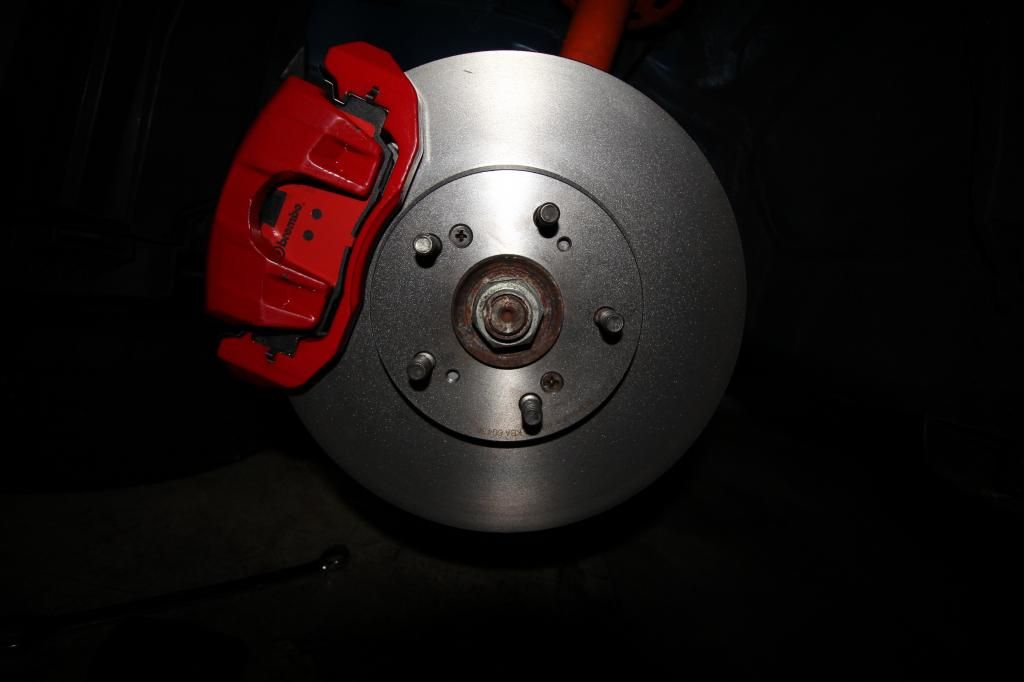

These were/are my brake setups:
-(past) EBC Reds on stock rotors with ATE Super Blue: The EBC Reds were so squeaky loud during the cold weather. They were also not that responsive since they needed to warm up. At ~20k miles, I checked the condition of the brake pads. They were cracking and no longer usable. I mailed the broken parts to EBC for further checks.
EBC Reds = bad for winter and bad quality. Dust level = 8/10
-(past) Stoptech Pads on Centric Blank Rotors with ATE Super Blue: This is a terrible setup. The squeaks were beyond belief. I had to regrease the pads at least 3-4 times, but that did not reduce the brake squeal. The stopping power was there, but the Stoptechs are not worth it for daily driving. The amount of dust it gives is much worse than the EBC Reds.
Stoptech Pads + Centric Blanks = huge thumb down. Dust level = over 9000.
-(Current) TSX Front calipers/Brembo rotors/Brembo pads(no rears yet) with Motul RBF600: Well, this setup is still on it's break-in period. The outside break-in coating from the rotors are almost completely gone. I really like this setup. It is very quiet and has much more bite compared to my previous setups. I really can't compare this setup to my previous ones since I added a bunch of additional parts (Russell SS Lines). Plus, the calipers are bigger. I wouldn't be able to identify the brake dust level yet since I just washed my car yesterday. I'm still waiting for my rear rotors to arrive.
TSX Calipers + Brembo parts + Russell Lines = so far, so good. Dust level = ?

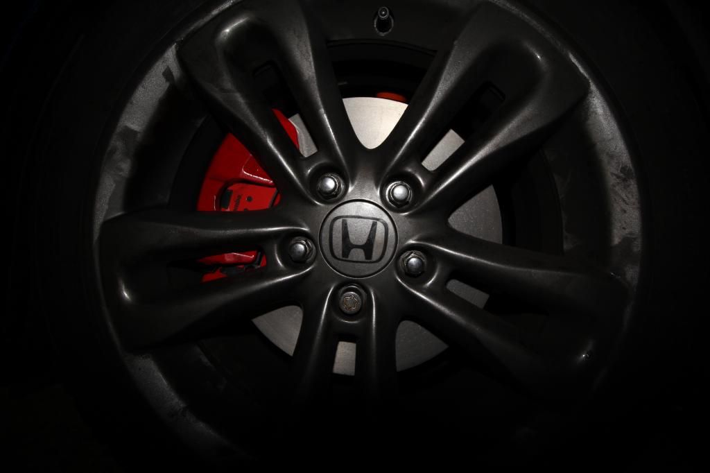

The TSX Calipers range from 2004-2010. The calipers (and pistons) are much larger than stock. Same with the rotors. I'm not sure how much larger they are in comparison to the 2012+ Sis though but they will surely clear the stock wheels. This is what they look like on my FG2:
The clearance between the stock wheel's spokes and the caliper is around 3mm.
You'll end up getting wheel spacers for mono block calipers.
