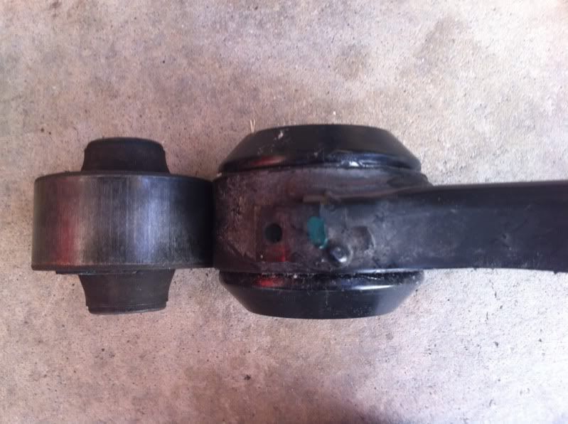

Tweaks: Progress 22mm rear sway, Moog endlinks, Energy Sway Bar Bushings
Serious Tweak: Upgraded Front Lower Control Arm Bushing. Basically a traction ball. I can tell you nothing about this.
Stock Part on Left & Upgrade on Right 16.3116
