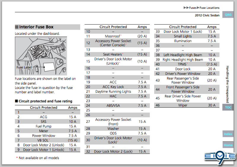

So the front cigarette lighter broke. It doesn't accept any plug or power anything. What fuse should I probably be looking at to replace? Should I just drive it to the dealer? Help ME :) ?
Take it to the dealer. They will deal with that. It shouldn't cost you a thing.
2012 Civic cigarette lighter fuse - looks to be #27
accessory power front -15 amps
There should be one in the top cover of the fuse box located in the engine bay.
I haven't had a cover open to see if there is a spare fuse provided or not.
