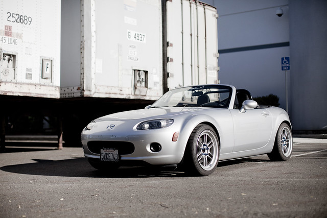

Hey, so I've had 17x9 RPF1s before on my previous car with a 245/40/17. I've been looking around on here and noticed that people aren't running anything larger than a 215 on a 9", which is cool if you're into that kinda stuff, but I anticipate seeing track time with this car like my previous cars. I'm just not into hellaflush, poke, or stance.
I've been looking around at the RPF1s again as an option for my sedan. I can roll fenders, that's no problem, but I don't want the wheel/tire to be sticking out past the fender. Is it possible to run a 245/40/17 with this arrangement, or should I go with 235/40's instead? There aren't much as far as tires are concerned in the 235's, but I think my concern is whether or not a 9" wide wheel will have issues rubbing on the inside.
My previous car as a reference --
