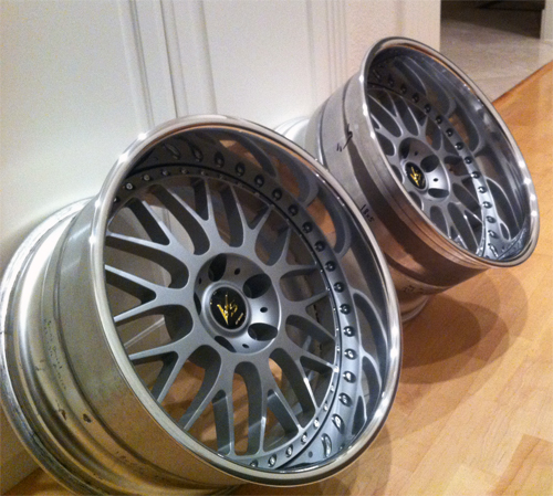

hey guys so a friend of mine is selling me his wheels. The wheels are Miro 368.
im just wondering if someone here can help me if this wheels would fit.
the wheels specs is 18x10 offset +18
its running on 235/40/18 tires
and also ill be installing a 8th gen lowering spring skunk 2
(Front/Rear) 2.25"/2.00"
would anybody think ill have a big problem? lol

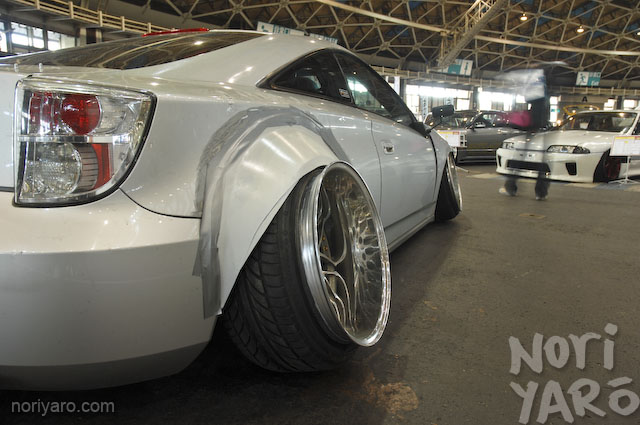

you know what would be fun... 18x10 +7! :D
would be the same inside clearance as stock just poke the **** out! like EXTEND an extra 76mm Would be boss! Cut your fenders ever 3" and then roll them to ****, then bondo and sand and paint and do all dat body work! Would be BOSSSSSSS!!
