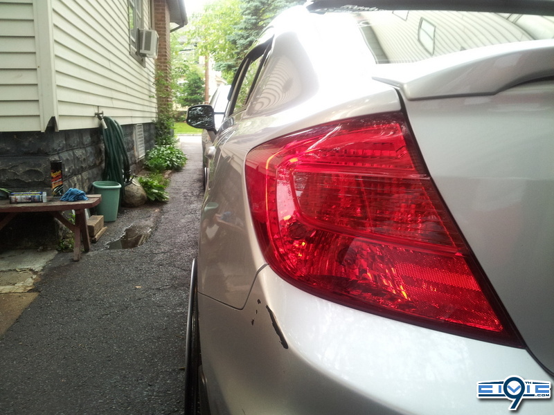

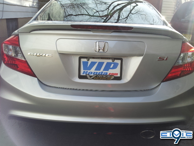

BEFORE:

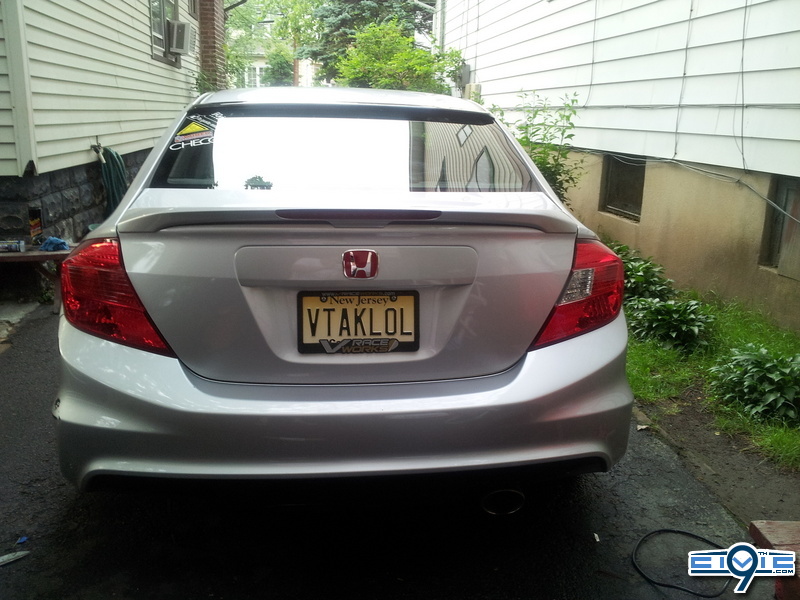

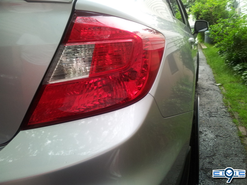

After:
*i wasn't sure if i wanted the whole thing tinted red or partially red.
therefor i left the right side half tinted.
i think it gave it a EDM fog light look?
feedback for having the whole things tinted red or half tinted is much appreciated.
