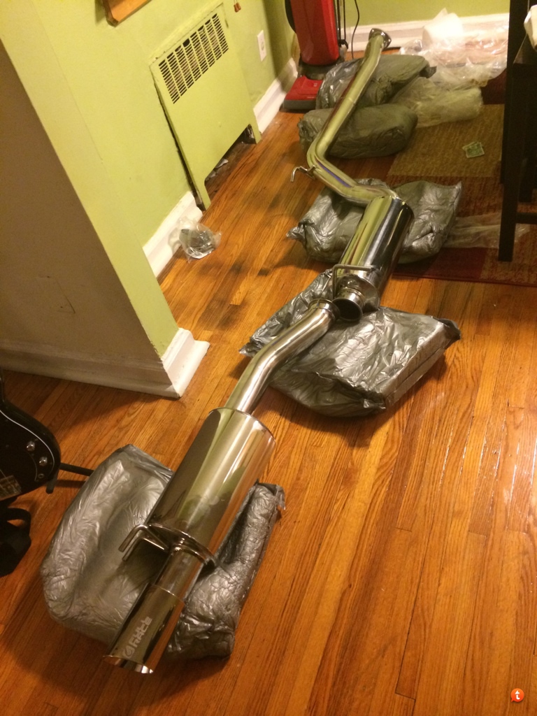

Havent installed my mount yet or exhaust hangers.. Gonna do that when i install this baby.. Movin on up to the 3"
