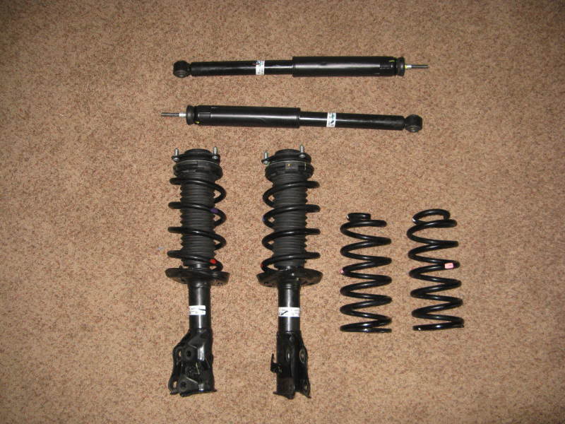

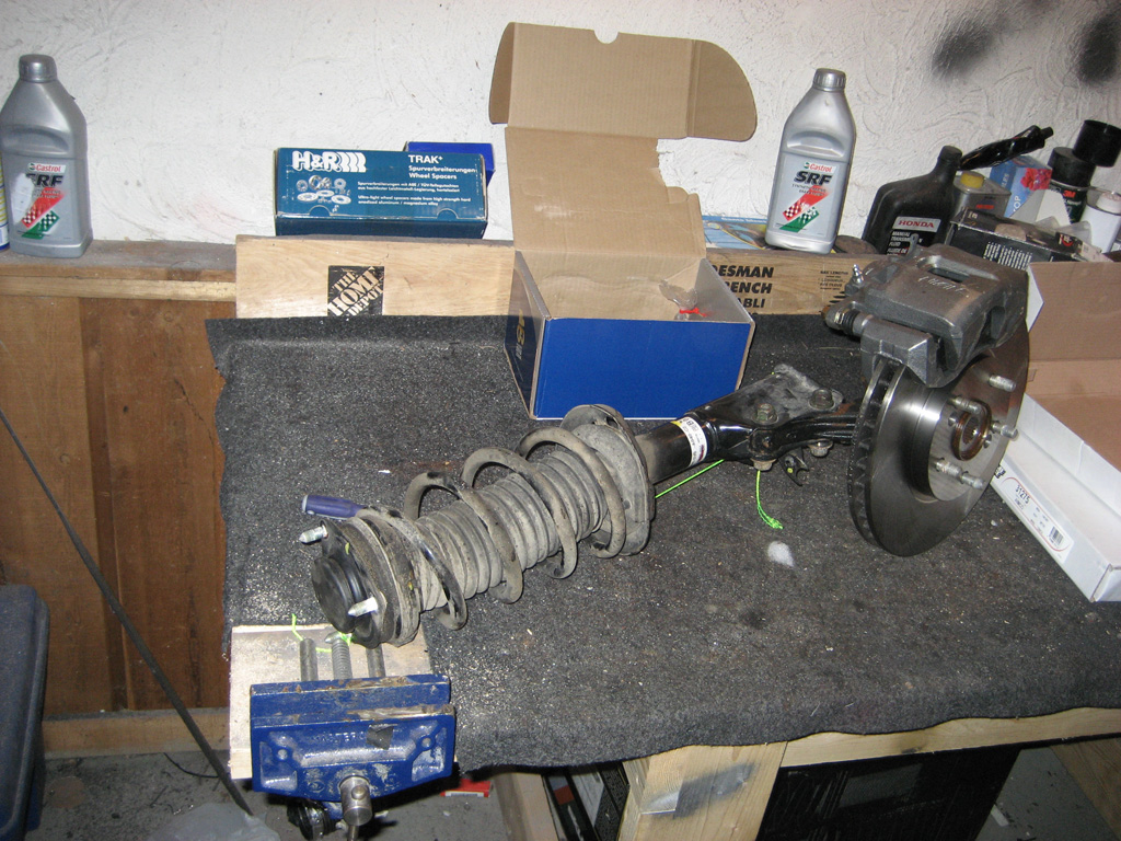

that passenger side strut you posted has a spring wound in the same direction as this illustration of the driver's side on the 9th Civic, which is what I noticed when I installed it. I guess no one else installing 8th gen springs noticed that before. In theory, as long as the spring seats are the same from right to left, I could just swap the dust covers and springs right to left and have the correct fitment with 8th gen springs.
If I have time tomorrow, I'll double check on my own car and try to post pics tomorrow to confirm.
