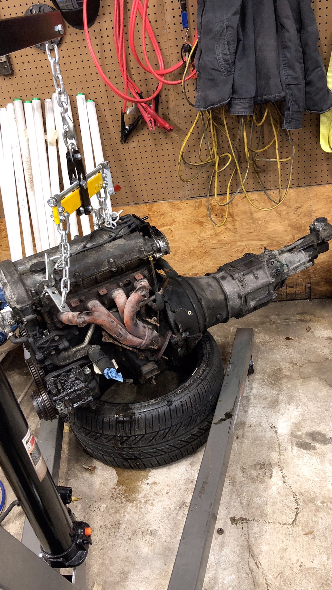

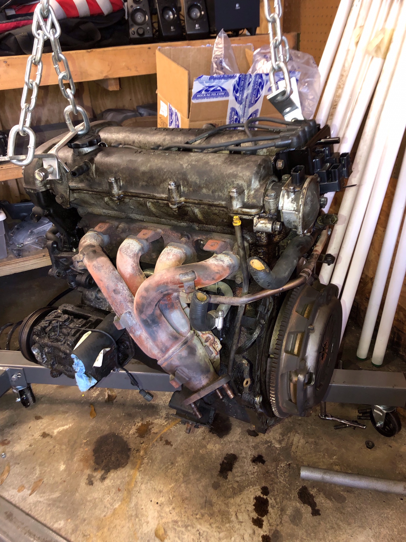

    1/23/19:
    Today marked the start of the tear-down. Had enough time before work to remove the Radiator, intake, cruise control, fuel rail and injectors. Next up is going to be the manifolds followed by the cylinder head itself.

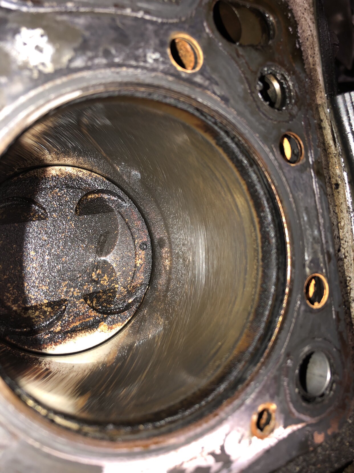

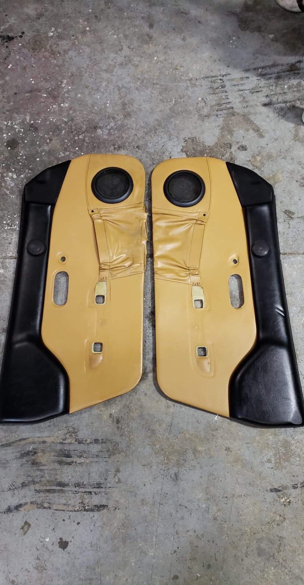

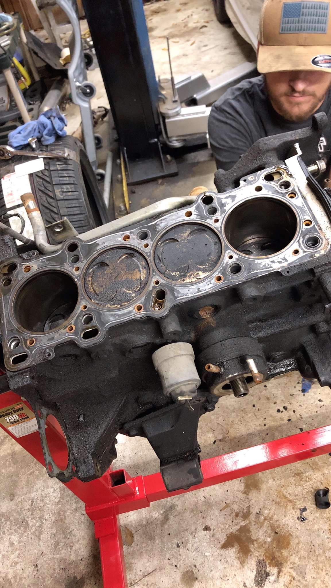

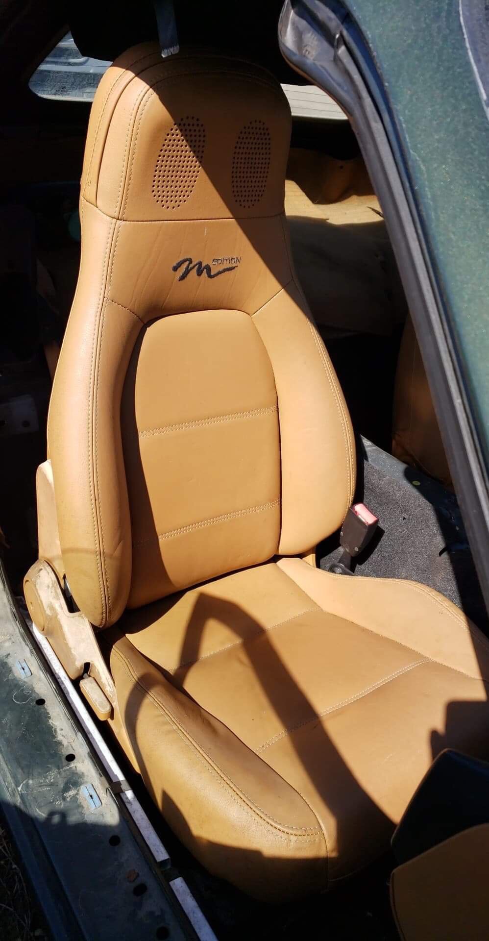

    A lot has happened in the past couple weeks! I recently picked up a MINT set of 97 M Edition seats with tan door cards, as well as black interior carpet. I now have everything I need to restore the interior.
    As for the engine, the other day I removed the head and was genuinely surprised at the condition of the pistons and cylinder walls. Some time this month I’ll be completely disassembling the head for cleaning and resurfacing. I’ve now got all the parts I need to bring the engine back to life, just fighting with my work and school schedule!
