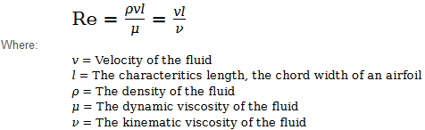

In adding to my ever-growing stock of Pennzoil 5-quart jugs, I lucked onto this 10w-30 Ultra Platinum in the 1 QT bottles for just $1.00 more per quart. Deal. So instead of $5.00+ per quart, it's just $6.21/qt -- but will be shipped 6/18/19. That's a fabulous price for the singles; it's more often $10 - $12/qt. And using the 10w instead of a 5w is nothing to worry about. Slightly less fuel efficient at high RPM's that's all. [GEEK NOTE -- that's because of the internal fluid friction as derived by the Reynolds Equation]

GEEKS ONLY SECTION:
General idea behind the Reynold's Equation:
Full Calculus:
Quiz in the morning guys... haha!
