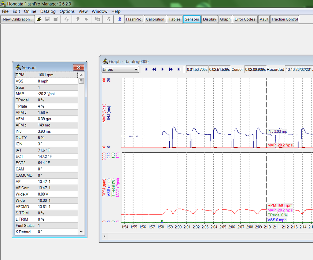

I loaded the throttle flow vs. opening values. It started up and idled well, but as soon as I gave it a tiny bit of gas to back out of the garage, it began idle hunting again. :sadface::sadface::sadface:
Sorry to hear the values did not work for your car, but like mentioned in an earlier post these are just a general starting point. One thing to note, you still need to complete the idle relearn procedure after reflashing the ECU. It's hard for us to know for sure but it seems as though the car was just starting to warm up for the first time.
In any case, make sure you follow the idle relearn procedure and fine tune the values to work with your car.

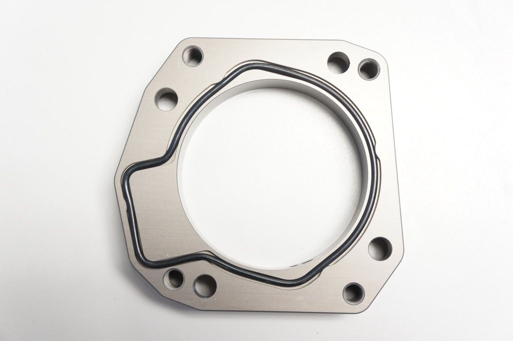

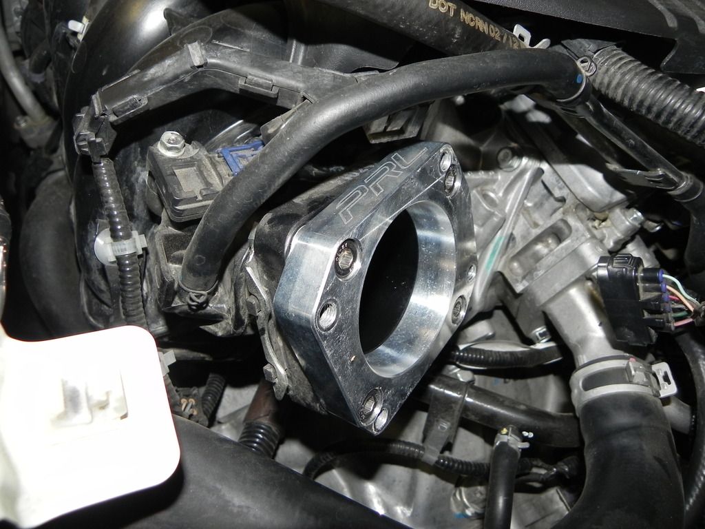

I've been pondering whether or not the PRL ZDX adapter is the issue. I called and spoke to Spencer, and he said there is a version 1 and version 2 of their adapter. Version one is simply a slab of aluminum that they send a paper gasket to mash between the TB and adapter. Version 2 has a built in rubber O-ring that I think is necessary to get a good seal.
Version 1
Version 2
