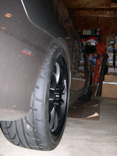

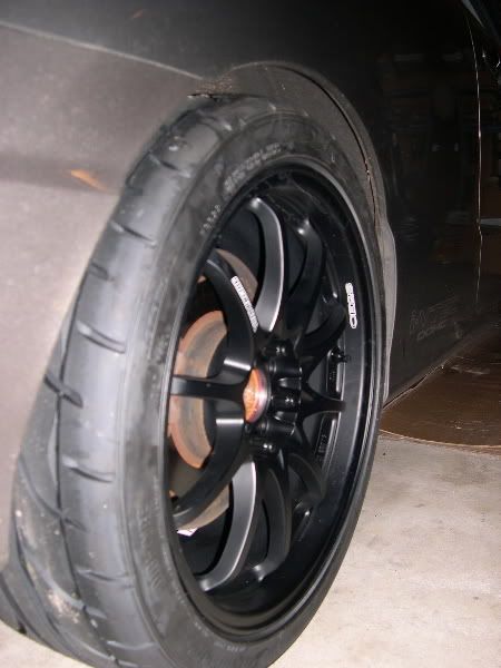

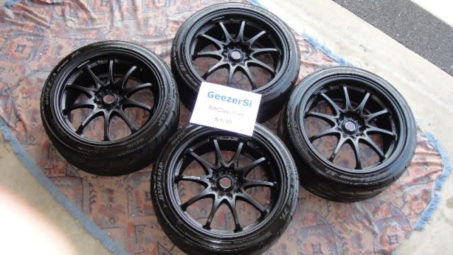

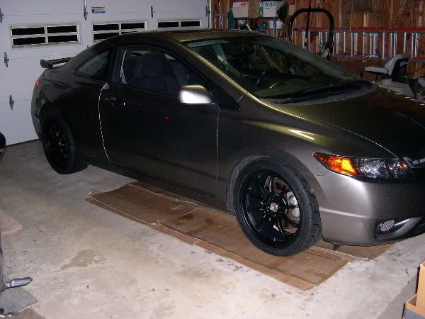

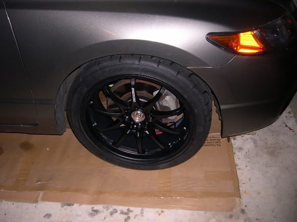

The first step in figuring out what wheels you want to put on your car is figuring out what you want in your wheel/tire combination and how that relates to what you want out of your car. I'll give what I want out of my car as an example; I want a fun daily driver that handles better than stock, is more efficient than stock, and looks better than stock without doing any major body modifications (actually, for this car I don't want to do ANY body modifications at all). I actually have a name for this styling/modifying theme...I call it OEM+ (totally irrelevant to this rant, but hey, it is a rant). That being said, what I want out of my wheel/tire combo is a light weight, high performance, attractive, flush fitment setup. I ended up choosing WedsSport TC105N in 17x8.5 +32. Notice I am not just telling you I'm getting 17" TC105N's. The width and offset are just as (if not more) important as the diameter. Figuring out your budget for this will be the LAST STEP in the process. The easiest thing to figure out first is how you want it to look. That being said, the second step is to figure out the fitment of the wheels you're looking for.

Once your fitment is decided upon, you should then start looking for wheels that closely match the diameter, width, and offset that you have found looks the best for what you have in mind; whether that look be just a little cooler than stock, or as close to a track car as you can look on the street, or a super stanced out Canibeat feature car, or maybe some compromise of everything. The look you're going for may be limited by the overall picture you're looking to achieve, so keep that in mind. You may not want to roll your fenders, so this will affect how much width and what offset your wheel can have, how wide of a tire you can use, and how much negative camber you'll have to run in order to make everything fit without rubbing and/or damaging components.
After you have decided what style of wheel you want, you will then need to figure out what tire to use. This is just as important as you are putting together a package. One does not work properly without the other. The size of the tire and how it relates to the look, fitment and ride height (stance) of your wheel/tire/drop combo may be the most important thing to you, or maybe it's the handling performance, or you could be like me and you want the best possible compromise between comfort, road noise, tire life, stance and handling. As you look into what you want out of the overall setup, your decision may change in tire size and wheel width/offset while you compromise with yourself trying to figure out what is the best all-around option for everything.
Now that you've decided on what you want out of the look and performance of your wheel/tire combination, it's time to look at cost. For me, I found that $1500-$2000 (the wheels I ordered are ~$1780) is pretty reasonable for the wheels I want (if buying brand new. Used, knock a couple or three hundred dollars off), and decent tires cost anywhere between $500 and $700 for a set for the size I want (I'm getting Michelin Pilot Super Sports because they are AWESOME tires and they're worth every penny of their $700 price tag). I could spend a lot more or a lot less on stuff that may look a little cooler, may be a little more exclusive, or perform better in some areas and worse in others, but for what I want that is how much I would have to pay. That amount isn't too much, it's just how much it costs. I realize that, to some people, especially younger folks, that seems like an inordinate amount of money, especially I'm not saying, necessarily, that $2k is not a lot of money, but it's all about perspective. If what you want costs that much, don't settle for what you don't want for $500 just because you got to have it now rather than waiting a year and saving your money for what you really want. The feeling of having exactly what you want in a year is a million times more rewarding than having what you don't want right now.
